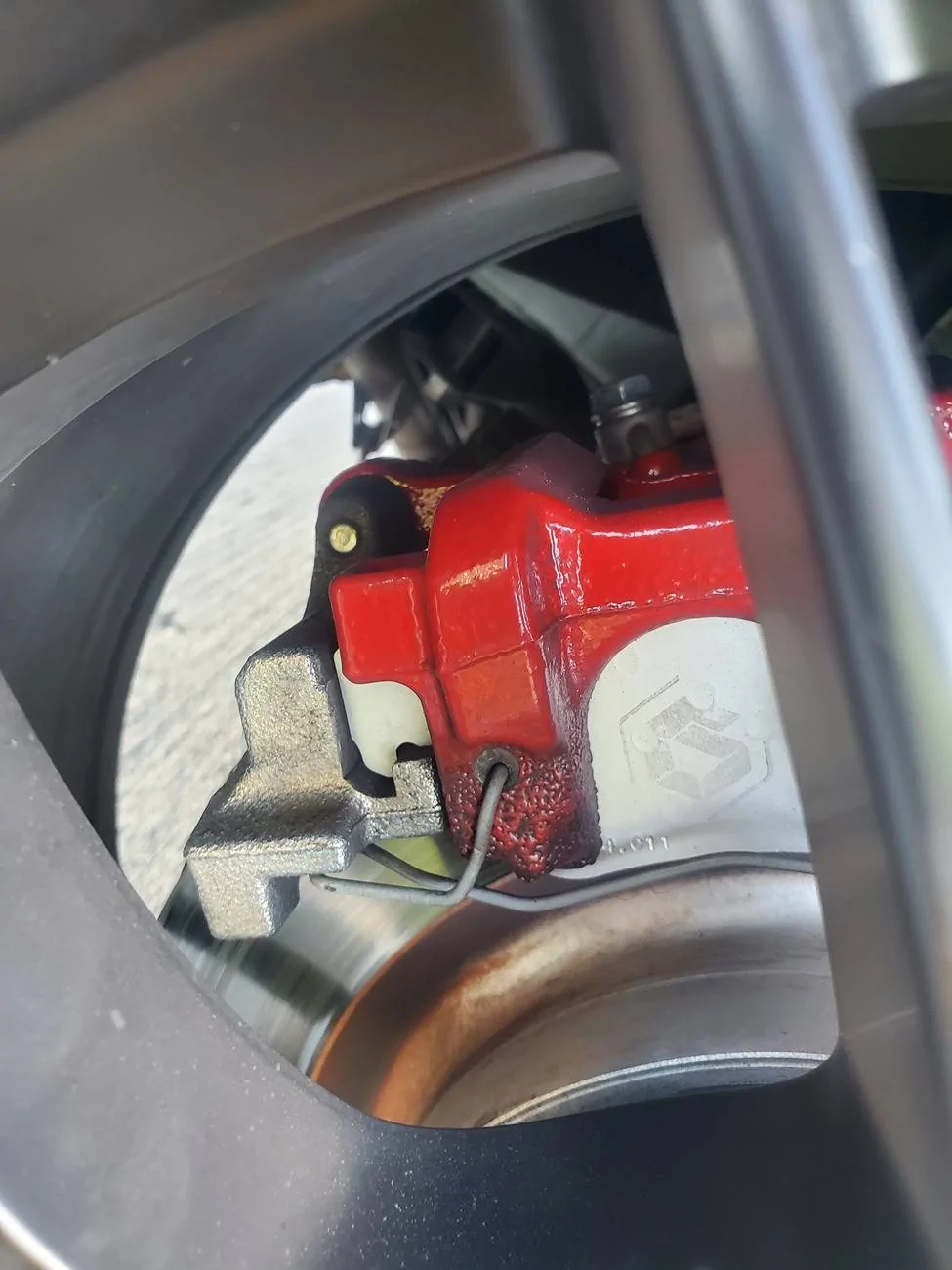

Anyone have their rear calipers look like it has bad acne after a track day?
Im honestly at a loss for what happened. Im guessing somehow brake fluid bled through my bleeder valve and go onto the caliper?
I didn't do a deep inspection of everything until after I got back.
I haven't touched my brakes for a whole month, and the only thing I did was add pads. I took a picture just a few days prior and it doesn't look like the calipers had pimples. Not sure whats going on.
I didn't have any decreased braking performance that was significant or noticeable either.

That definitely looks like brake fluid ate the paint. Remove and inspect!

I think that’s just blistered paint from heat. What kind of pads? I’ve found some pads conduct a lot more heat to the caliper than others. That’s why I won’t use G-loc any more.

Im using the CSG pads
I dont think its the brake fluid, although thats what I was thinking. My brake fluid MC is full and the bleeder valves are both tight and rubber is in tack.
Im on Day 2 at the track and still have had 0 issues with braking

Paint damage from high heat. What CSG pad are you running and what kind of fluid? Also, are you running TC off to disable the brake vectoring?

Which mode do you use when on the track?
C1XB - Front
C11 - Rear
TC doesn't turn off brake vectoring. Im doing +R long press TC OFF for VSA Off. So the brake vectoring is still there. I thought braje vectoring was good for the car because it rotates it right?
