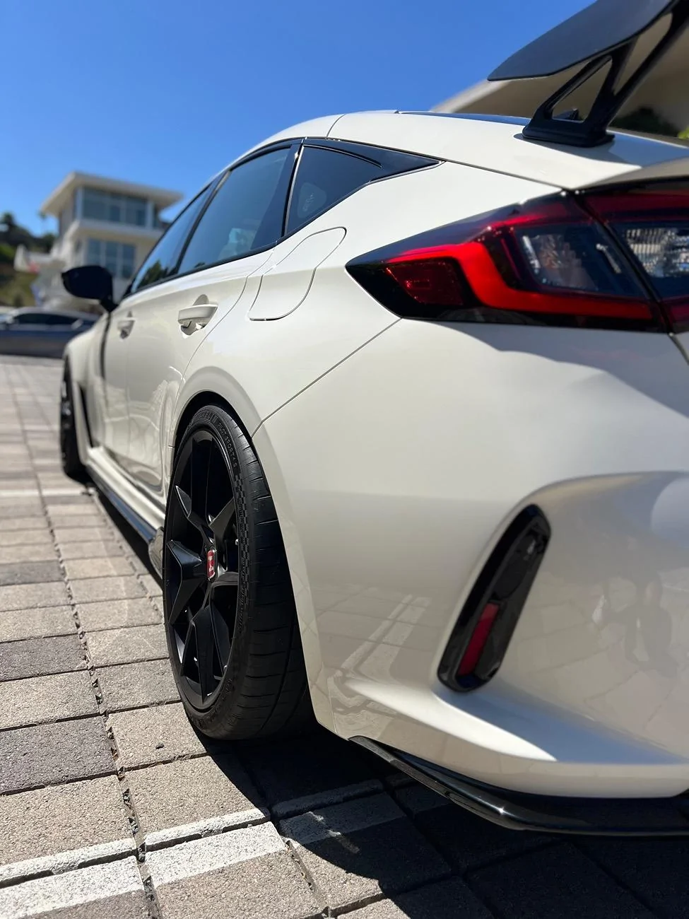

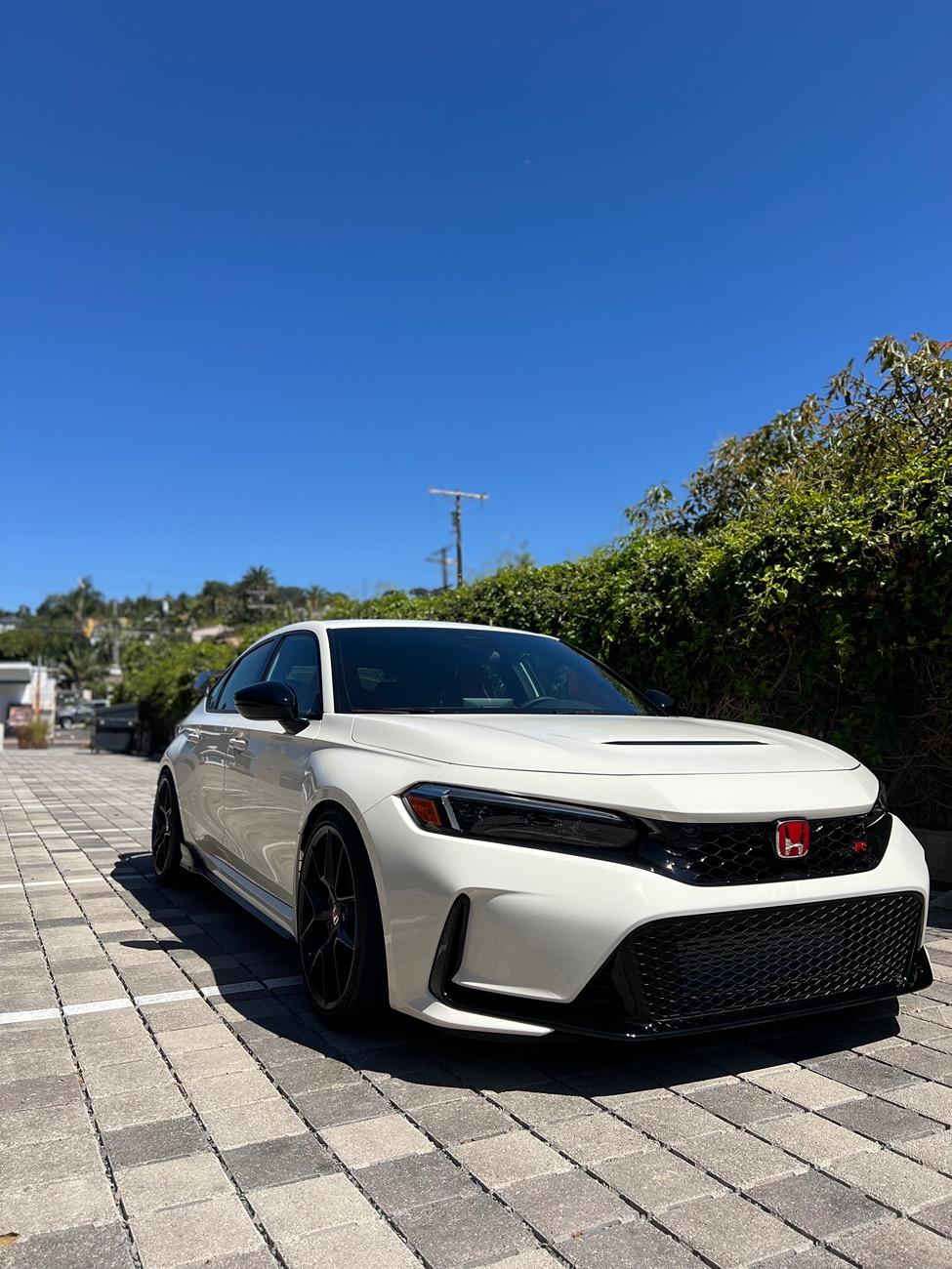

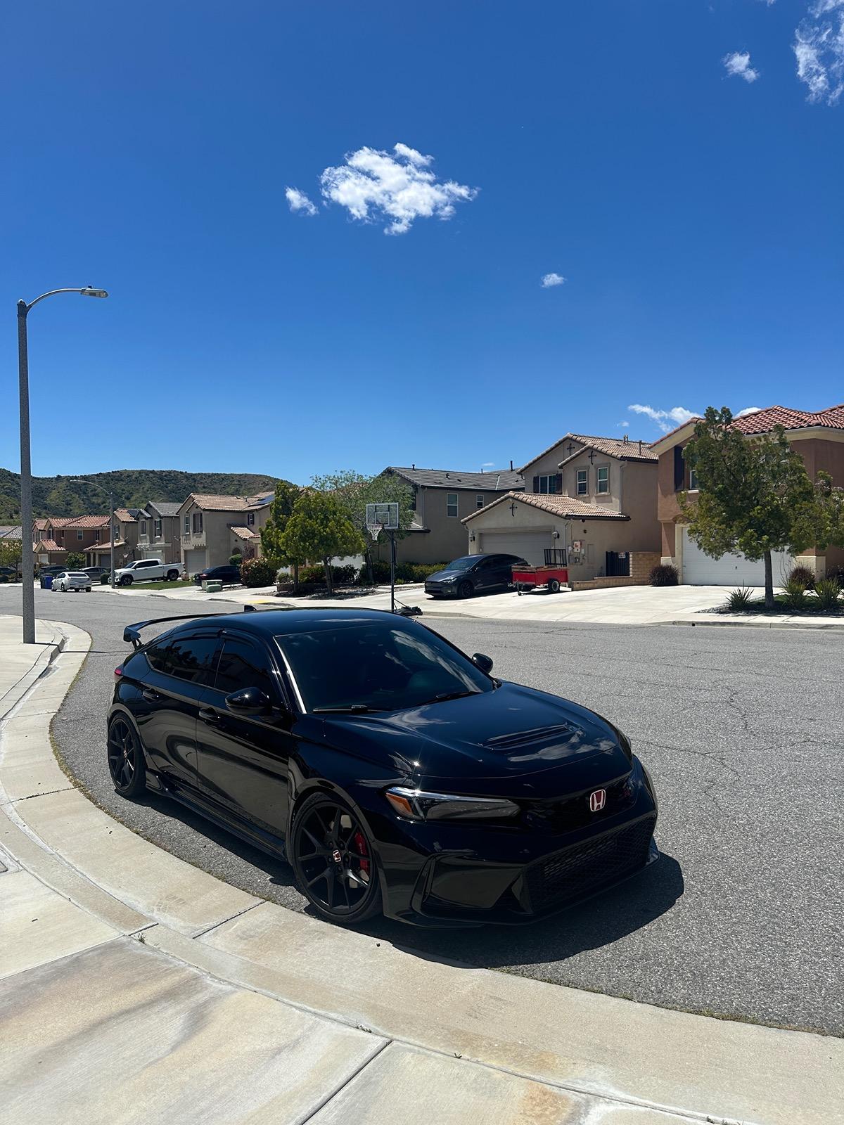

How does it ride?
First time going the springs route so it was all new to me. The first two weeks had me regretting cause it was super bouncy. Then basically after they settled it was night and day. The ride is very close to stock. On corners you can really feel how planted the car is.
Definitely recommend swift if your going the springs route and pair them with some spacers for that fitment.
1. Year and Model:
2023 Civic Type R
2. Wheels and Offset:
Front: 19x9.5 OEM Matte-Black Alloy, ET +60
Rear: 19x9.5 OEM Matte-Black Alloy, ET +60
3. Tire Brand and Size:
Front: Michelin Pilot Sport 4 S 265/30ZR-19 93Y XL
Rear: Michelin Pilot Sport 4 S 265/30ZR-19 93Y XL
4. Suspension:
Swift Springs
5. Wheel Spacer Brand, Type, and Size:
Front: BONOSS Forged Lightweight Plus AL6061-T6 20mm
Rear: BONOSS Forged Lightweight Plus AL6061-T6 25mm
6. Clearance (i.e., Does it rub? If so, when?)
Front: N/A
Rear: N/A
7. Wheel Studs
Front: Stock
Rear: Stock

Its a perfect look really. Do you notice a sharper turn in?

Ride looks good!
Did you cut the bump stops when you installed the swift springs?

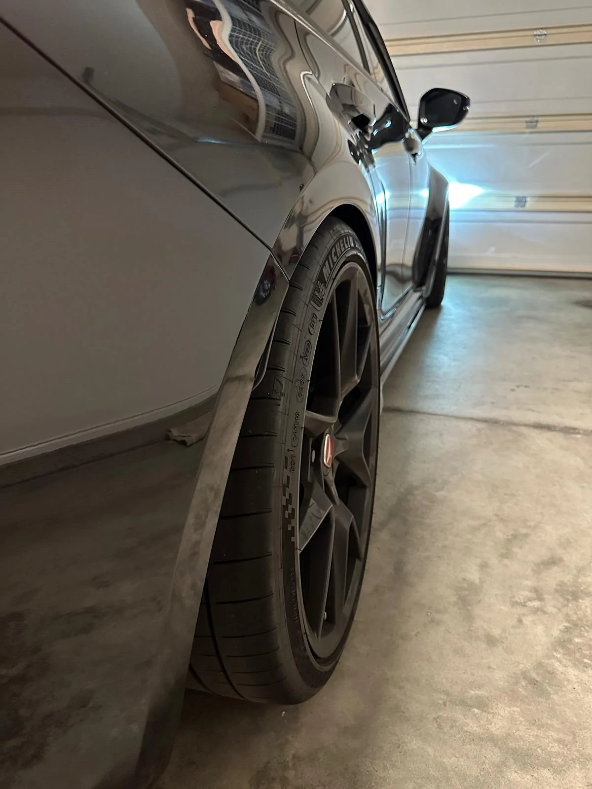

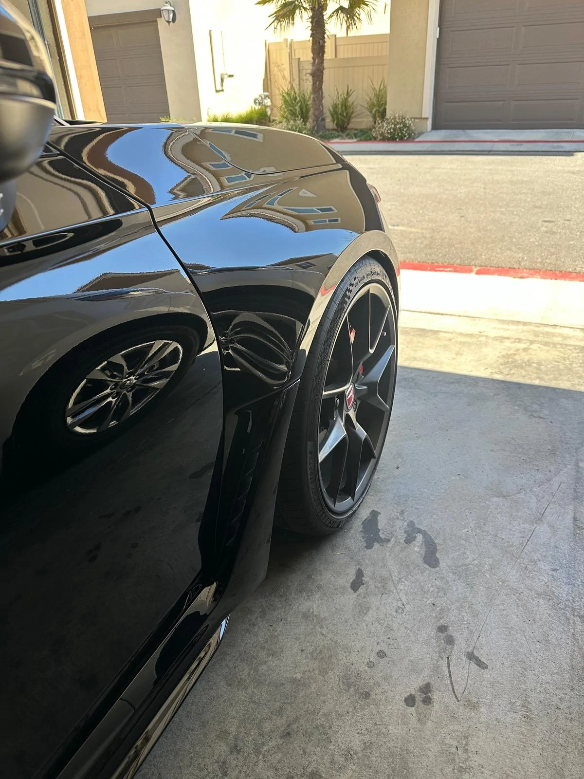

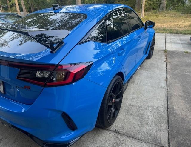

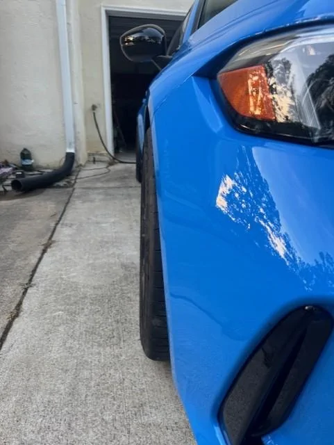

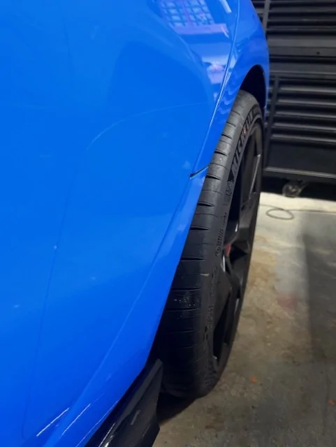

Freshly installed this afternoon. Debating if I should have went with 20mm on on all corners, or if the look will get better once I install the lowering springs. From the tire sidewall to front fender edge is 1/4" protrusion, rear is 5/16" protrusion using a level and tape measure. Still can't make up my mind if I should put 20mm on the rear or not.
1. Year and Model:
4. Suspension:
OEM
Front: N/A
Rear: N/A
7. Wheel Studs
Front: Stock
Rear: Stock

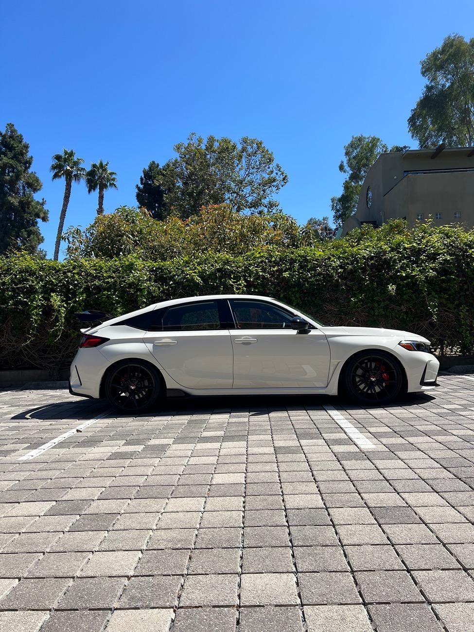

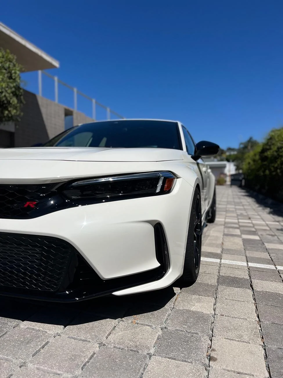

Hi there! This is my first post on this forum and I have to say that this thread has been very helpful. Just got my Championship White Type R a few months ago and currently have 3k miles on the odometer and the first things I’ve done already was install swift springs and spacers. So grateful to get a glimpse of what people are running and the outcome on my Civic is perfect! The Swift springs are on point with ride height and handling and the spacer choice pushes the OEM wheels out just perfectly WITH NO RUBBING!
Direct plug and play with NO NEED to modify a single thing.
1. Year and model:
2. Wheels/offset:
3. Tire size:
4. Suspension:
Swift Sport Springs Spec R for the FL5
5. Wheel Spacer Brand and Size:
Front: BONOSS 20mm
Rear: BONOSS 25mm
Front: N/A
Rear: N/A
7. Wheel Studs
Front: stock
Rear: stock
8. Insert photos

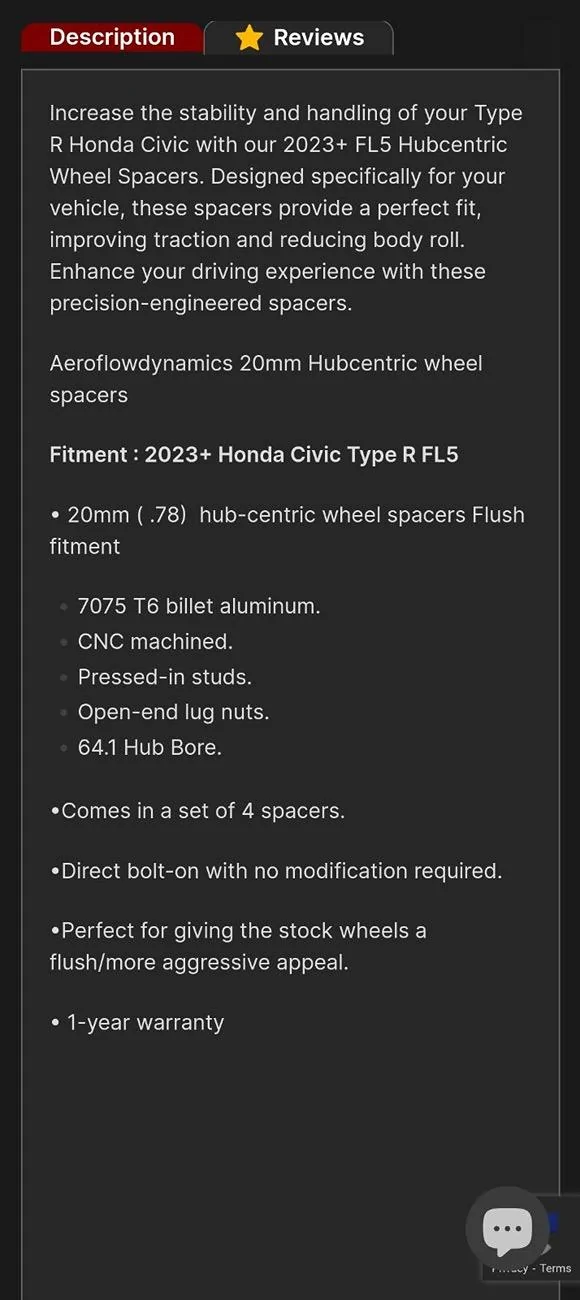

Just saw that Aeroflowdynamics released their own 20mm wheel spacers. Interested to see how they are.

That's too bad these come in a set of 4 spacers as you would have two purchase two sets if you didn't want to run a square set up.

True. But cheaper than the Bonoss overall. In my case I'm just gonna go for all 20mm. But from what I can see, these from Aeroflow seem pretty decent compared to the Bonoss correct? As far as material goes?
