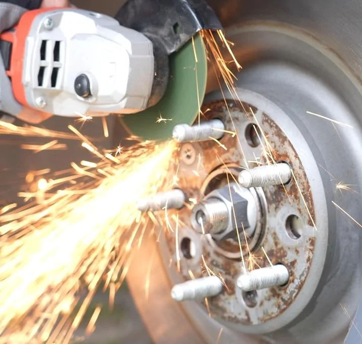

ordered a set of bonoss spacers from ebay. about 5 days ago, and they already delivered.. order 15mm they msged me saying that the 15mm may require me to cut the oem studs but seeing as everyone on the forum has no issue with the 15mm ones I went with them instead of the recommended 20mm from the seller.
I can personally attest that spacers ≤ 18mm do not require cutting the OEM studs. FYI - I'm running 15mm in the front and 18mm in the rear. A few others have reported they are running 20mm with no modifications necessary; however, I cannot personally confirm.
The hyper aggressive imagery they sent over (see below) had me concerned for a minute but I decided to just go for it:eek:. No issues whatsoever and no cutting required.
