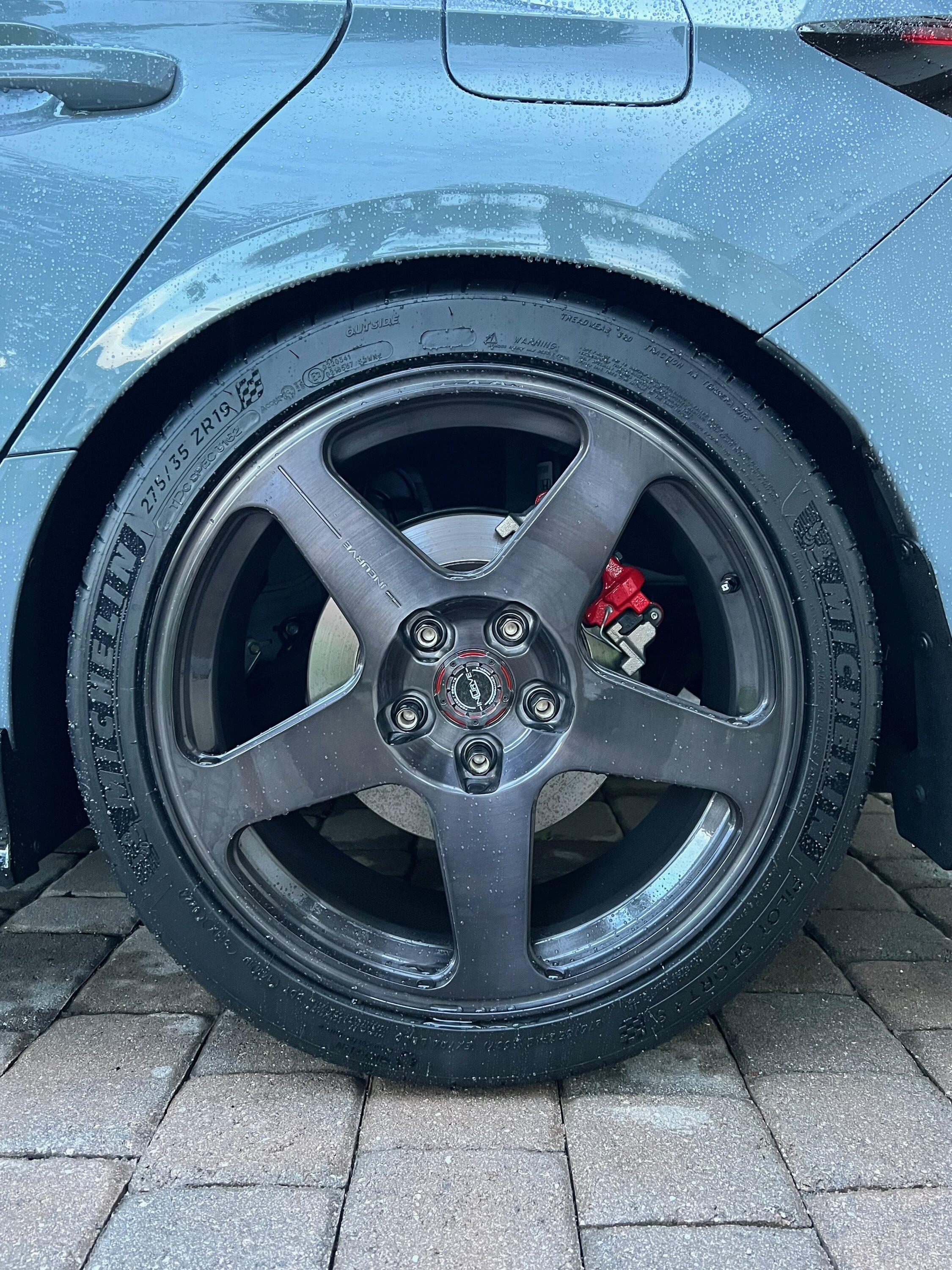

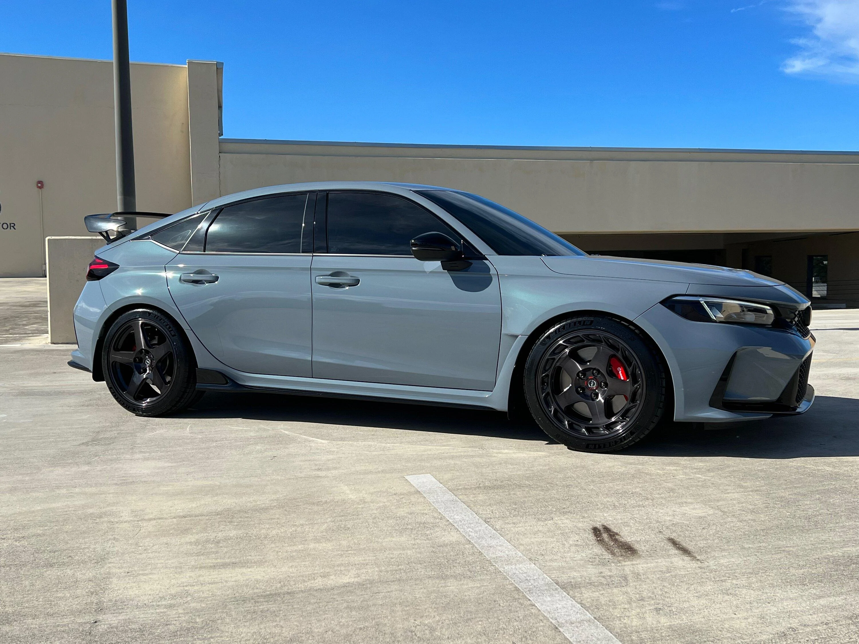

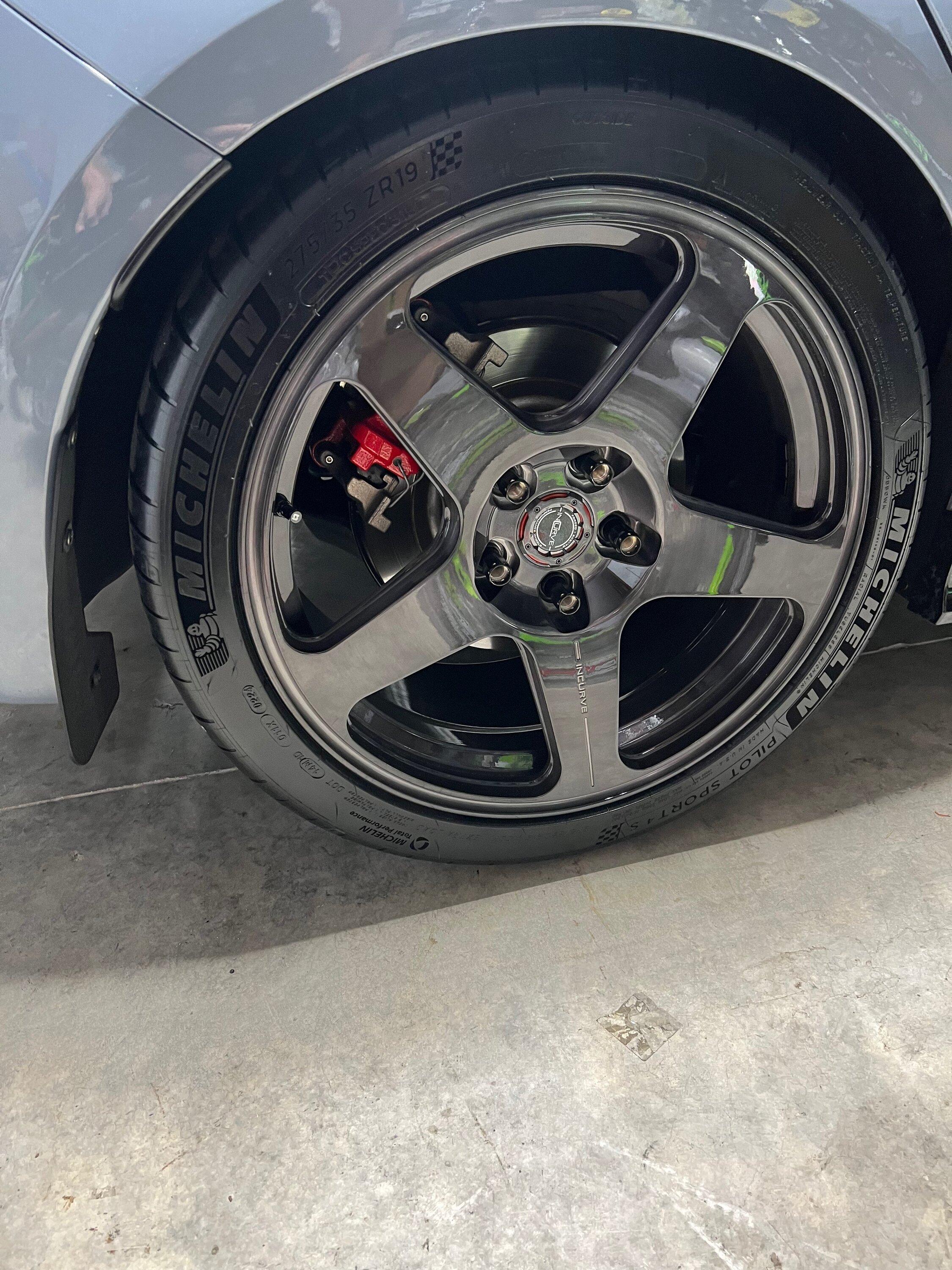

I posted this on Facebook, but didn't get any great feedback. I want to lower my car, but drive approximately 80 miles per day and don't want to ruin the ride or run in to rubbing issues. My car is currently on TALL tires and I love the fat sidewalls and comfort I get from the Cadillac specific TPC spec Michelin 4S with noise cancelling.
Wheel specs are 19x9.5 +45
Looks like a lot of people are commenting "Spoon" springs, but I have spoken to a handful of Spoon owners and they complain about the saggy look in the rear. I understand it is actually level from the jack-points, but I guess I care more about ride "quality" over just aesthetics. I think I can live with the "sag" if the ride is truly the best.
Sounds like a bunch of guys lowered on the H&R springs love the ride, but some wish it was lower, so I'm truly torn.
My tech said go Eibach or Spoon, but it sounds like those are the two brand he has the most on hand experience with.
Any feedback from those who have tried multiple spring setups is greatly appreciated. Planning on ordering my springs by Wednesday of next week.

Your tires are 5.1% taller than OEM 265/30/19. I don't think it is wise to go to any lowering springs.
Lowering springs would be the opposite of what you are trying to achieve in terms of comfort as well. Doesn't make sense to lower the car and have taller tires IMHO
