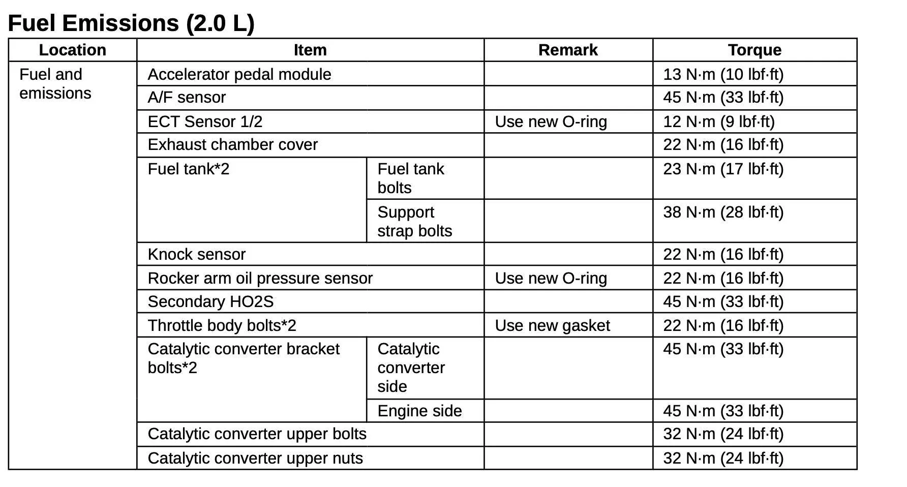

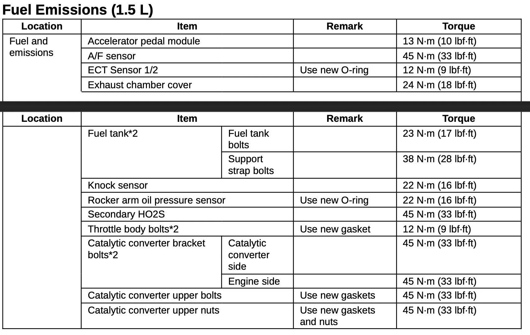

Reading through the service manual a member posted on here a while back.
The service manual says that the 1.5L civic needs to have its upper (turbo-side) gasket replaced on but not the 2.0L (FL5) Civic when replacing the downpipe.
Seems kinda odd that the smaller engine needs a gasket swap and not the large one?
Additionally, the torque specs are lower on the upper (turbo-side) bolts/nuts.
Hoping others can shed light on why and if I'm even reading this correctly.
Pics attached for reference.
1.5L Specs:
11th Gen Honda Civic Service manual TWC (Downpipe) Remarks Confusion Screenshot 2025-04-09 at 12.36.34 AM
2.0L Specs:
11th Gen Honda Civic Service manual TWC (Downpipe) Remarks Confusion Screenshot 2025-04-09 at 12.38.36 AM

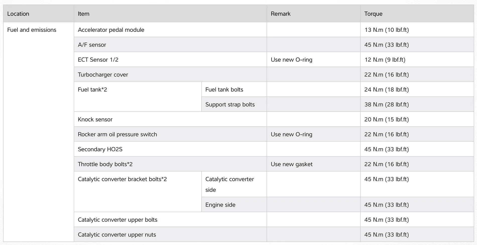

You’re looking at the wrong information in the manual, which is far too easy to do with the pdf. That’s partially why I ended up purchasing a subscription for the full manual. So much easier to find exactly what I need. It was 60$ for 4 years of access through Mitchell 1 diy, which I think is great value.
The table you showed is for a 2.0L non-turbo engine.
This is the table for the k20c1 - note that some of the torque specs are different.

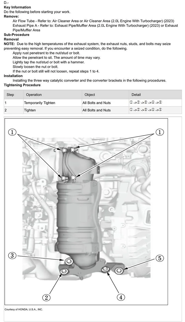

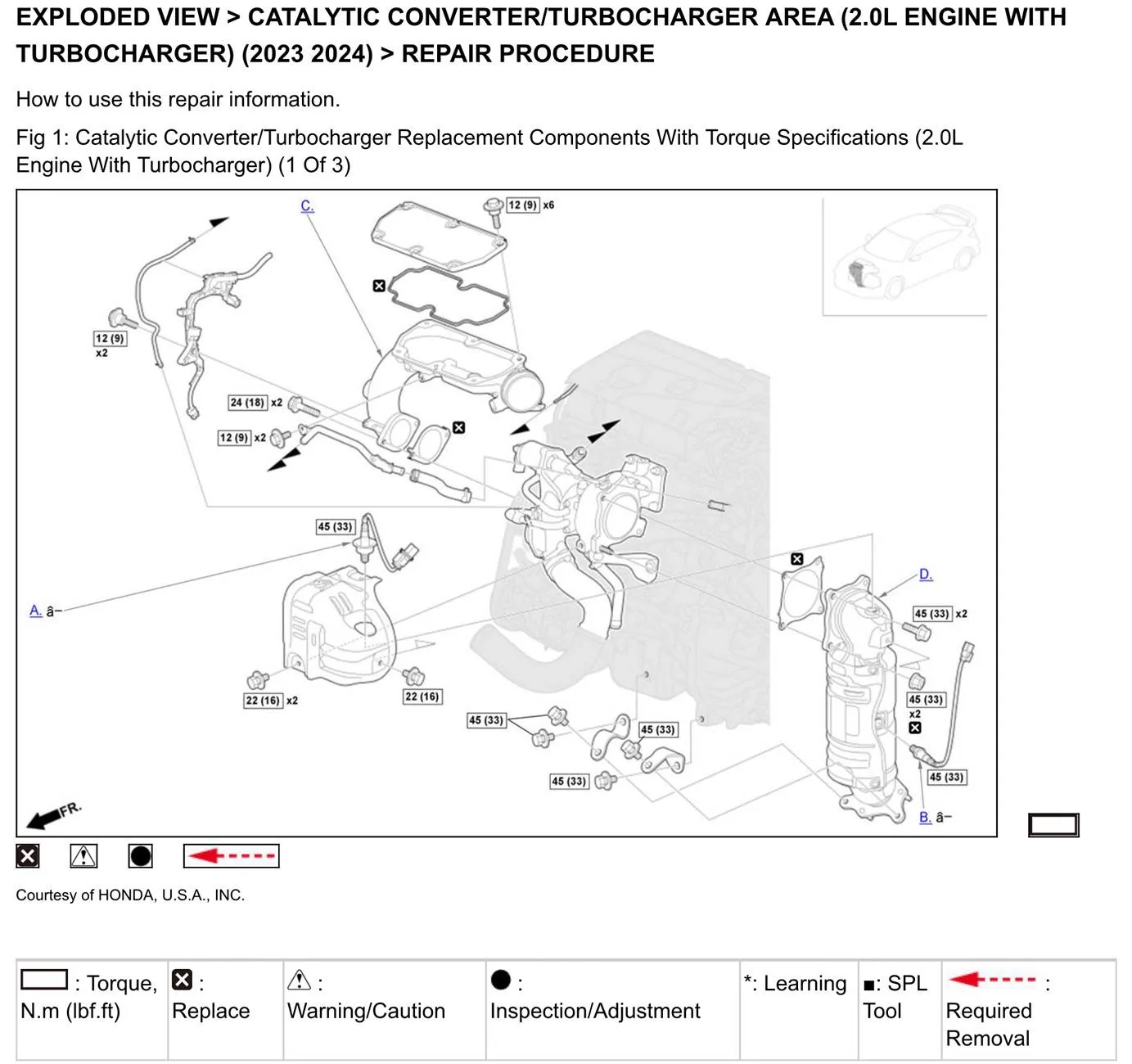

This table should only be used for torque specs reference. You should look at the procedure diagrams and instructions for the full details. The diagram shows that the gasket is supposed to be replaced.
11th Gen Honda Civic Service manual TWC (Downpipe) Remarks Confusion IMG_0216
And here‘s the procedure details:
11th Gen Honda Civic Service manual TWC (Downpipe) Remarks Confusion IMG_0217
