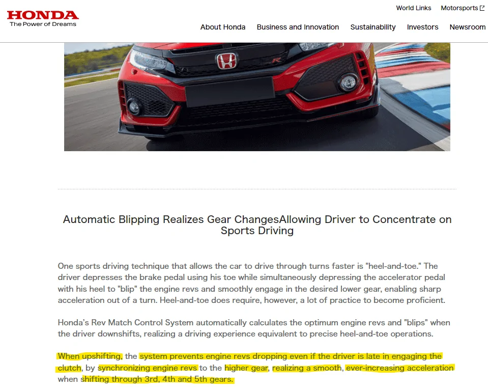

Just chiming in here as I thought this was always a feature of Honda type R? They quite openly state it:
11th Gen Honda Civic Revving issue during upshifts A78B667A-62EB-4766-9798-CC0E68EA01BC
When going WOT for max acceleration older manuals has jerky shifts running up the gears. When smooth shifting is needed the driver has to wait for revs to fall. Honda designed around this with Rev-hang during hard acceleration.
ECU also programmed to close throttle slowly for emissions so it has to be removed with a tune or you’d need to delete clutch delay valve.
the Integra Type S behaves the same exact way. I’ve had to learn how to shift the way the car wants to shift instead of what I’m used to. Been solid so far

That's an interesting find from Honda, thanks. I struggle to see any use of that feature when upshifting, as all it does is increase the revs between upshifts, which isn't needed... because it's an upshift. I can buy into the emissions point though, but it's still annoying.

Thaf is because traditionally timing is the important skill needed when upshifting and downshifting. Timing is less important for new drivers with Rev-matching and Rev Hang. For more seasoned drivers trying to shift quickly the rpm isn’t going to drop fast enough for smooth shifts, you’d certainly have jerky action. At the same time hard acceleration while smooth shifting waiting for revs to fall makes us “slow”.
Honda rev-match/hàng is supposed to alleviate that. Also helps novice drivers or those who shift slow. That’s why R+/Sport+ needs direct immediate shifting versus comfort mode with different response for less shock shifting.
You can adjust by not having the clutch pedal fully depressed to deactivate Rev-match/hang or just delete clutch delay valve all together If you like short throw quick shifts. But CTR/ITS was designed to bring people back to manual driving without advanced foot skills and precise timing. It’s truly an art form and I admire those who have mastered it

@Azkyrie As much as this has been discussed (for years), it’s good to finally at least get some explanation from Honda versus just the old “Rev hang was implemented due to emissions requirements” that has been repeated over and over. Thanks for this info!
certainly, perhaps many don’t realize this Honda’s explanation and design intent. I understand why many seasoned drivers don’t like it.
now seeing that it’s geared towards new drivers or slower casual shifting drivers during hard acceleration I can see why it’s beneficial and quite possibly has an effect on vehicle components longevity as well for these group of drivers
