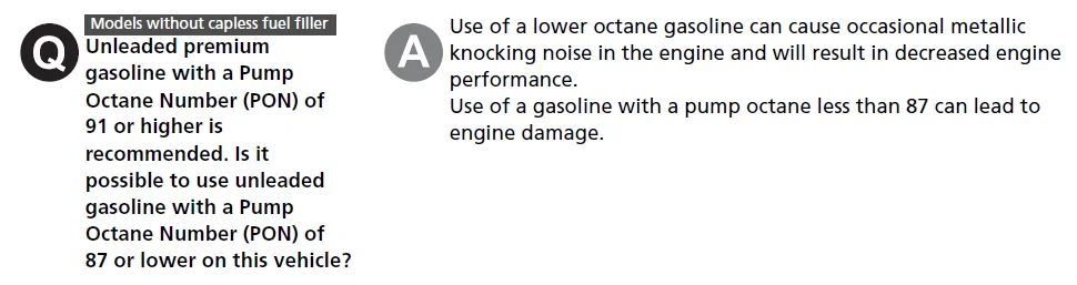

menikmati
May 27, 2022
337
391
STI, BRZ, FL5
" Use of a lower octane gasoline can cause occasional metallic knocking noise in the engine and will result in decreased engine performance. Use of a gasoline with a pump octane less than 87 can lead to engine damage. "
