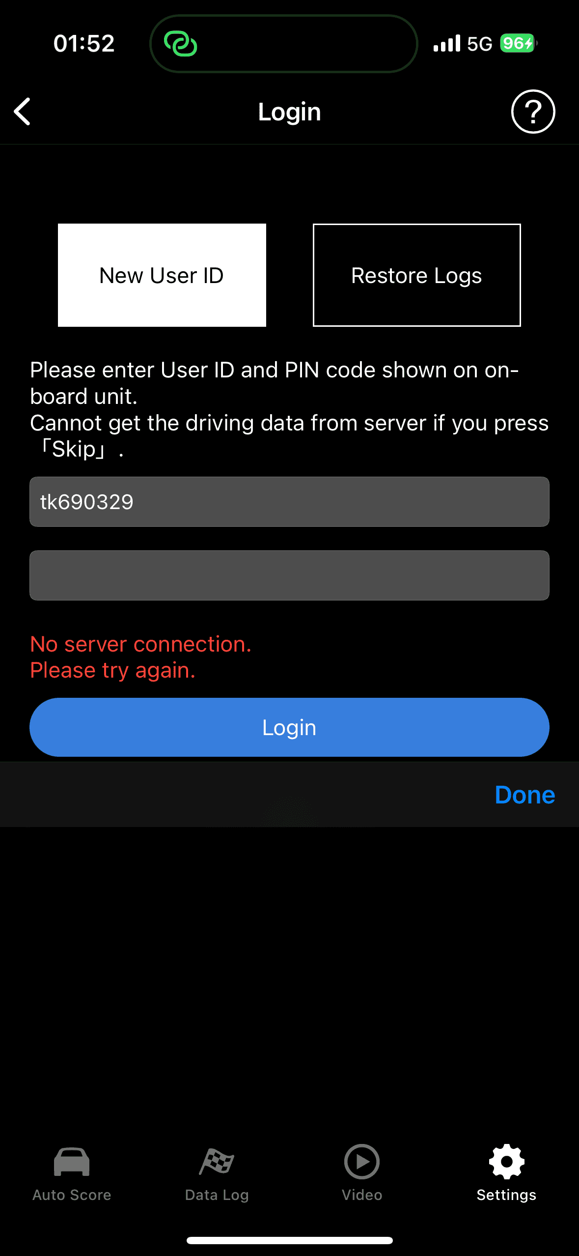

Regarding the problem of connecting the logr with the mobile phone, the pin code cannot be displayed

All you need to do is go to connections, wifi, disconnect from android or apple care play and connect to personal hotspot on your phone. Once that’s done, gives user id and pin.
No need for any wires.

I connected to my WiFi hotspot and while I get the PIN, I also get the no server connection error. Went through a factory reset and still no luck. Any more ideas?

I've been giving this a go too and my car won't connect to any WiFi network, including my phone's hotspot. Any ideas?
