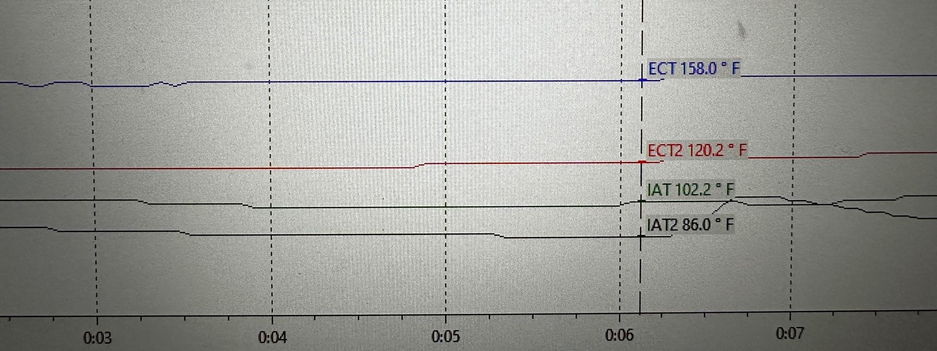

But those were logged in Hondata or just looking at LogR? If so you need to look at IAT 2 to really tell.
Here is an example with the PRL intercooler. It is usually 15-20 degrees cooler than what is displayed in the logR post intercooler.

So wait…the ecu is adjusting using pre intercooler temps (the sensor we can’t see) and not the post intercooler temp (what’s in the LogR)?

So on his new car with the stock intercooler he was talking about Coolant temps. His IAT’s must have been pretty high since the stock intercooler heat soaks pretty quickly but he would not have been able to see them since he did not have Hondata. So no way to tell unless you have a stock car with Hondata or a scanner reading the sensor and take it to the track.
Also the inlet air temps are used to do calculations for the ecu. A high IAT at the intake is programmed to bring down the power on the car. But it takes everything into account.
Same thing with the coolant temp sensors, the ecu goes off the Coolant temp sensor 1 which is the hottest reading and not off the second one which is considerably cooler.
