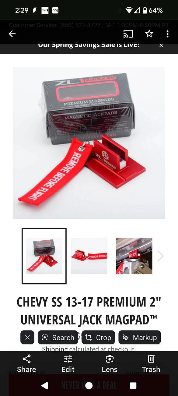

nttran98 posted a decent Amazon link on pg 3 of this thread. I have seen the ones below also from ZL1 add-ons also.
11th Gen Honda Civic Pinch Weld Lift Pads - ZL1 vs Versus Screenshot_20250504-142904

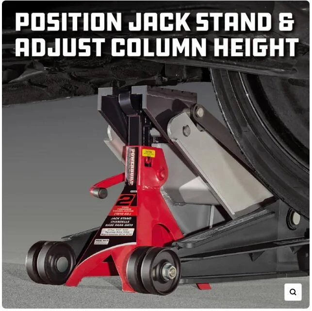

I just posted this in another thread but I will post it here too. I am trying to convince myself to not buy it as its not super hard to drive up on some pieces of wood and jack from the center point. But as I get older, the more lazy I get with this stuff lol.
Instead of buying pinch weld adapters (unknown safety) and quick jacks (expensive) the u-jack seems like the middle ground pricing wise, and also the most efficient way to get the car up in the air.
Basically you jack the car up on the factory pinch welds and then slide a jack stand into the groove. Probably half the time for setup with the QJ.
https://www.powerbuilt.com/products...Aero8IYRUlhTypo_8yJO-Pbyob07FWVVL9VT96iPV7lDh

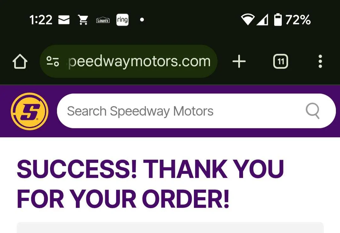

Speedway motor got this for 200 dollar but too heavy for my weak ass arm, so i returned it.

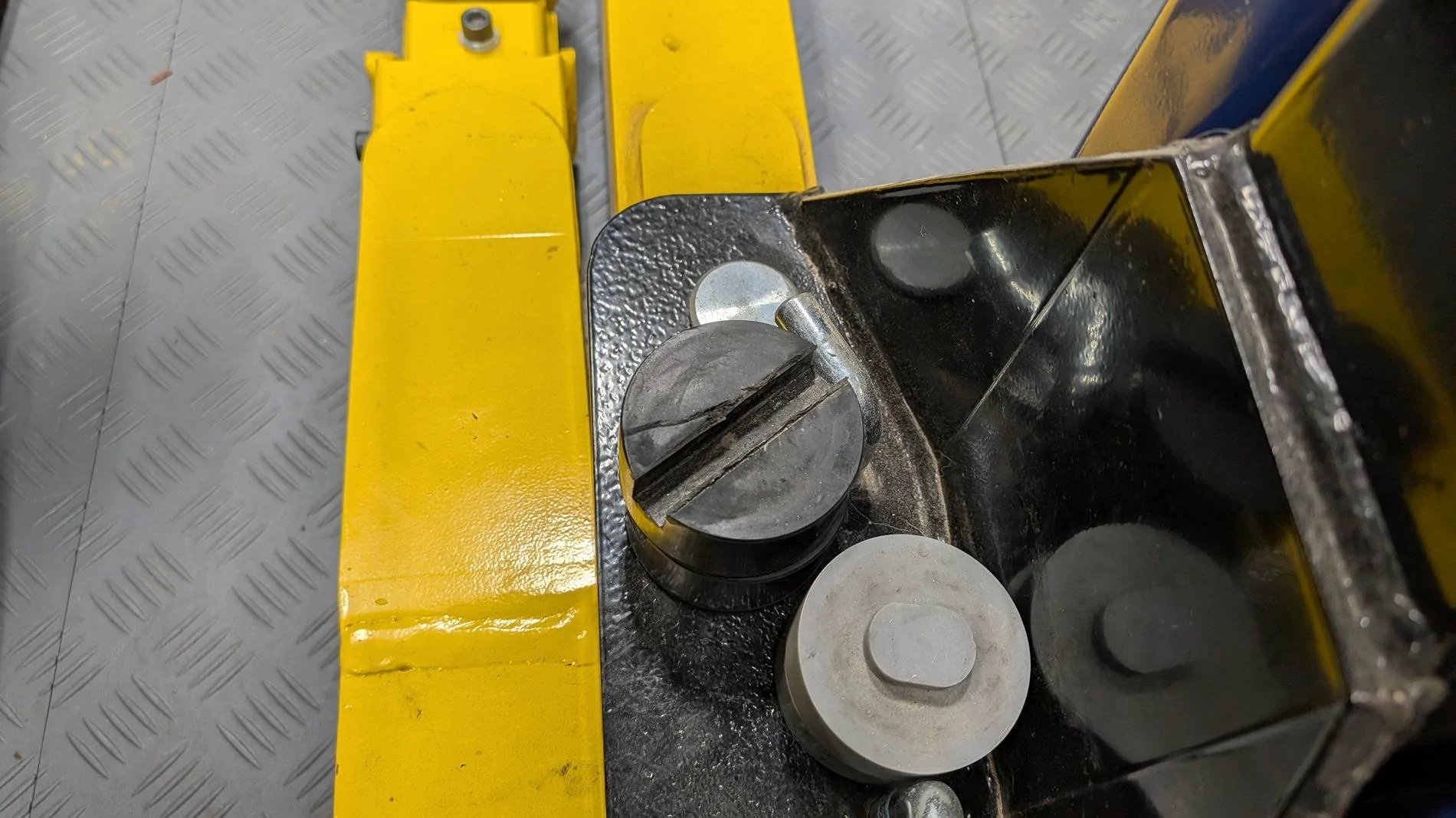

Rubber lift pads with the slot cut out is very cheap and works just fine too!
11th Gen Honda Civic Pinch Weld Lift Pads - ZL1 vs Versus PXL_20250523_193904774

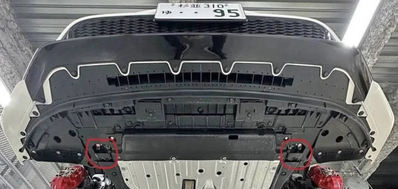

11th Gen Honda Civic Pinch Weld Lift Pads - ZL1 vs Versus IMG_2241
I saw a post on facebook with a person mentioning that they jack the car up on the front tow hooks, and then place the stands on the pinch welds. Anyone else do this?
Edit - found a video of an integra rmm install. Seems like an okay, unsanctioned jack point lol. Gonna try this next time instead of driving up on boards to get the center JP.
