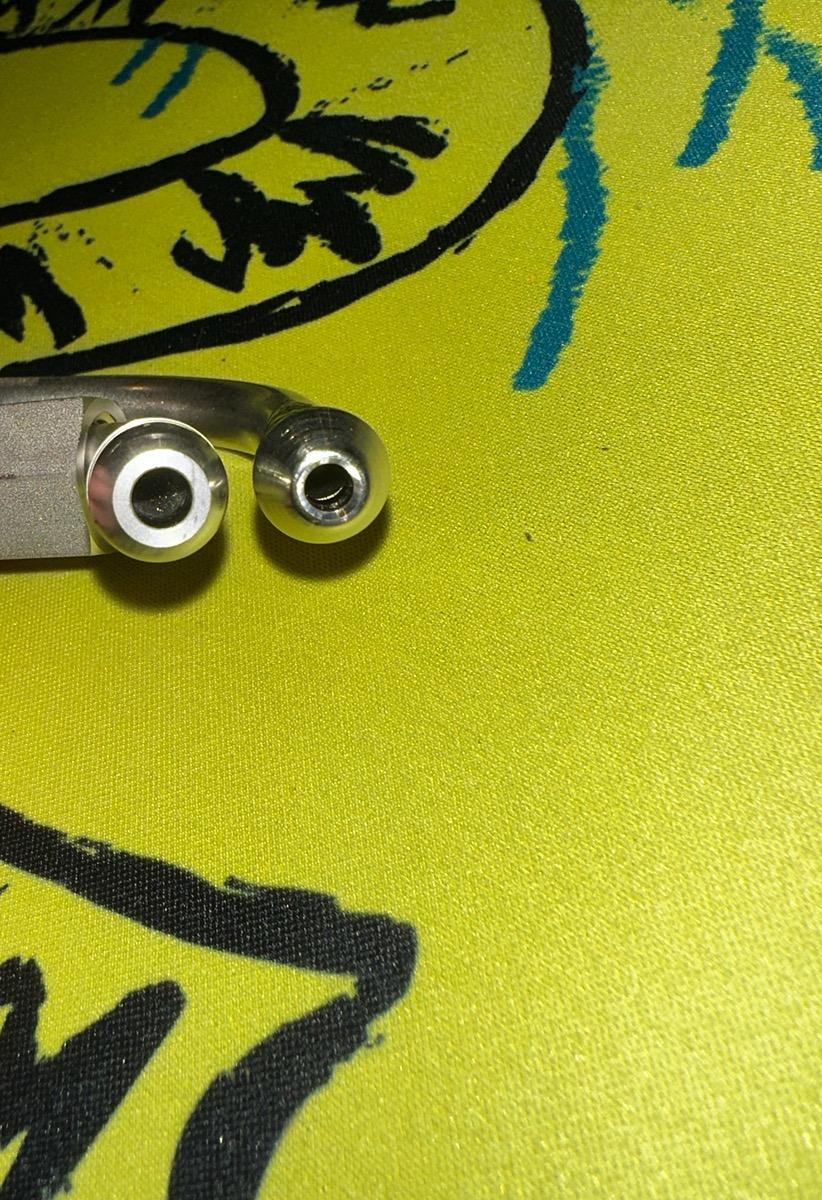

Fuel line comparison:
Pump connection for the fuel line on the pump side OEM (right)vs Full Race(left)
11th Gen Honda Civic Jester’s Hondata thread IMG_4256

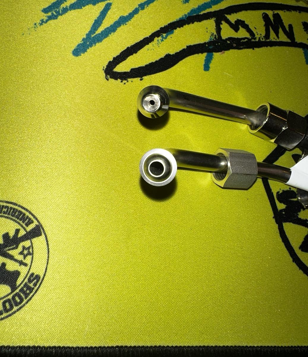

And now the biggest difference:
On the fuel rail side Stock line modded (top) vs full race (bottom).
11th Gen Honda Civic Jester’s Hondata thread IMG_4255
The difference is absolutely on another level.

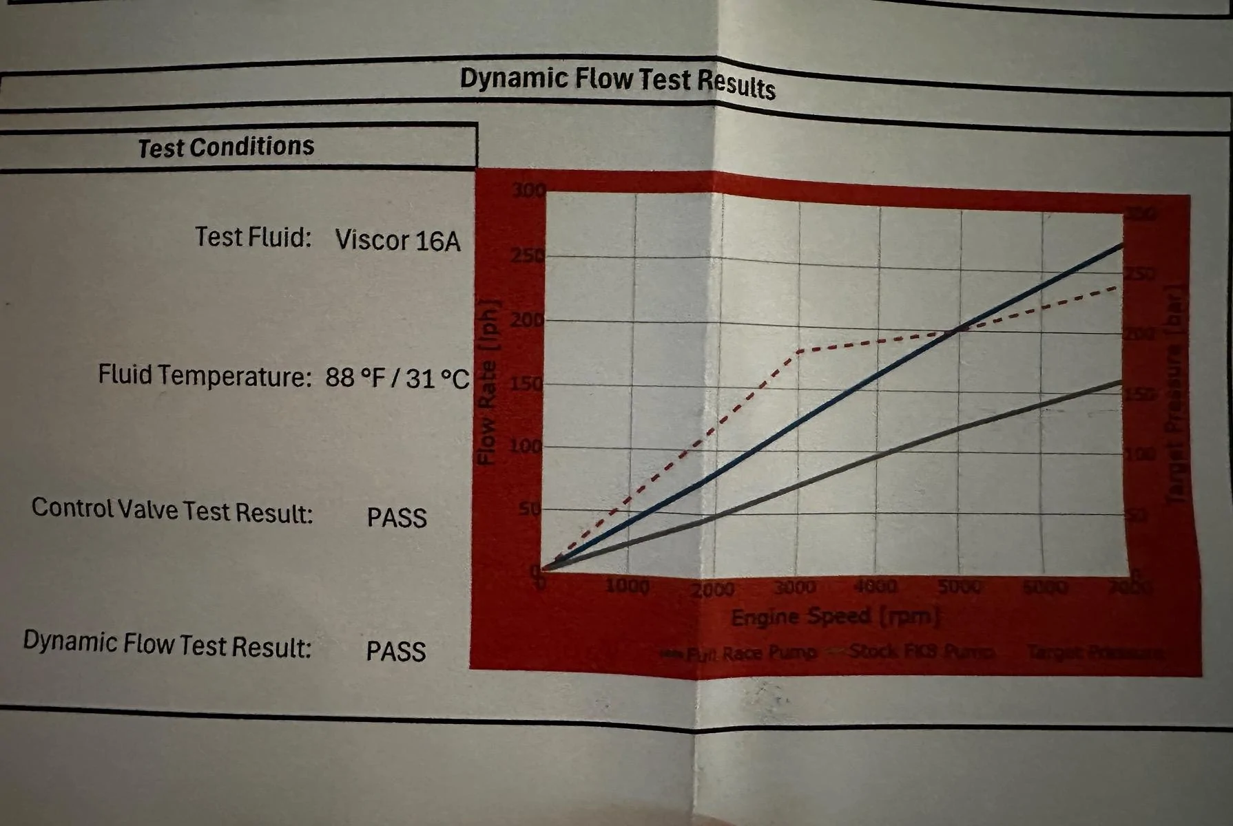

A little chart comparing fuel flow for the pump.
11th Gen Honda Civic Jester’s Hondata thread IMG_4258
