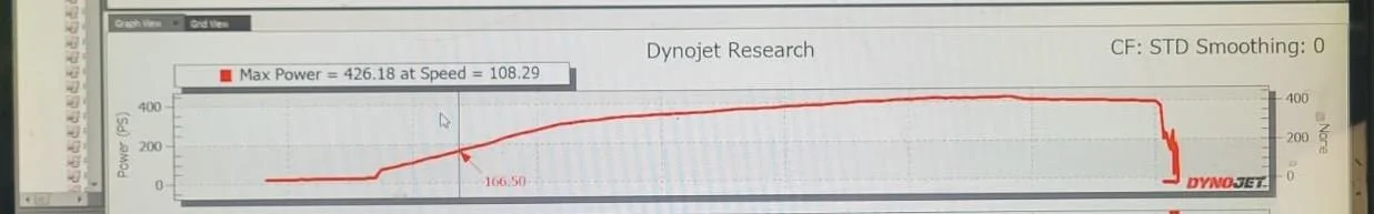

Had the opportunity today to hit the dyno on a customer’s car. Made some good numbers but it had more in it. We struggled with severe heat soak and power was down everywhere and we could not get it to cool due to poor ventilation on the dyno.
FBO and MHI stage 2, we did a test on the dyno spraying some water on the intercooler since IAT’s were over 130’s. And just by dropping 10 degrees on the intercooler it picked up 10 whp. Intercooler temps were over 100 degrees.
11th Gen Honda Civic Jester’s Hondata thread 8a6f9679-a216-4710-b6f4-00ced9ad1938
If we could get temps to the 80’s post intercooler it would have made at least 440whp on the conservative side. No heroics either 28psi of boost and no crazy timing either.
