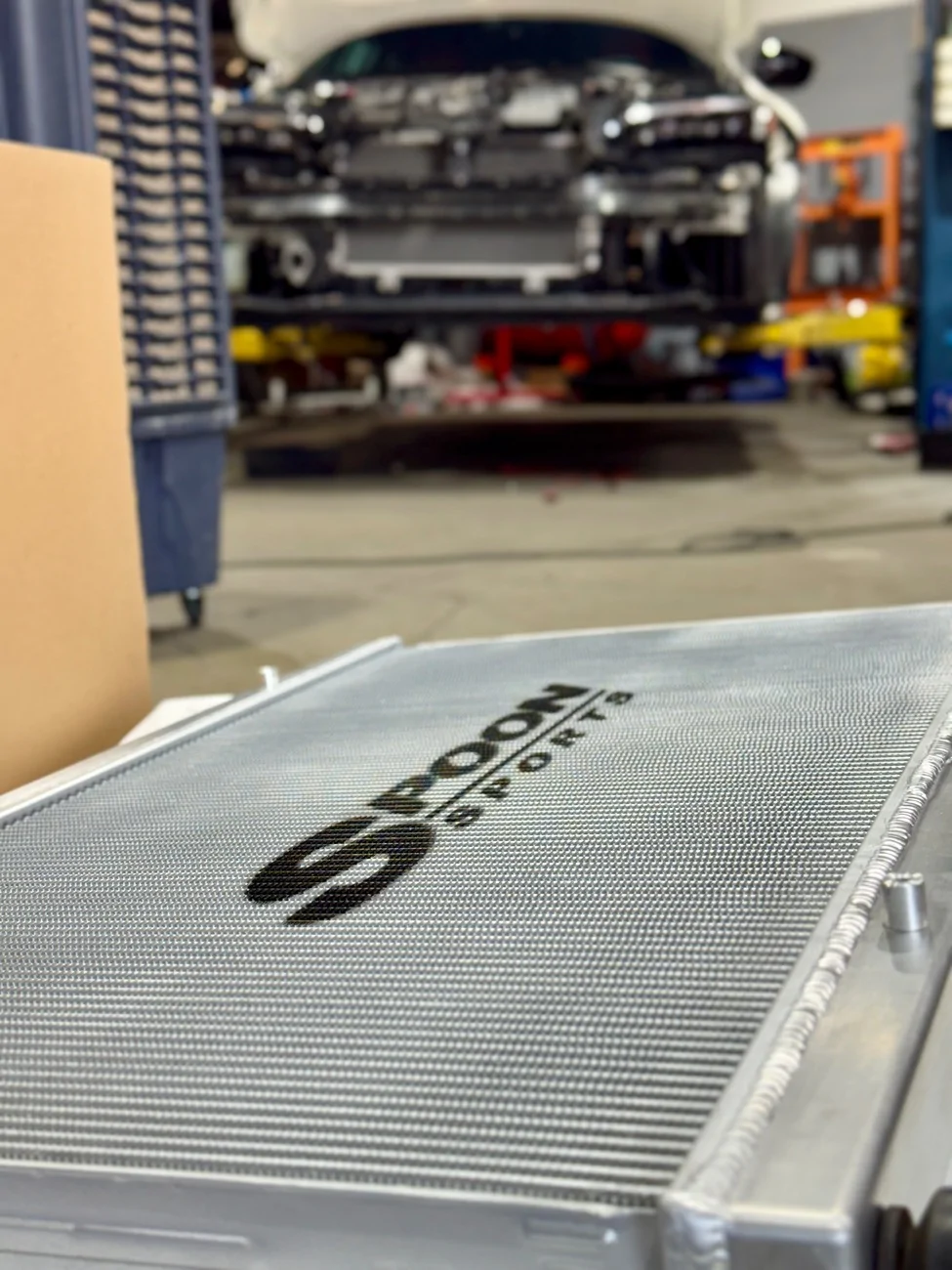

No photos. CANflex installed sometime after flashpro. R is now running e20-e40. Tuning later this month.
Spoon thermostat installed caused a P0128 check engine CL light. Flashpro manager solved

P0128 - Fixed through Flashpro Manager (un-clicked a checkmark LOL)
The drive home from the shop felt promising, Headed to spring mountain this Friday and Streets of Willow on the 31st. I don't DD the car anymore so I went with a higher spring rate.
