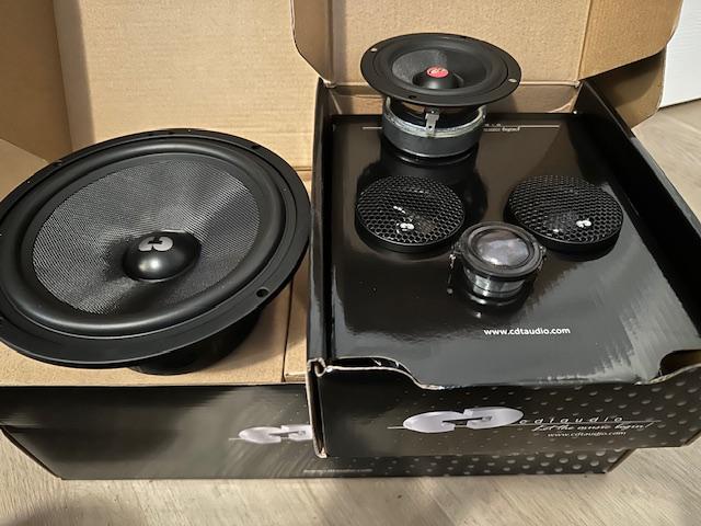

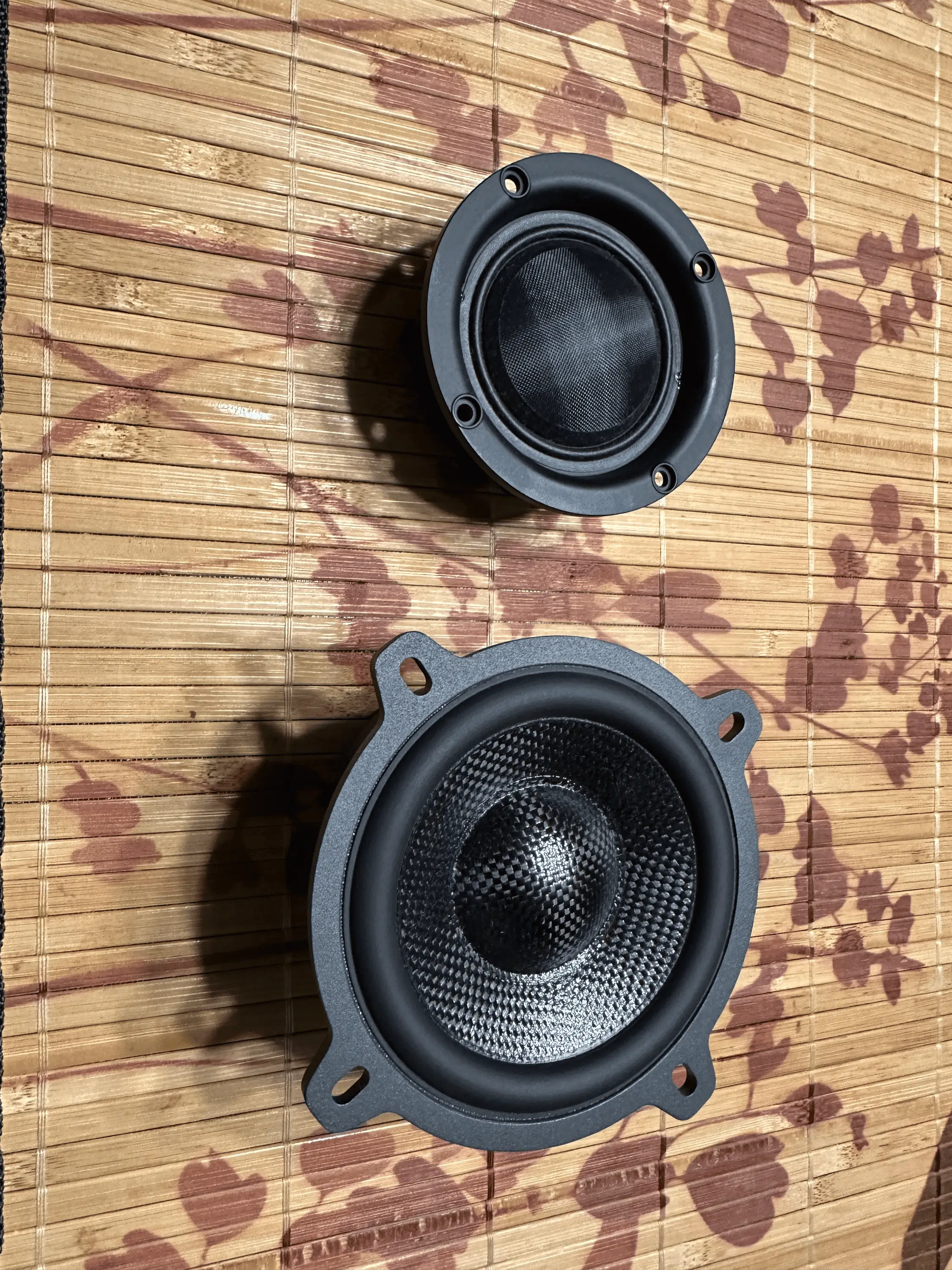

CDT Audio drivers:
ES-6.2
door (2ohm), 2nds/refurbished - I've bought these twice now and both times they appear to be 1st quality
CF-3 dash (this is a DVC so can be wired for 2ohm) ***UPDATED NOTE*** The center speaker measured to 4ohm, I will be choosing a different driver for this position
ES-1200iS
tweeters (4ohm but high sensitivity, should be fine based on prior Bose replacement experience). Have done nothing here regarding crossover... TBD
Total price: $310 (all numbers inc shipping)
A much less costly version (~$125) of this could be built using CL-6.2 & ET-250 and skipping the center speaker that I bet it will still be an audible upgrade over stock especially as you turn the volume up.
I'd like to do the rear doors (1" tweeter, 5.25" woofer) but I can't find 2ohm 5.25" drivers. ***UPDATED NOTE*** 5.25" measure 4ohm. Worst case I'll opt for CDT CL-5 2nds and pair it with ET-250 2nds so the "voicing" of the system is consistent and keep costs reasonable (~$120). Not sure if it's worth throwing more money at the rear spot with ES-5s and Es-1200iS (~$225) but... it's "only" +$100 so knowing me I'll probably go with them :D

11th Gen Honda Civic Icehawk's "OEM+" speaker upgrade CDT Speakers - Front
Still need to get harnesses and "bass blockers" for the tweeters and center. Not sure why but the tweeters did not come with any documentation, the 3" docs recommend a 300hz cutoff. I'll call CDT tomorrow to see what they suggest for the tweeters (update: they recommended 4.7uf cap).

ONLY the front 6.5" door speakers are 2ohm - the tweeters and center speakers measured out as 4ohm.
I'll probably return the CDT center and go with the Infinity Kappa 300 that's been discussed in past threads as I don't need a 2ohm speaker like I had assumed. If I end up doing the rear doors I'll take the time to measure them, I'd *assume* the tweeters are 4ohm but now I'm less convinced the 5.25" are 2ohm - maybe they are 4ohm and that would make swapping simple.
The tweeters have a cap, I couldn't see the uf rating on the one I looked at though. Nothing on the center speaker that I saw.
Replacement center speaker can be very large/deep - lots of room. You could probably rig a 5.25" in there :D
Wouldn't shock me if you could stuff an 8" in the door too if you're willing to cut a bit although I didn't put the windows down to see if it would interfere. Seemed like a lot of space though.

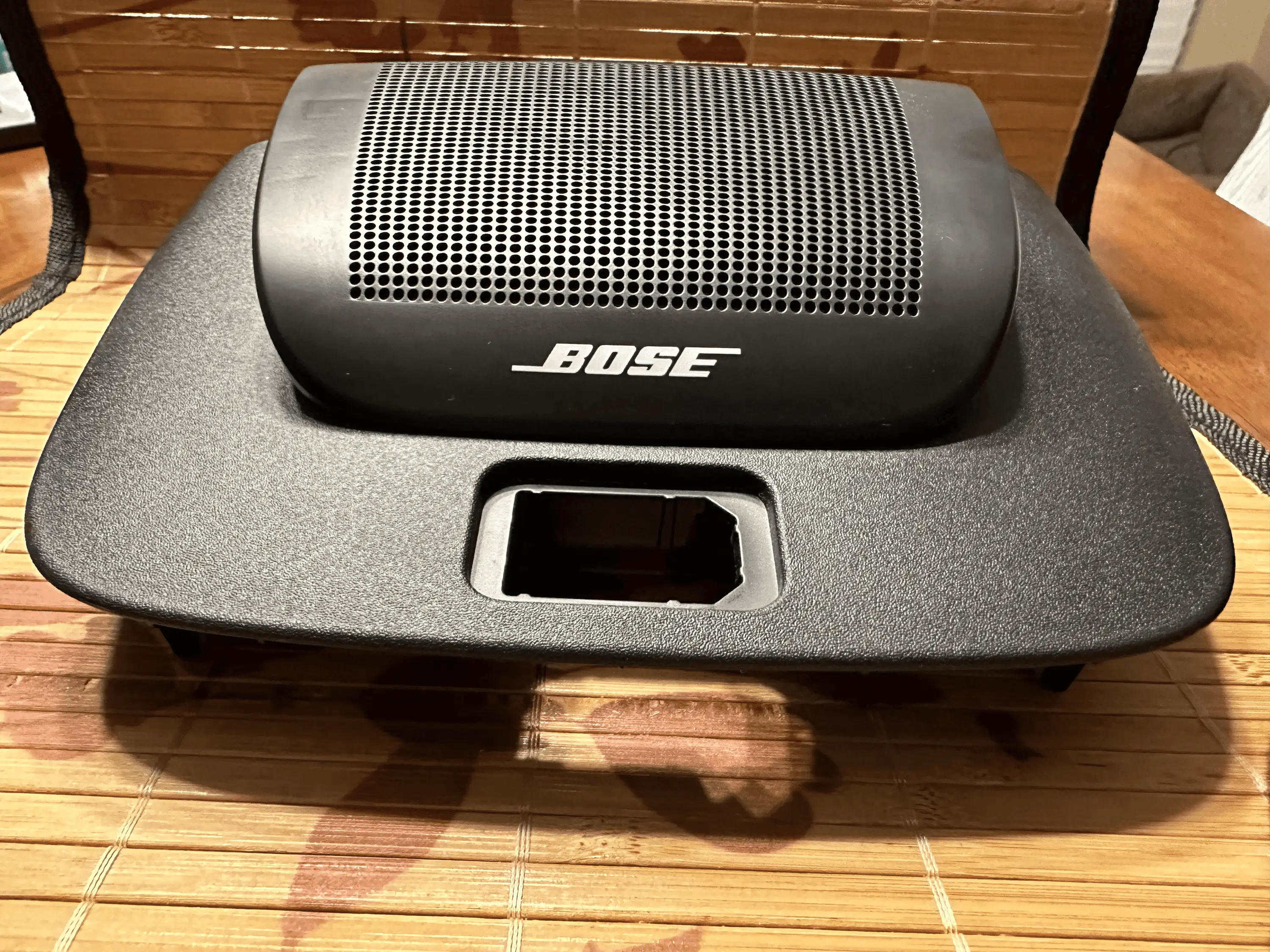

No surprise to me that the Bose speakers are lightweight junk, pictures so you can see for yourself:

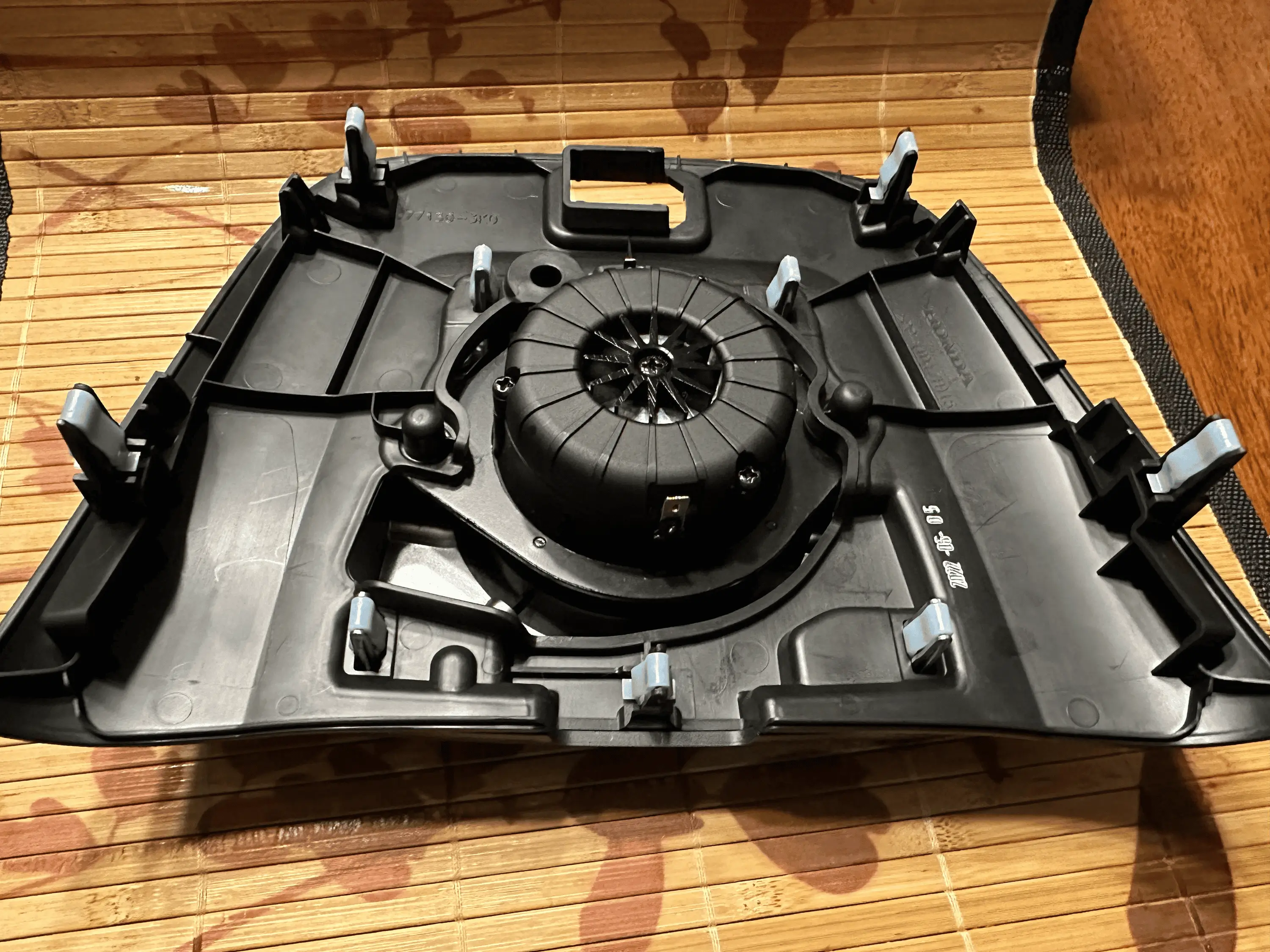

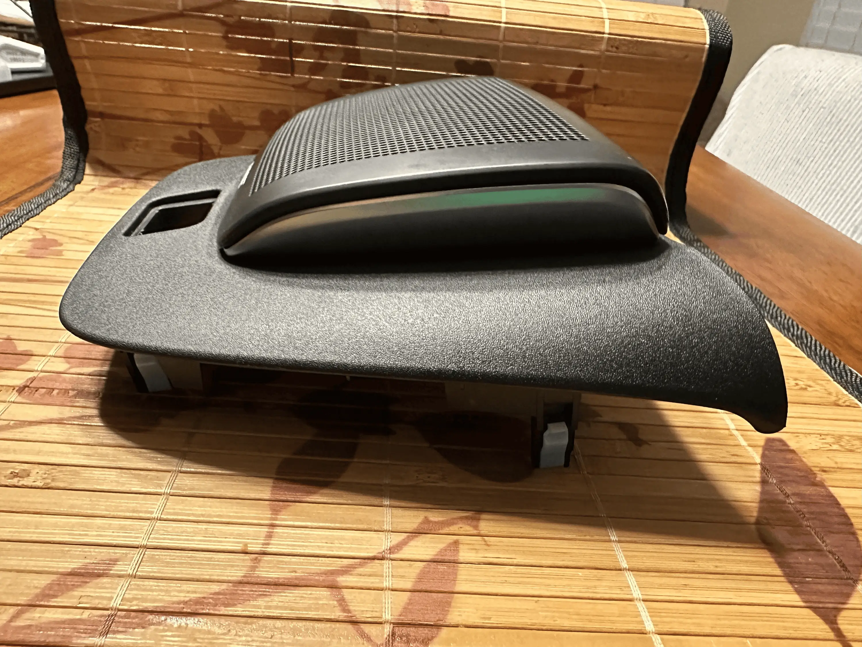

3" center
11th Gen Honda Civic Icehawk's "OEM+" speaker upgrade OEM center

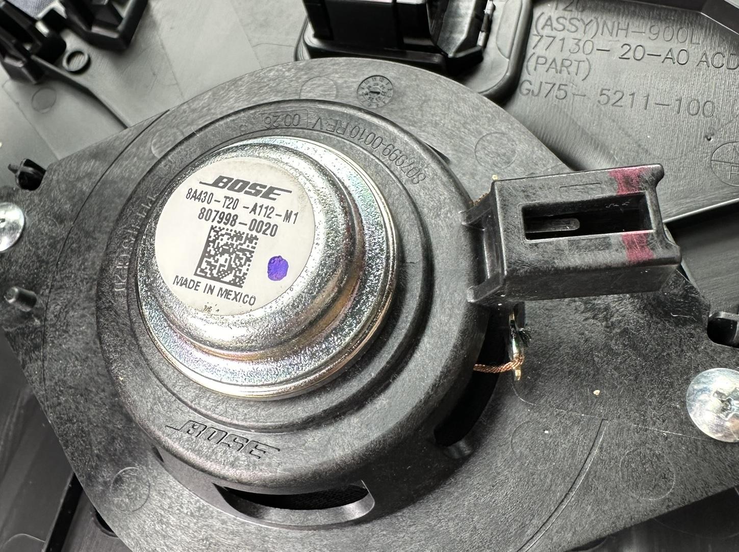

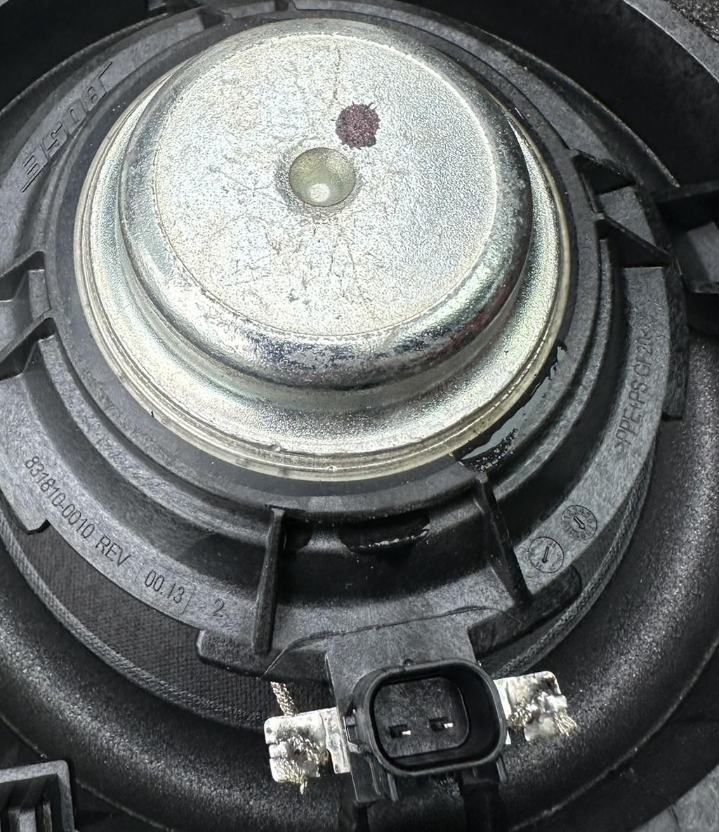

1" tweeter
11th Gen Honda Civic Icehawk's "OEM+" speaker upgrade OEM tweeter

If anyone knows the plug type of the center and/or tweeters please let me know. Supposedly the doors are 72-7800.
This is what you will need for the Center Channel Speaker and Tweeters. I used this when I changed out my Center Channel Speaker to a Kappa 20MX I tried using the 300m but I ran into cone issues and surprisingly depth issues it would have required me to had the crap out of the panel .. so I just stuck with the Kappa 20MX and I have been quite impressed with it, made the sound stage very focused now :thumbsup:

I mean it could work but the 300M is 4" from center to center for the mount holes.. would require a bit of work but I wasn't willing to hack up the center channel speaker cover to make it work.. But there is another way :hmm:

Wait, wut? That must be from another model?
I might ask my shop guys just to rig the mounting of the center/tweeters since they have way more experience - otherwise I'm probably going to resort to straps and hot glue. This is where I wish I had a 3D printer!

Ah, yes. I don't think that's necessary - there is a ton of room, it's just how you mount the speaker/modify the grille need a little work.

Will be interesting to see what you can fit.... if some how you can come up with a way to keep the integrity of the panel and still find a way to make the larger midrange 4" work, then I'll definitely switch up to the 300M :thumbsup:

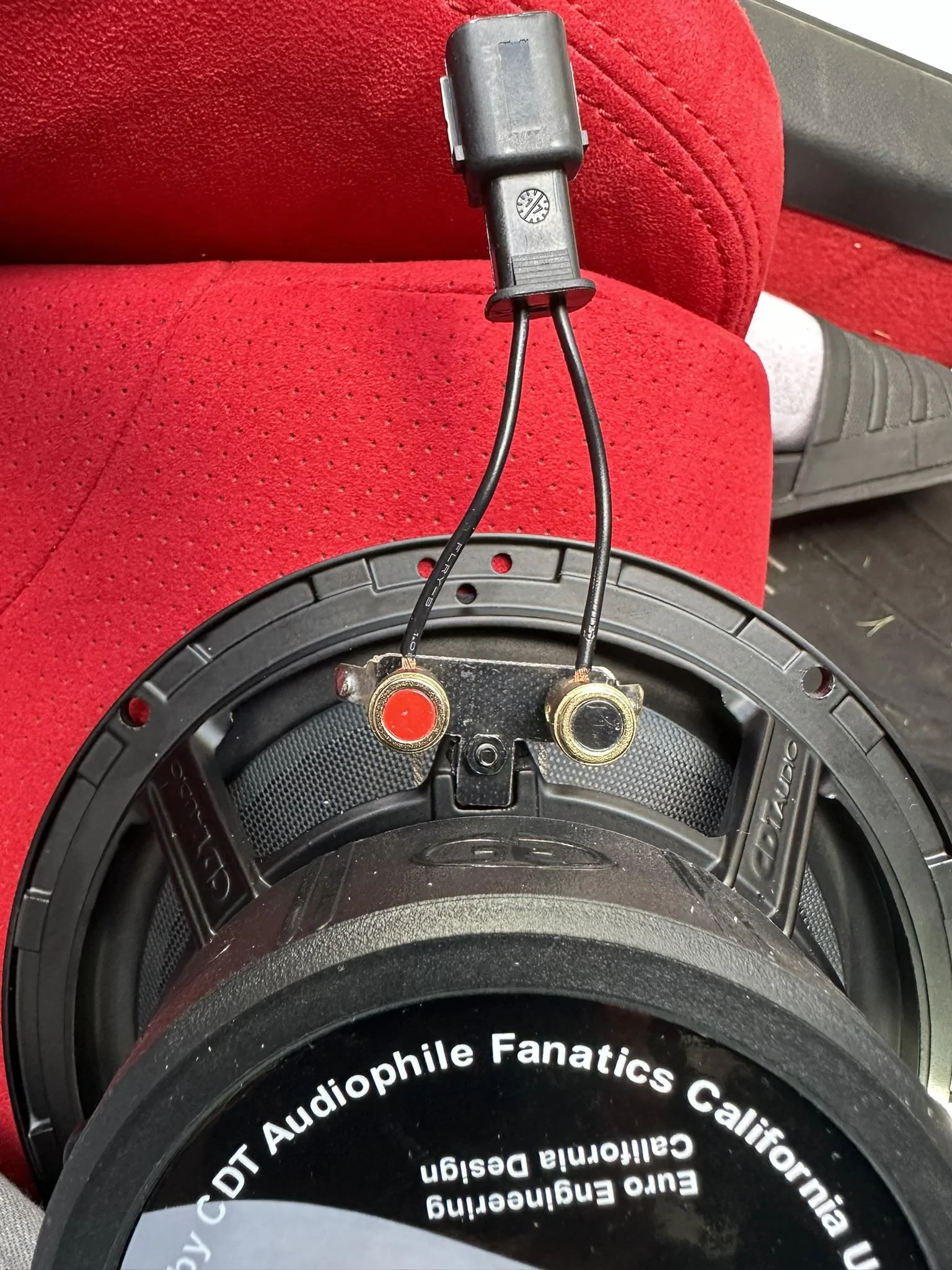

Door speakers are done, they were pretty easy. Hard to judge the improvement (it's there though), as just like the last time I did doors only on a Bose system - all I'm hearing now are terrible tweeters! They are next up, probably a weekend project.
11th Gen Honda Civic Icehawk's "OEM+" speaker upgrade CDT Speaker mounted

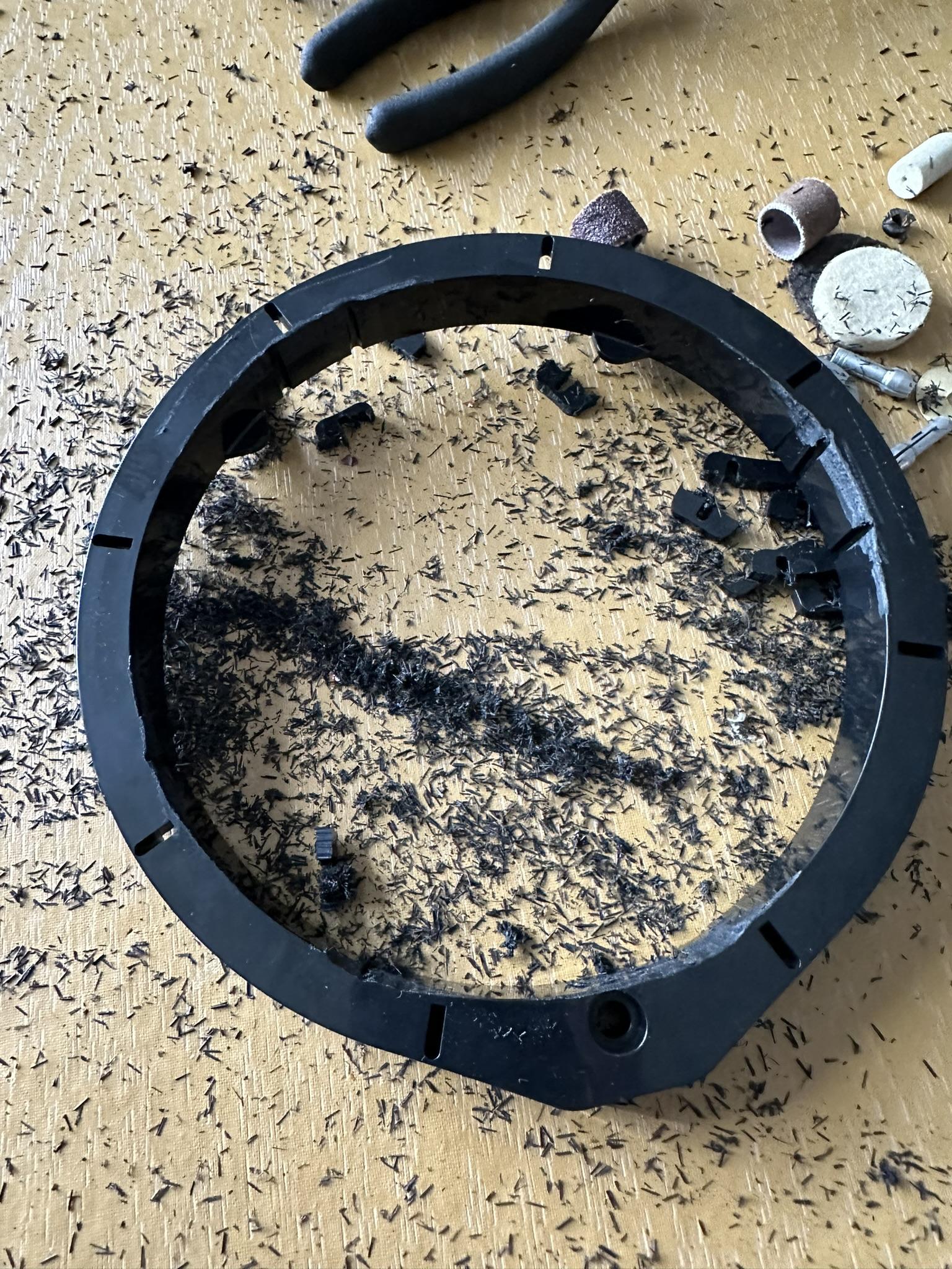

Parts needed are:
Ai HSB524 2006-2012 Honda Speaker Adaptor
X AUTOHAUX Car Speaker Wire Adapter Audio Horn Harness Cable Connector for Honda Civic 2pcs
The adapter needs trimming of the outer tabs

Pic of the plug showing polarity (I'm pretty sure it's right, sigh)
11th Gen Honda Civic Icehawk's "OEM+" speaker upgrade Plug Polarity
