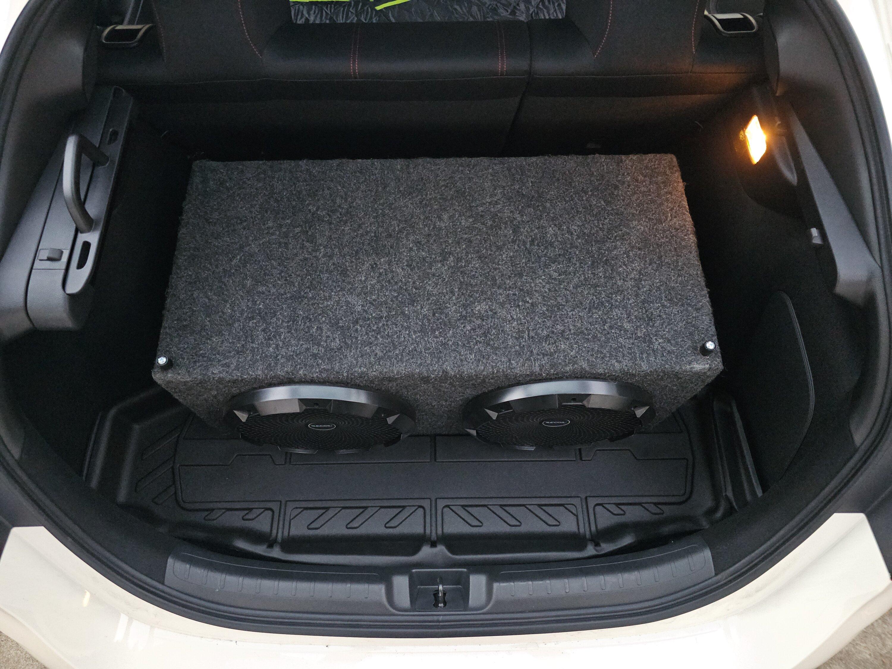

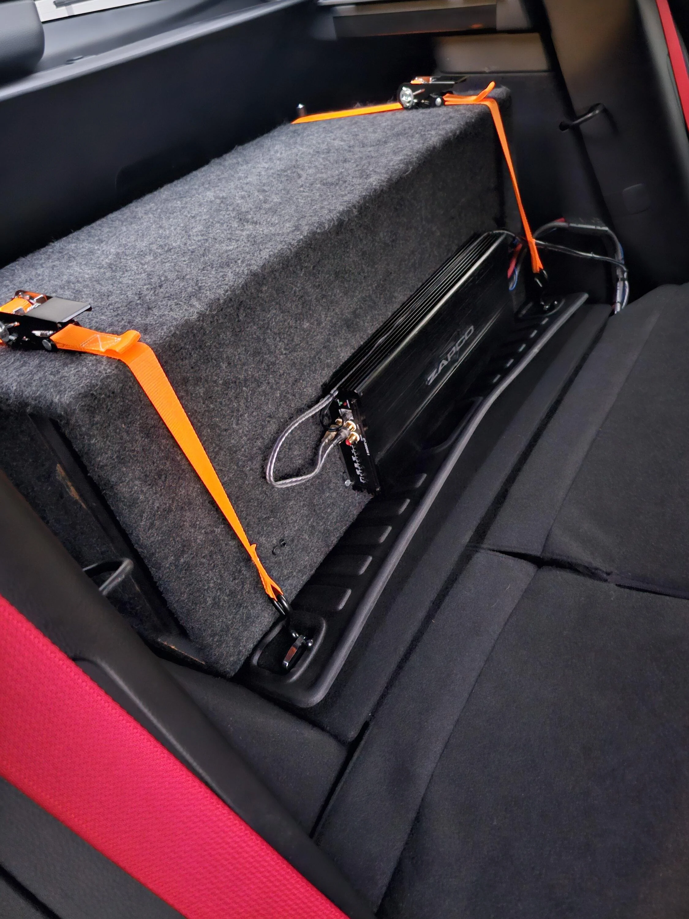

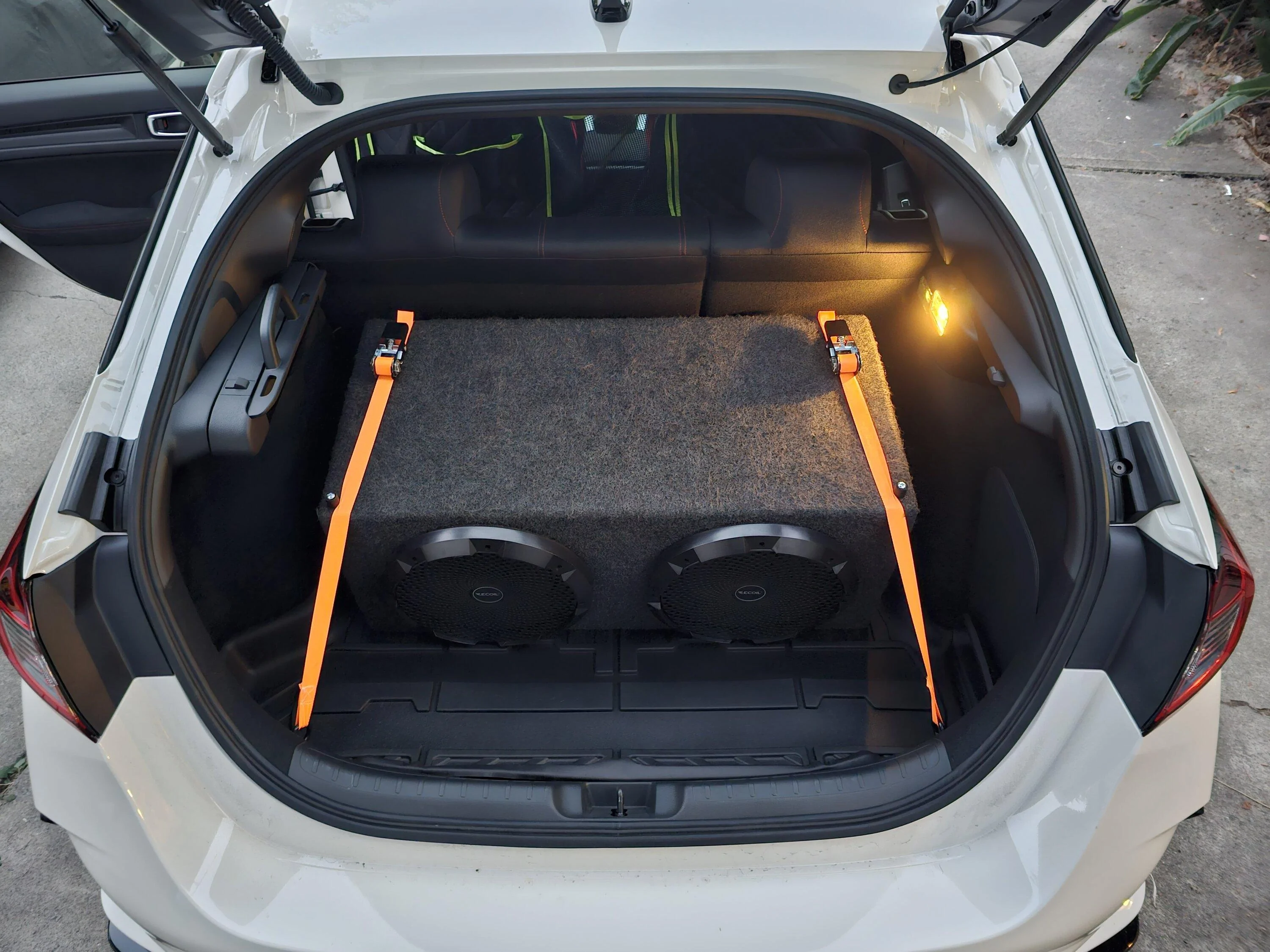

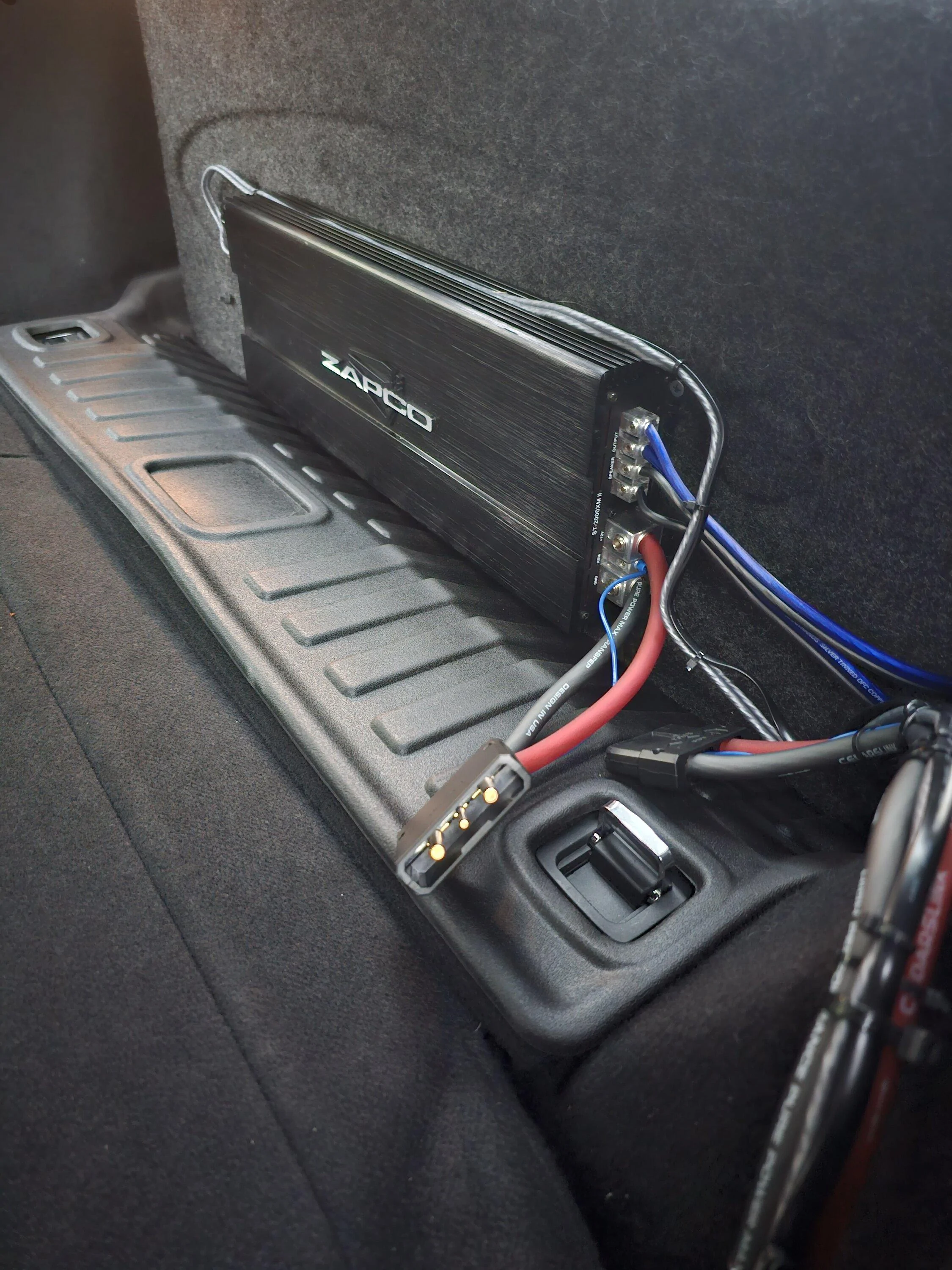

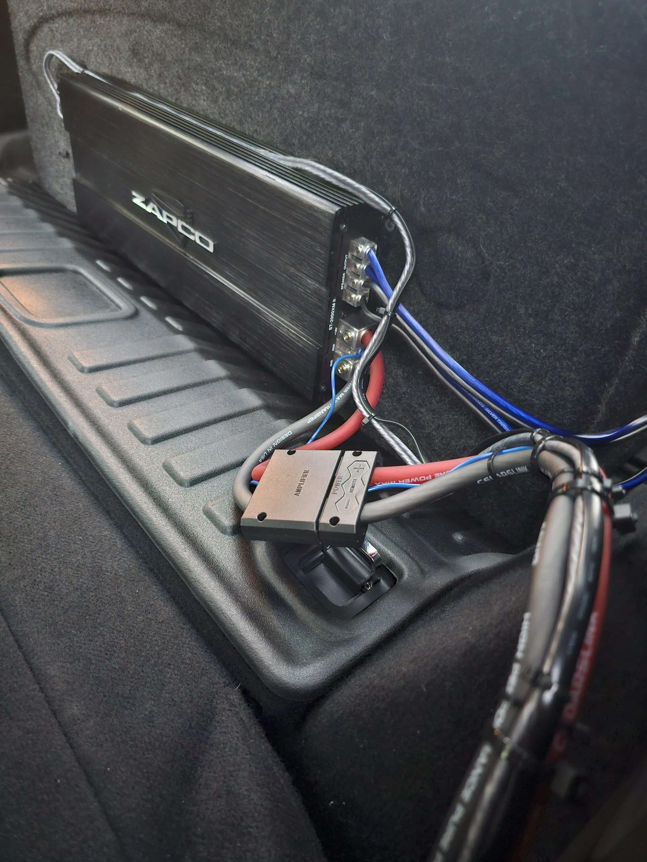

I included pics of how it first sat in the trunk. Absolutely no useable space remaining. So, until I get a setup with a smaller box, I did manage to get a few more inches of space by propping it up on the ledge just behind the back seats. This of course required strapping it down to keep it in place. I also installed a quick disconnect plug so that it'd be a little easier to pull the entire box out with the amp mounted on the back of it if I ever need the space, or want to cut the weight... speaking of which, this setup is not light. If I had to guess, I'd put it at just a little over 100 lbs.
Oh man I though the head unit couldn’t be tapped to do external subs. How did you do this?!?

It can't be tapped into in the traditional sense, meaning you can't use an isolated channel for you amp signal nor can you get an RCA signal direct from the head unit. However, you can use a line output converter to convert speaker wire signal to RCA. These range in price but a very reliable option would be AudioControl's LC2i. You'll just need to tie in the LOC to the factory sub wiring, and you've got a decent signal to work with.
