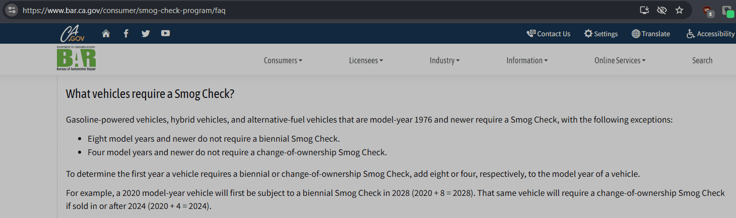

Yes, you can flash back to stock and reflash to your tune, but why would you need to smog a new car? In California if you purchased a brand new car you are not subject to a smog check every 2 years like older cars. My car was purchased new in 2023, I don't need a smog check until 2031, that's even if I keep it for that long.
