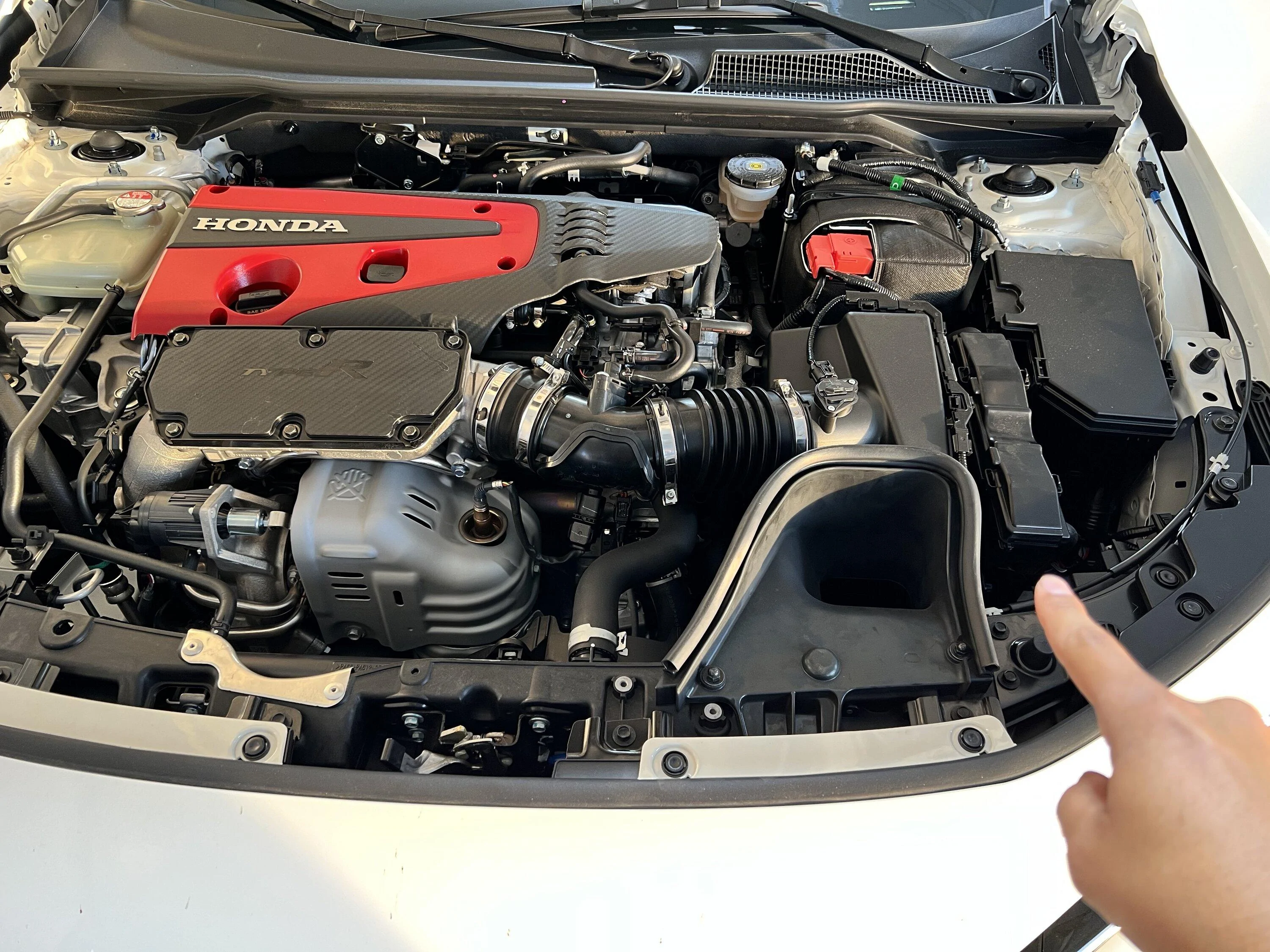

Jailbreak Process:

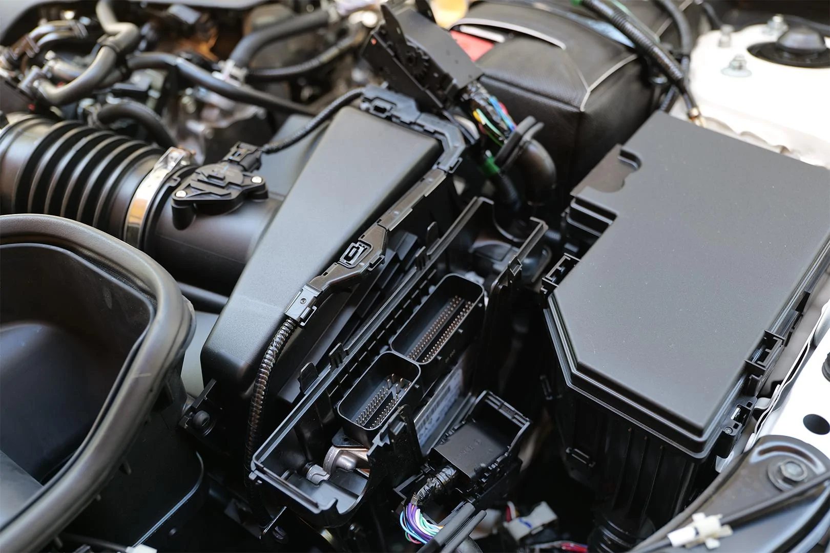

This part is very straight forward. You’ll have to take out your ECU.
11th Gen Honda Civic Civic Type R Jailbreak and Hondata FlashPro (Process) - Ososik civic-type-r-location
11th Gen Honda Civic Civic Type R Jailbreak and Hondata FlashPro (Process) - Ososik civic-type-r-ecu-cover
Disconnect the 2 harness plugs and bolts holding the ECU bracket. Take your time with disconnecting and plugging in the harness because you do NOT want to bend a pin.

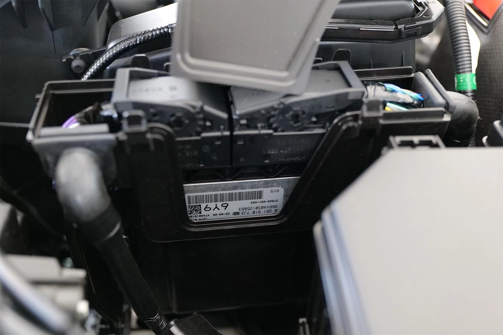

The ECU Serial Number can be found here.

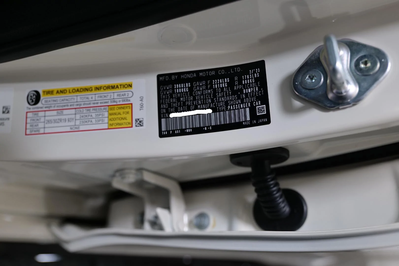

The Vin locations are on the windshield or door panel.

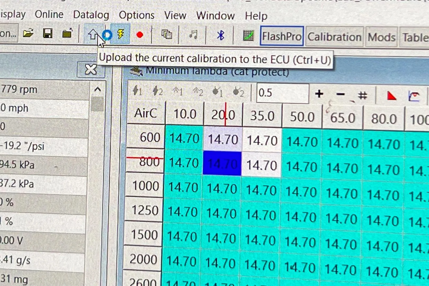

FlashPro Install:
  • Grab a PC computer
  • Connect to Internet
  • Download Hondata FlashPro latest software
  • Connect your FlashPro to your Laptop via USB cable provided (Update Firmware if needed)
  • Connect the other end of the FlashPro to your Civic Type R OBD2 port (under the dash)

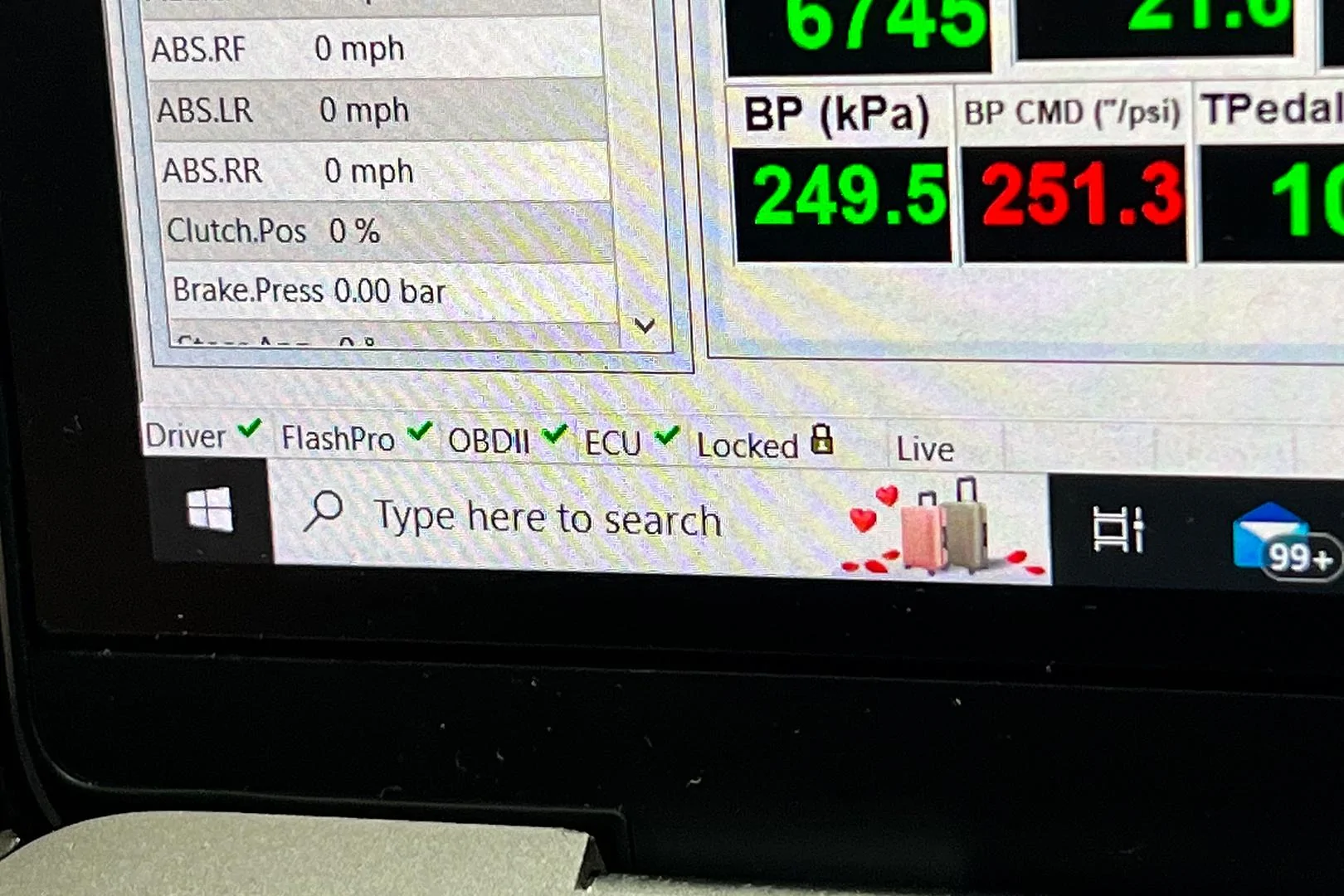

  • Confirm connection on lower left side of FlashPro Manager Screen
11th Gen Honda Civic Civic Type R Jailbreak and Hondata FlashPro (Process) - Ososik hondata-flashpro-type-r

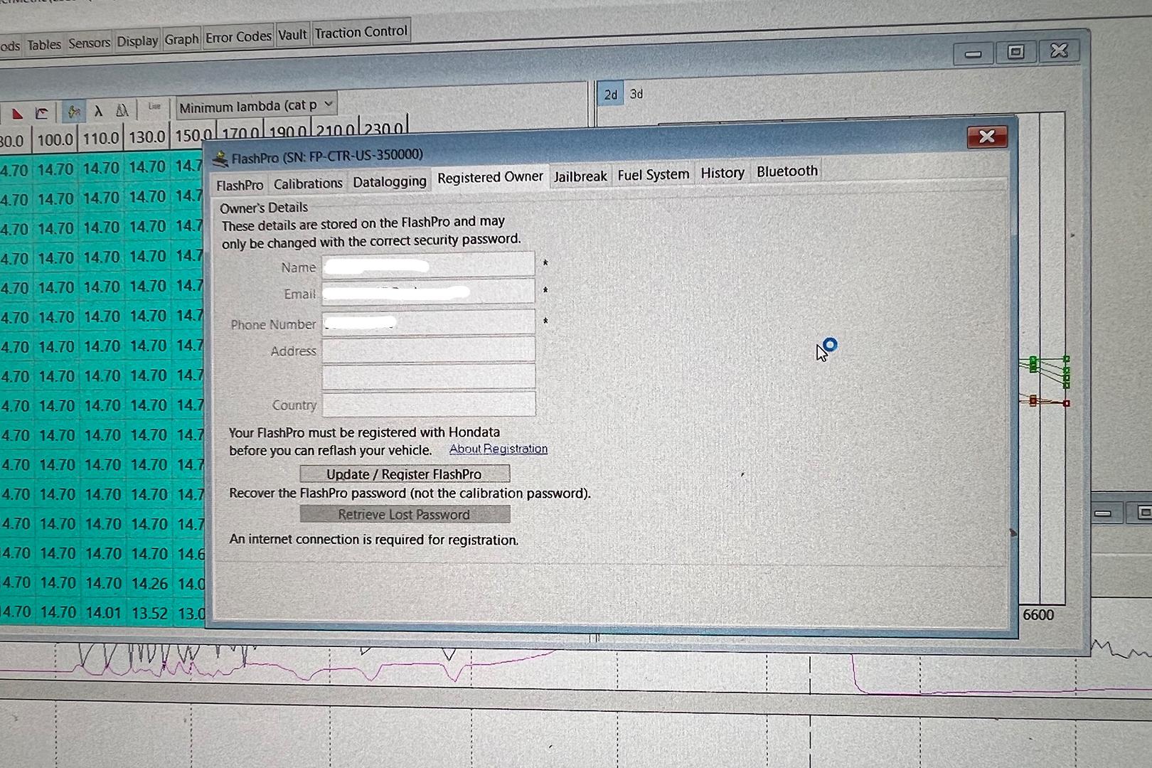

  • Register FlashPro
11th Gen Honda Civic Civic Type R Jailbreak and Hondata FlashPro (Process) - Ososik hondata-flashpro-type-r-002
  • Lock FlashPro to Vehicle

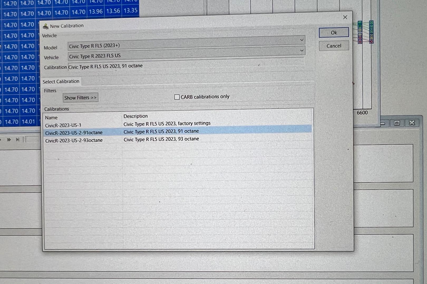

  • Create New Calibration
  • Select Desired Calibration, in California we have to pick 91 octane. 93 octane users automatically get to enjoy more power (lucky).
11th Gen Honda Civic Civic Type R Jailbreak and Hondata FlashPro (Process) - Ososik shpro-type-r-004
  • Turn ignition On (Auxiliary Mode)
  • Click Upload (Up Arrow)
11th Gen Honda Civic Civic Type R Jailbreak and Hondata FlashPro (Process) - Ososik hondata-flashpro-type-r-003
Hang out for about 6 mins (Upload time).
Once upload is complete follow the prompts by turning ignition off and the turning the car back on. Because it's a Type R you’ll have to drive the car around (casually meaning do not full send it).
Technical reason for that is because after a reflash the Type R will not run in closed loop.
If you have any questions or need help with installing/uploading Hondata FlashPro feel free to ask.
