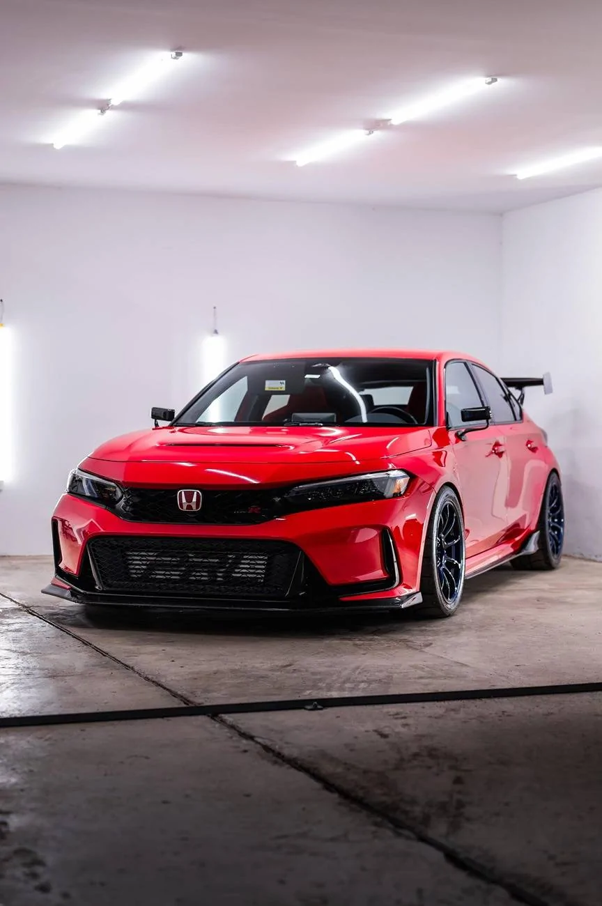

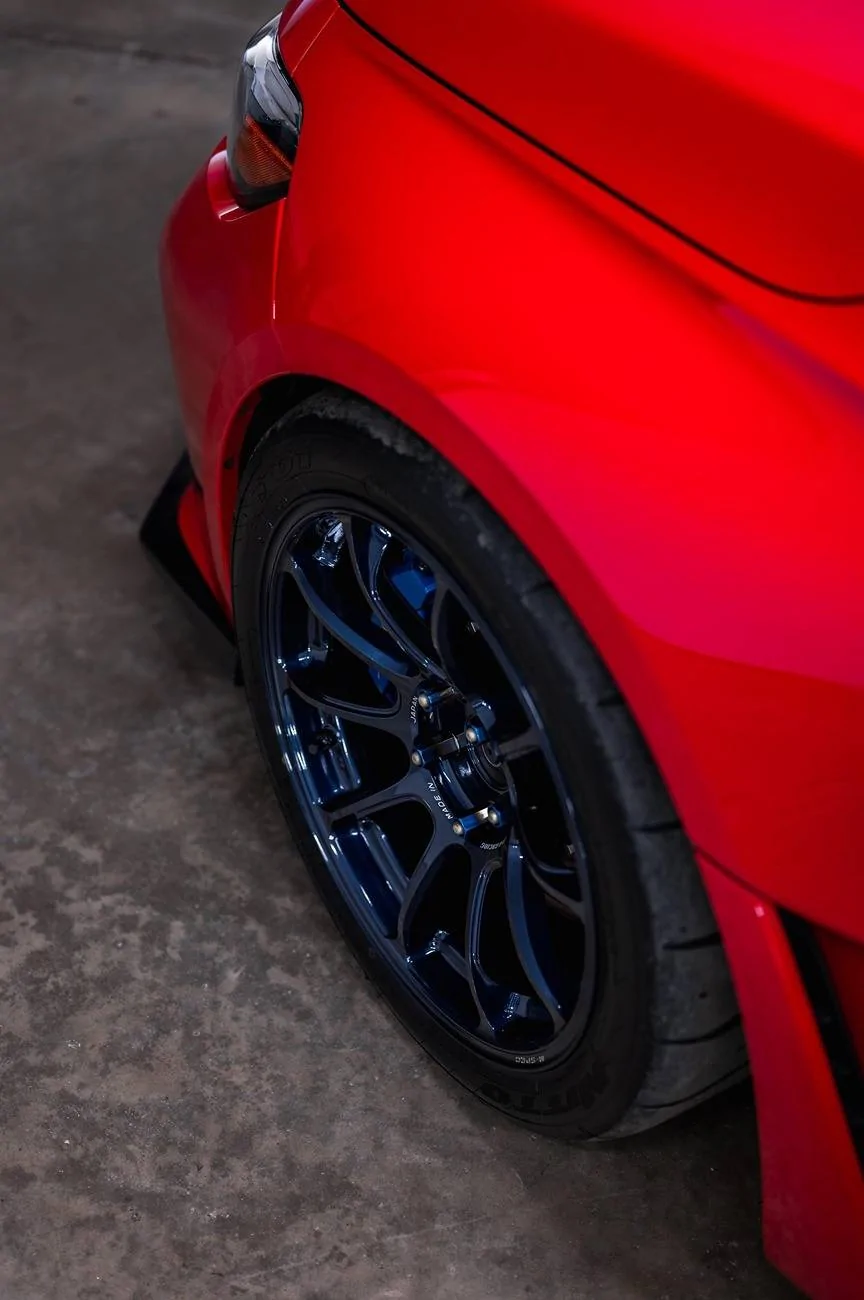

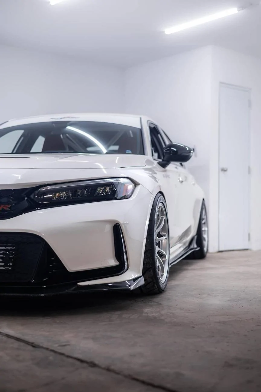

All of our customers run 275/35 on 18x10 +40. All ranging between different suspension setups.

any issues with rubbing on any of those setups you’ve seen?

no rubbing on any of these setups. 275s fit like a glove with a lowered suspension setup.
