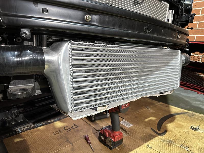

At the heart of it, is an off the shelf PWR racer intercooler, measuring 600mmx200mmx68mm with 2.5" inlet and outlets and is tube and fin. This is crucial for maximum airflow to the radiator to aid cooling in hotter climates like what we get in Australia.
I have it mounted to the PRL hardpipe kit. Connecting to the silicon joiners and have set aside the PRL cast elbows.

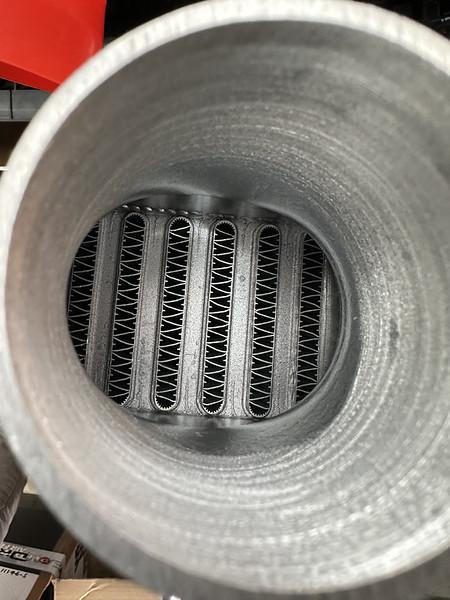

PWR racer core has a unique tube and fin design as pictured

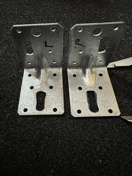

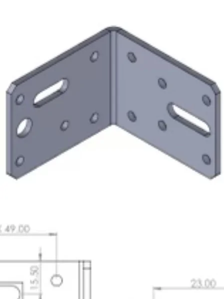

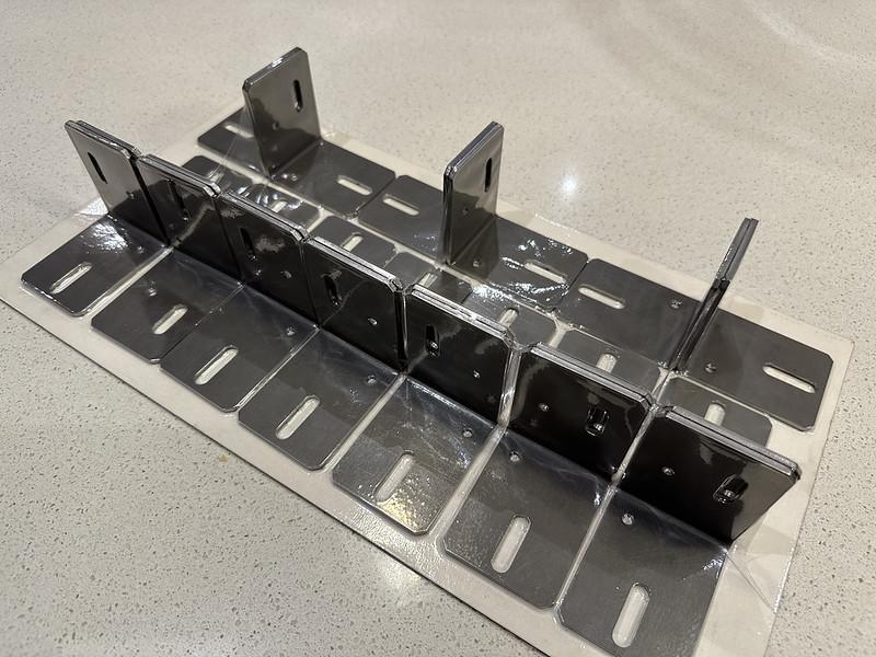

There are no holes cut into the factory crash bar, i have just utilised the exisiting holes to add two mounts to fix the intercooler in place. These two mounts were L plates from the local hardware store with slots that i drilled to help align and move the intercooler up and down and left to right.
11th Gen Honda Civic Gambit intercooler kit FL5 i-w4pj2gd-L
I was not happy with my home job, so i sent it off to be CNC cut and folded for a professional finish:

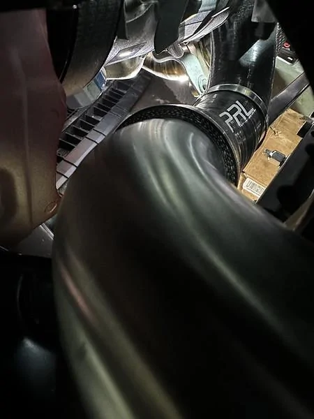

From the RHS the silicon PRL hose connects to a mandrel bend which then connects to the silicon hose at the intercooler as per below:
11th Gen Honda Civic Gambit intercooler kit FL5 i-SjT8KFZ-L

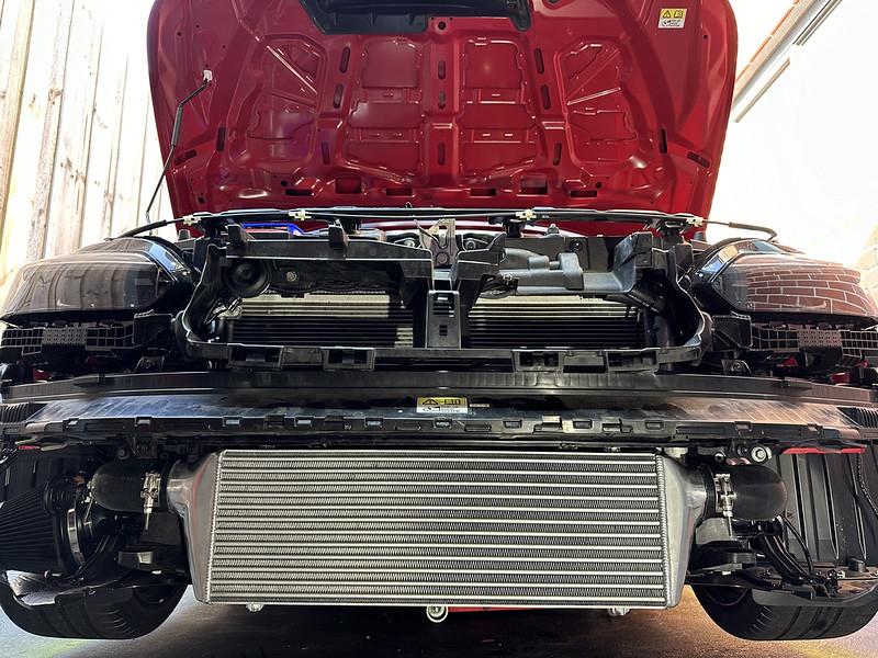

With the front bar back on there is plenty of clearance for the intercooler:
11th Gen Honda Civic Gambit intercooler kit FL5 i-MNz6dzh-L

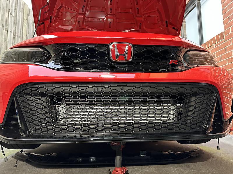

I was not happy with the gap between the sides and the intercooler so i made up an air guide shroud from carbon fibre sheet to help direct airflow to the intercooler:
11th Gen Honda Civic Gambit intercooler kit FL5 i-Bp7fNKS-L
All mounted up and the fitment is great:
11th Gen Honda Civic Gambit intercooler kit FL5 i-jKGJrqW-L

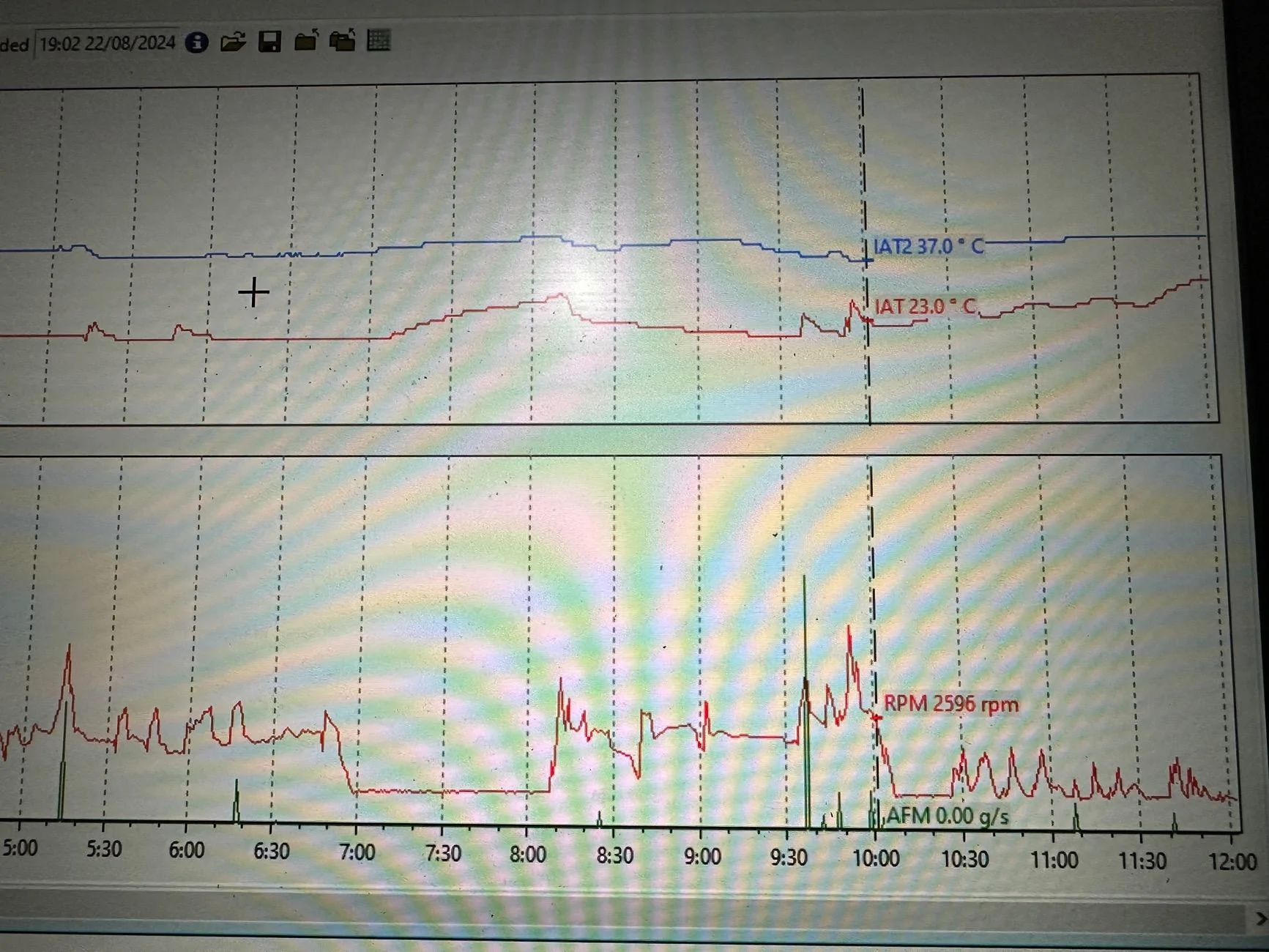

The jury is still out on the full impact on IAT and IAT2 as i am also running my Gambit intake kit. On the road vs on the dyno vs on the track may produce different results, so i need to continue data logging and validate what it is doing across all conditions.

Very cool! Most of the IAT differences will be appreciated at speed. On a dyno or standing still it will creep up like everything else in this car temp related.

Thanks all. I’m only just learning Hondata as only recently had it installed. This is first initial logs, have since updated to the beta version and need another clean logging session when time allows as seeing funky things with some sensors showing and others not. So take with as an initial view.
