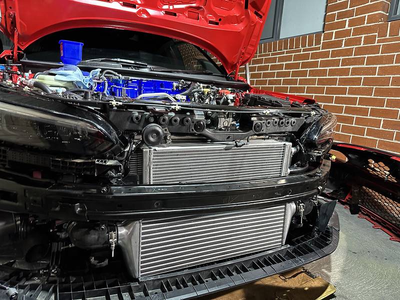

I’m at it again and wanted to share another open source style kit. I’ll call it “Gambit’s FL5 secondary radiator kit”. :cool: DIY and build it yourself and hopefully improve and make it better. Lots of inspiration from Driven Crazy and their Hyperthemia kit on the FK8.
Again the benefit of this DIY kit for the community is that all parts are available on ebay or universally available online. You can mix and match whatever parts you have spare such as silicon or rubber hoses, clamps, pipes, brackets etc to make it work and all at a very cost effective total price.

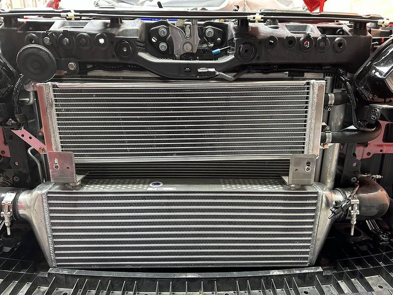

This is the kit installed in front of the primary radiator. I have not had to cut or drill any additional holes for the mounting points, rather just used existing mounts to fix a straight mending bracket direct to the secondary radiator.
11th Gen Honda Civic Gambit secondary radiator kit i-q6QQLjQ-L
The secondary radiator is an off the shelf ebay item from ASI as linked all below in the itemised table.

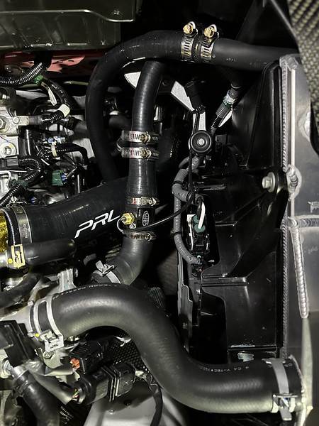

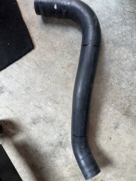

I have run the secondary radiator in serial, post the primary radiator. The top factory radiator hose is untouched, however i have cut a section out of the factory return hose to the thermostat and routed in the secondary radiator and its return back into the engine.
Picture of where i cut the factory bottom radiator hose:
11th Gen Honda Civic Gambit secondary radiator kit i-9f9DQXT-L
I have then gone about installing another water temp 1/8npt sensor fitting with 32mm male hose ends. Which mates nicely to the factory hose end. On the other side i have added a silicon reducer that steps down from 32mm to 25mm and then connected a copper straight coupler fitting to attach a 19mm silicon hose that routes into the 19mm hose ends on the inlet of the secondary radiator. From the secondary radiator outlet i have added the 19mm silicon hose, another 20mm copper coupler to the 25mm to 32mm silicon reducer and then into the engine block.
11th Gen Honda Civic Gambit secondary radiator kit i-kfr8T79-L
Thankfully it all works with no leaks and no kinks that impede coolant flow.
Here it is with the crash bar on too:
11th Gen Honda Civic Gambit secondary radiator kit i-3ckR5gc-L

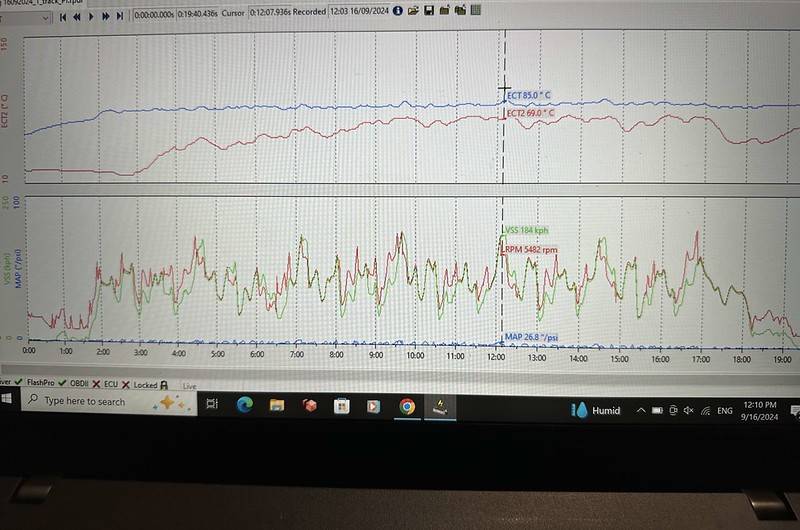

On a recent track day in combination with the Gambit oil cooler kit, ECT1 and ECT2 (with ECT1 &2 sensors in the factory locations) looked great with ambient temps at 13~ celsius.
Now i hope you have a go at the kit and please share your results or any other similar approaches to cooling.

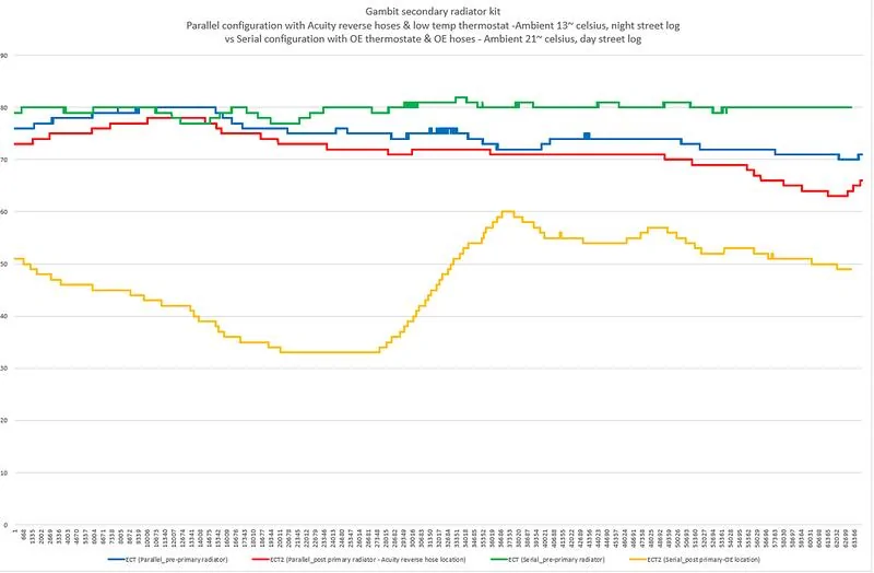

Yes the secondary radiator run in parallel took a lot longer to get ECT 1 temps to a stable level.
Indeed, what you see in the pic above is my ECT3 sensor which is post secondary radiator and before the engine, yet to be logged.

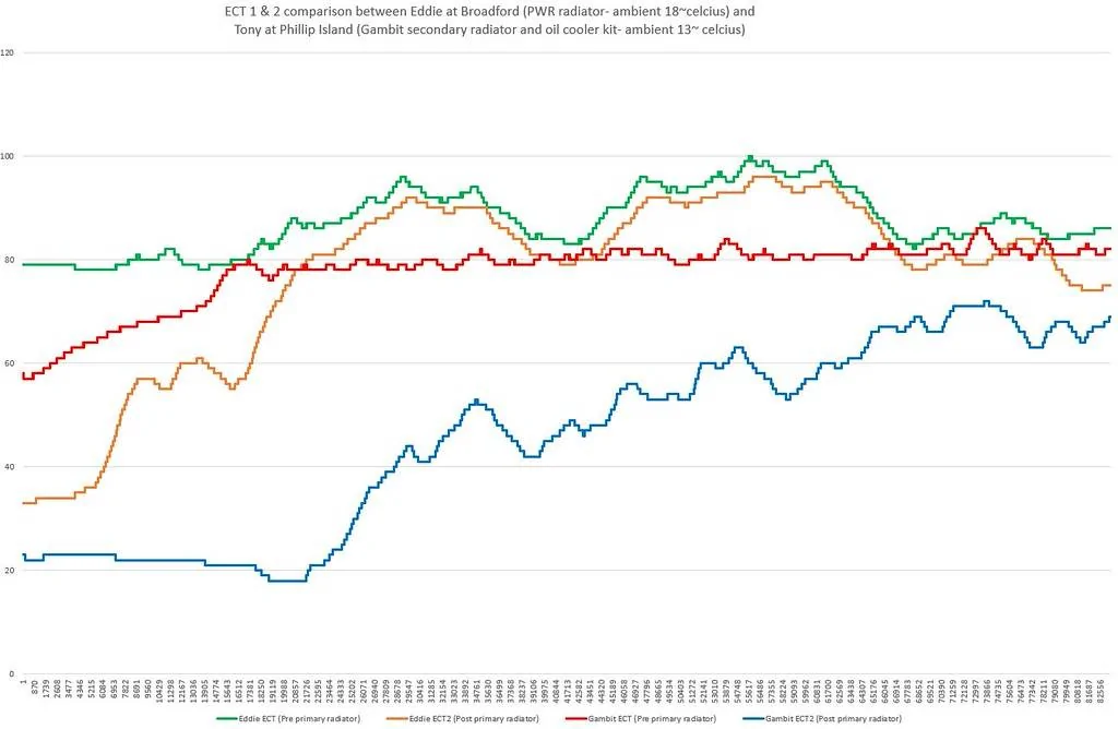

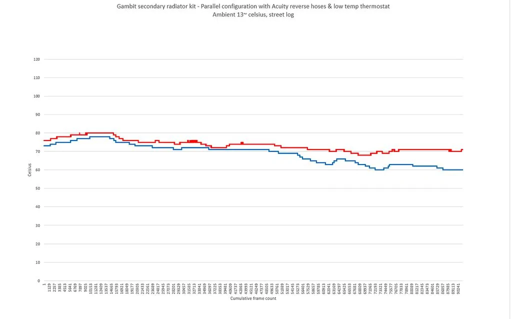

Have a look at this chart, which depicts a recent track day i had at Phillip Island with the data overlaid from another FL5 that ran at Phillip Island. Unfortunately we were not there at the same time, but what i have done is aligned the data the first frame post VMAX on the straight to somewhat estimate what both systems are doing in totality in order to recover from the last pull.
11th Gen Honda Civic Gambit secondary radiator kit i-RqkZkSv-XL
I never got a chance to test the secondary radiator parallel configuration on the track, however i do have a datalog on the street in similar ambient temps of 13~ Celsius. Joel from driven crazy (developer of the hypothermia kit) dyno tuned my car in person and looked over my parallel secondary radiator configuration and seeing first hand data suggested changing to a serial configuration. What can be seen between the two setups is how large a difference the delta is between ECT1 and ECT2.
11th Gen Honda Civic Gambit secondary radiator kit i-vfsmthB-XL
However lets go another step and overlay a street log of the serial configuration on top, albeit log taken during the heat of the day in much warmer ambient temps, over similar roads but with more traffic.
11th Gen Honda Civic Gambit secondary radiator kit i-R5rffmf-L
The difference between a parallel and serial implementation of a secondary radiator setup is up for debate on which is more efficient. Ideally you would want to test both configurations against each other on the same track on the same day to truly determine which was more efficient.
However and overall when comparing at the roughest approximation the difference between 'no' secondary radiator and 'a' secondary radiator on track, without a doubt a secondary radiator setup delivers much lower and consistently lower ECT 1 temps, even when giving it a beating on track.
