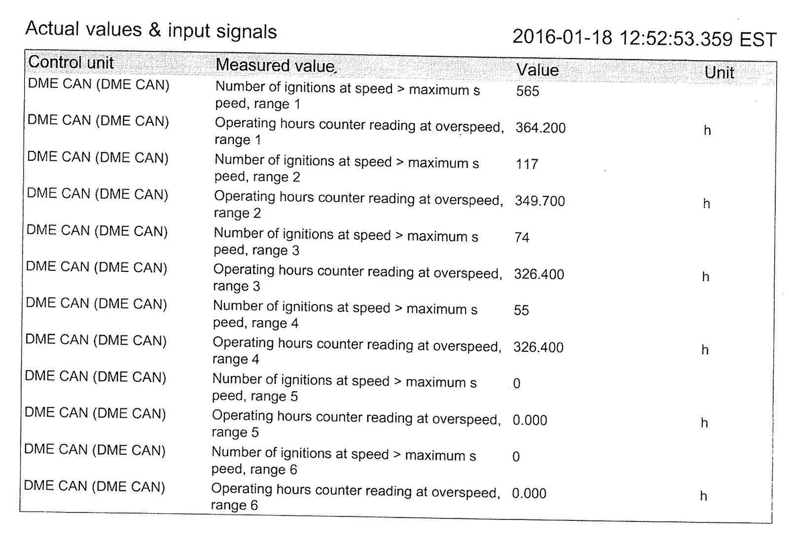

It's always a risk. People who have actually done serious damage to their cars ALL thought they were master manual drivers as well, and I'm of the mind that it happens more often than people think.
I'm not sure about Honda dealers; anytime I've expected anything from them I've been disappointed. But from my Porsche days, you can ask the dealer to run a "DME report". I think that terminology is specific to the Bosch ECU in VAG products, but it looks a little something like this:
11th Gen Honda Civic Fourth to third shift, 75ish MPH 1735563864732-ak
It is a 100% necessary procedure when buying any used Porsche manual. Basically, anything over a range 3 is sketch, range 5 and 6 are pretty much just walk away. Perhaps there is a Honda equivalent.
There is one sure way to eliminate the risk.
what do the "ranges" mean? Is that revs over the rev limit?
edit: nevermind. i looked it up.
https://911virgin.com/engine-revs/
afaik honda only records overspeed events over the rev limit but maybe a Honda tech can chime in
