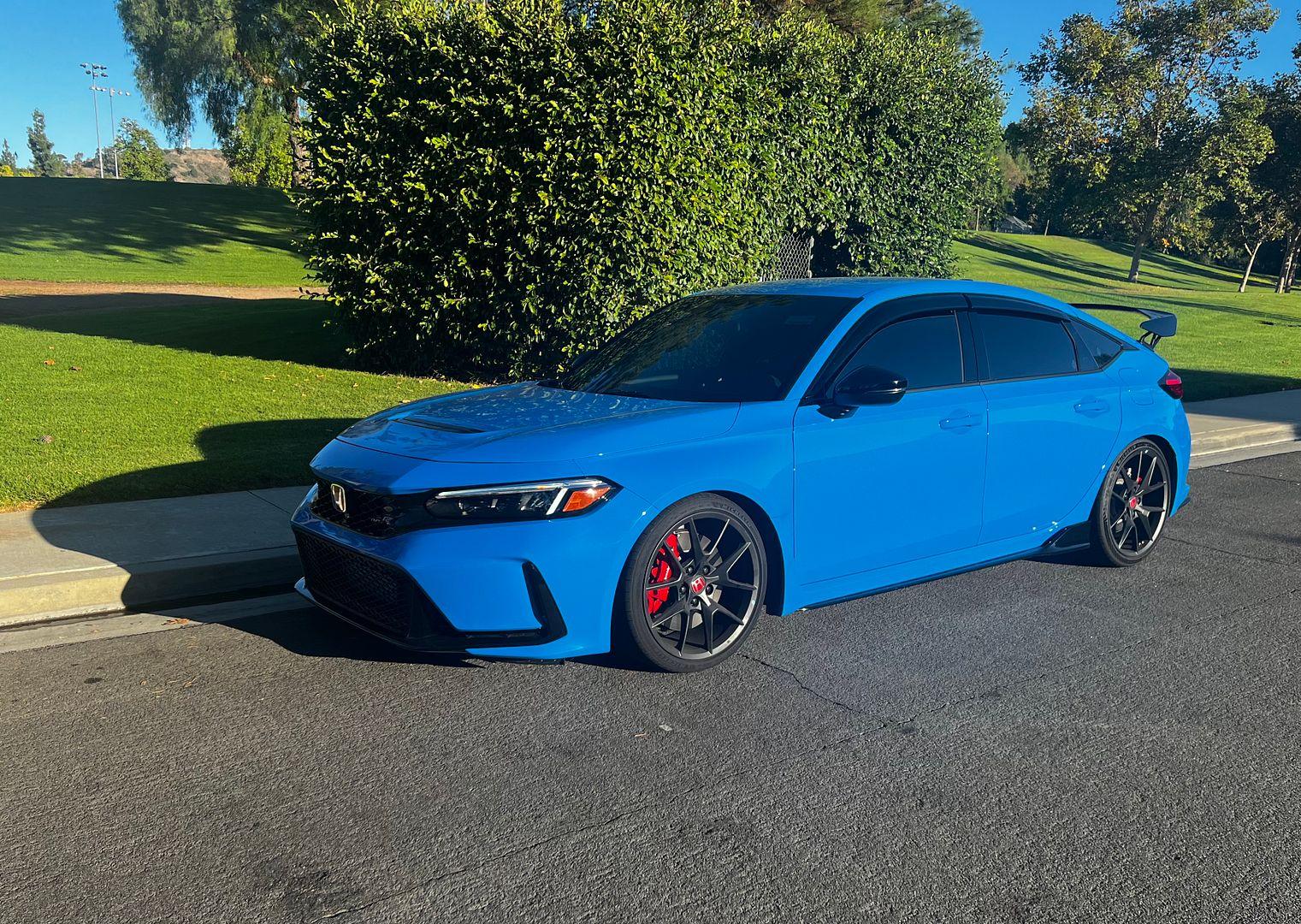

I got mine install and it makes noise. I had a reputable installer. I called swift and they told me wait a week and call them back.

I drove it again this morning and the noise is more. Also notice the car now doesn’t like to be in comfort and need to be on sport or higher.

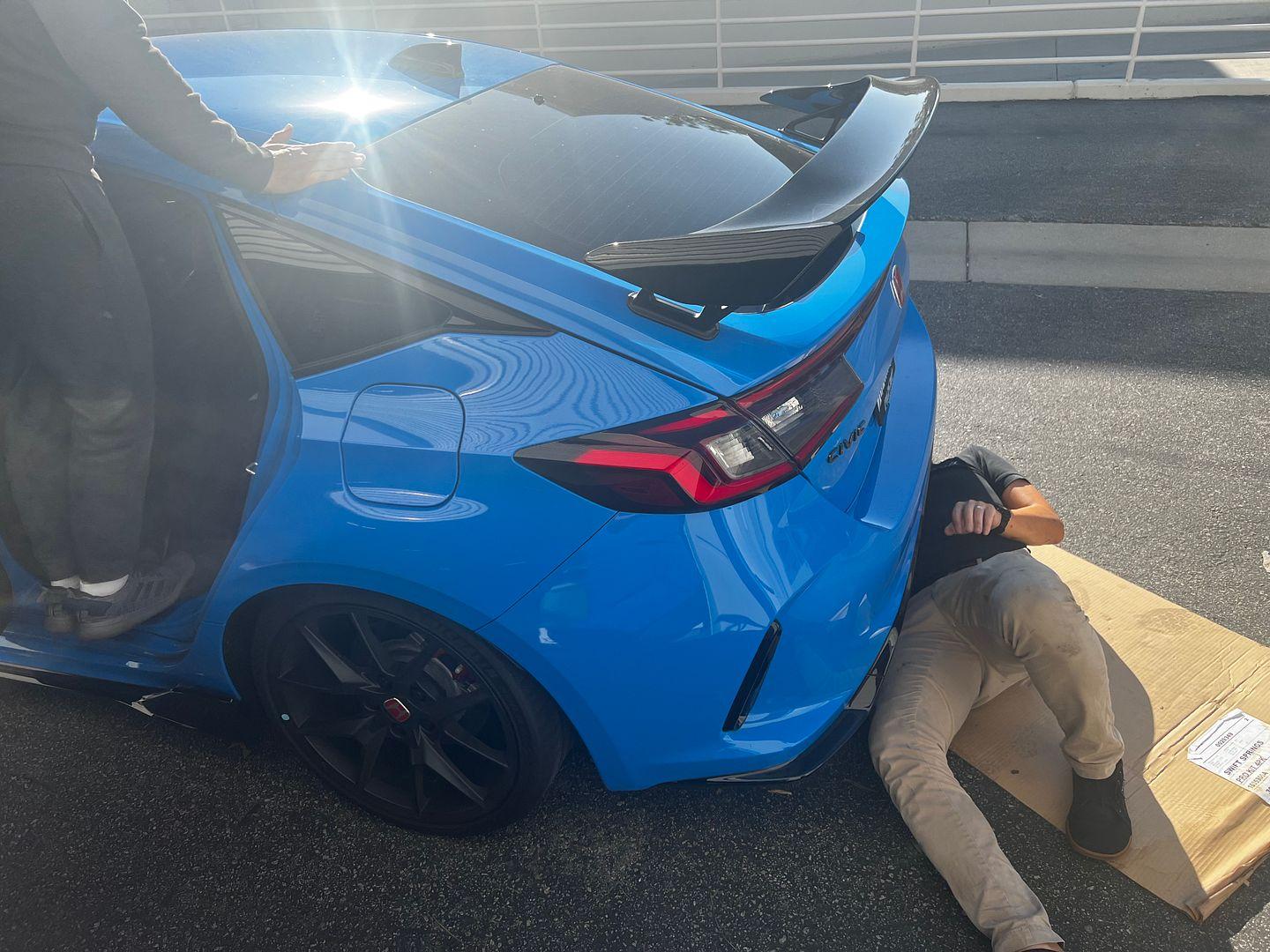

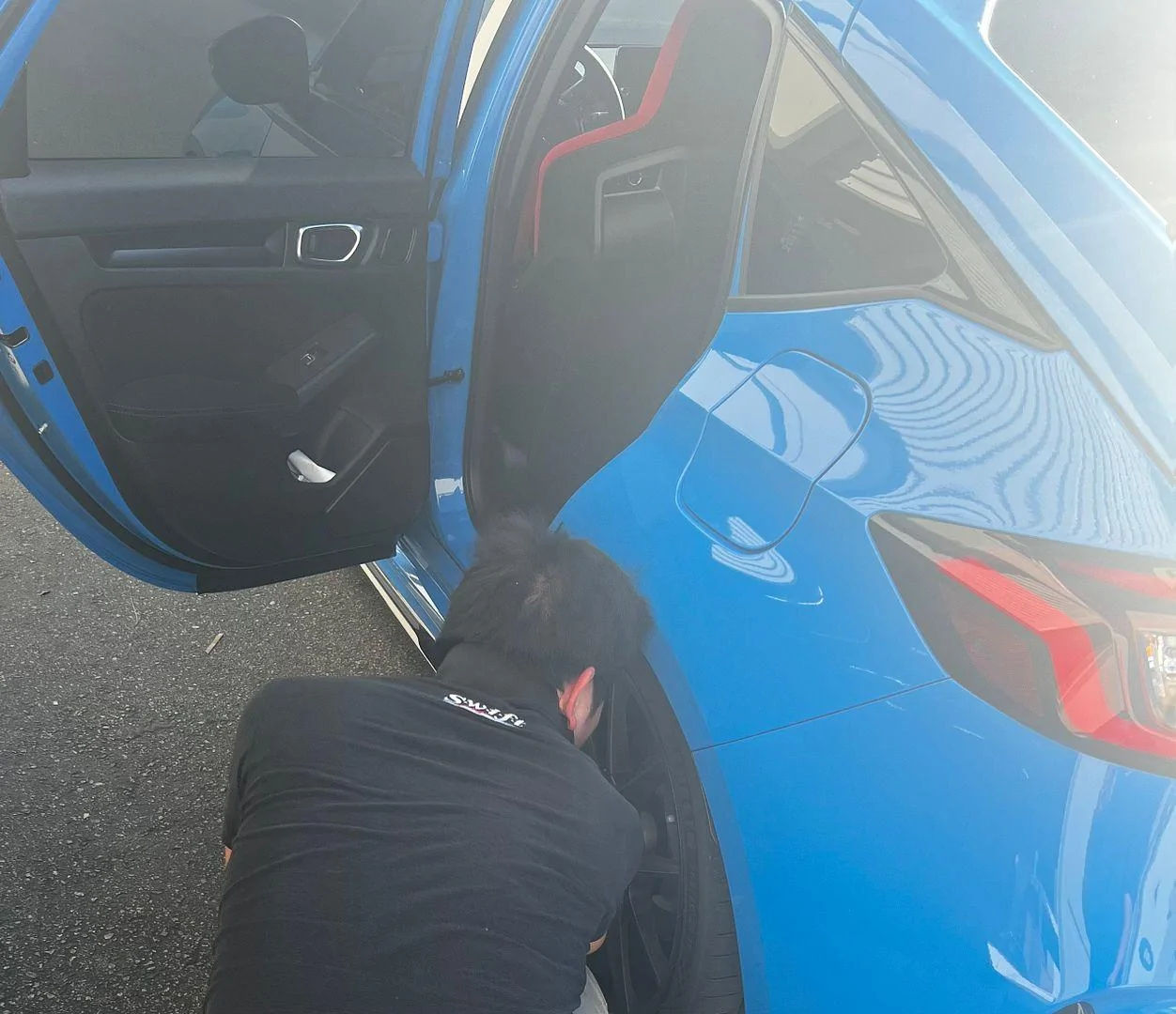

More as it something hitting but noise is faint. I called evasive and my sales rep Josh got Swift to contact me and going today to troubleshoot.

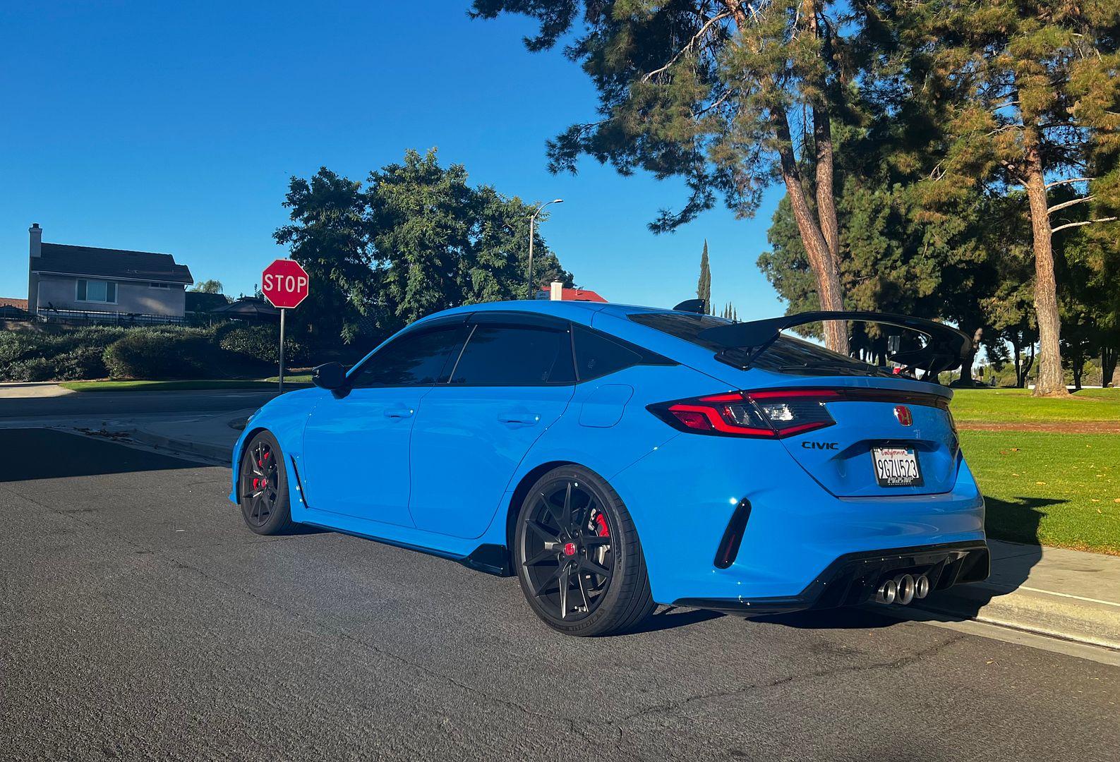

so I went to Swift shop to trouble shoot the noise. It ended up being the sway bar link was loose. It was tighten down and it resolve it. After driving without worrying about the noise I was able to give a better impression. The car now has better initial turn in with a more feeling of rear bias. I normally drive on comfort but it was too bouncy and under dampened for that setting. I put the sport mode and feel better but still continue to feel under dampen. I try to type r+ and work well with it but almost feel like being on coilover. I choose now to keep on sport mode for dampening. Swift was great customer support and nice people that work there.
