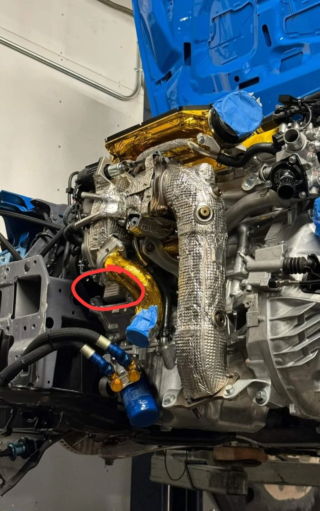

ah got you! Have not seen the underside of the car yet since my last oil change was done when intercooler was installed and I was not there.
Turns out I am mistaken. The K20C1 does indeed have an engine oil/coolant heat exchanger but unlike K series of old which had it as a sandwich plate at the oil filter housing, rather it is located just under the water pump! Which is only inches away from the scalding hot turbo along with the the main water pipe that runs behind the turbo in front of the engine block. God knows the reasoning behind all this...
See red circled in the attached photo:

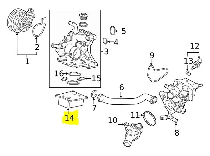

Part #14 (highlighted in yellow) in the below exploded diagram:
11th Gen Honda Civic FL5 Overheated on Track Cooler Engine Oil

Turns out I am mistaken. The K20C1 does indeed have an engine oil/coolant heat exchanger but unlike K series of old which had it as a sandwich plate at the oil filter housing, it is located just under the water pump area! It is located only inches away from the scalding hot turbo along with the the main water pipe that runs behind the turbo in front of the engine block. God knows the reasoning behind all this...
