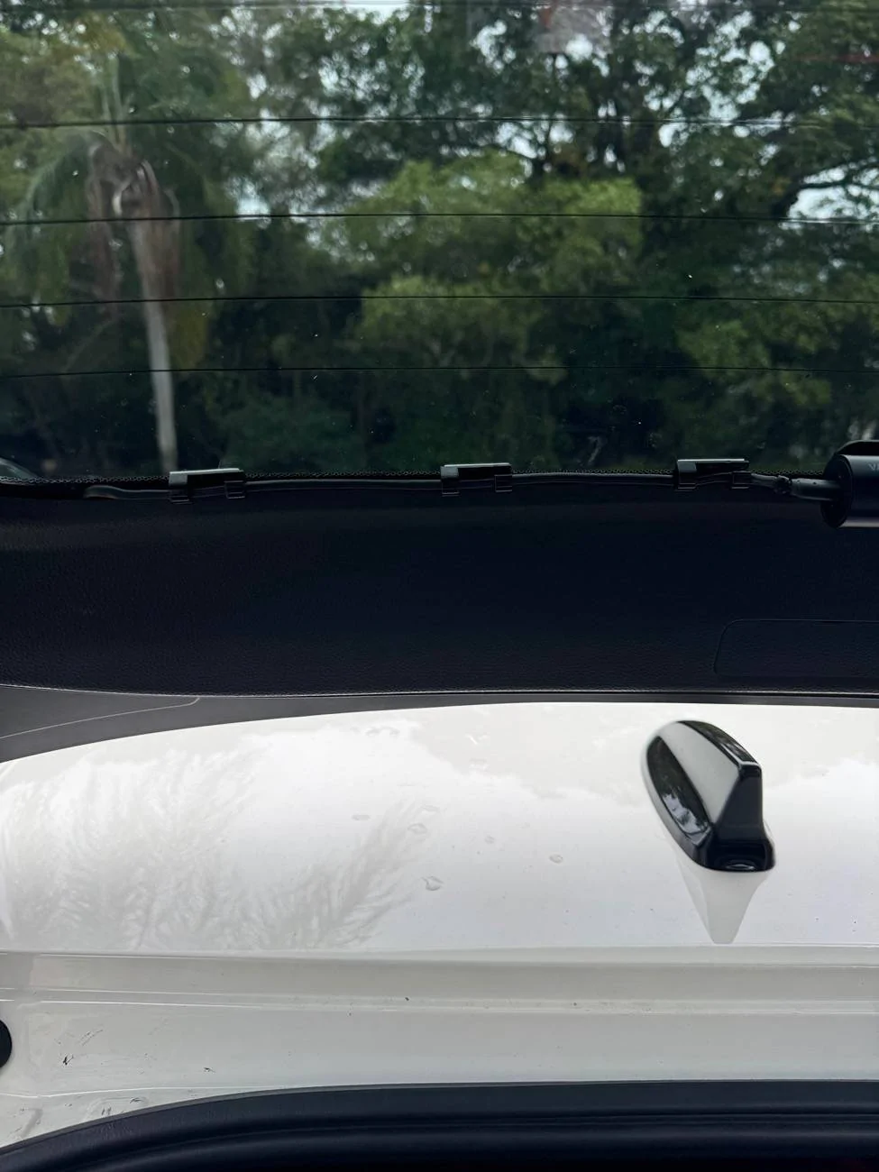

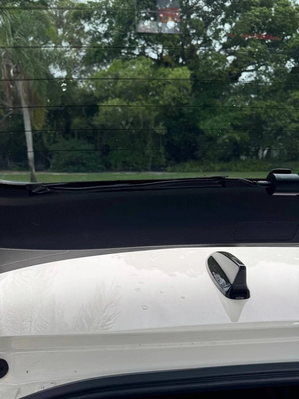

Well here it is. Definitely a cleaner look and you can’t see it when you’re looking at your rear view mirrors. Just gotta see how long the 3mm tape with stands the Florida heat.
nice, thanks for sharing !! my electrical tape is still holding up but it hasn't exactly been hot since I installed the dash cam a month or so ago (getting there on some days though)
