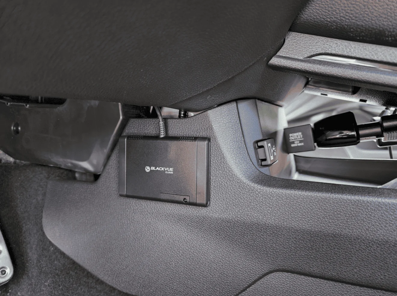

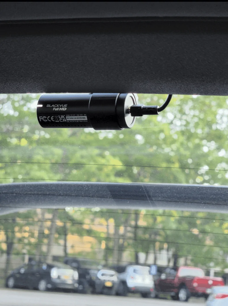

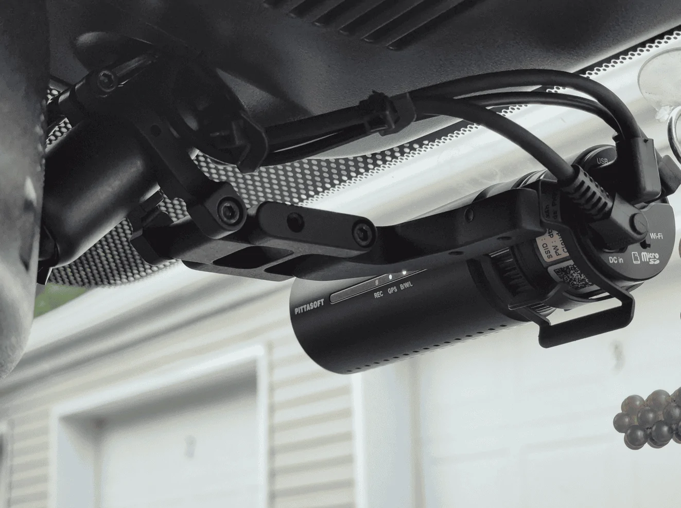

I had the DR900X-2CH Plus 4K UHD-FHD installed with the detached LTE module in my FK8. There's also a non-LTE version of the DR970X-2CH Plus if you want a smaller, more discrete form factor for the front cam. Then you could just connect the external LTE module to the cameras.
Blackvue cams don't record the crispest videos (still pretty good), but I believe they have the best overall cloud solution. Vortex Radar YT channel does good reviews of dashcams, but I haven't checked them out recently.
Not sure if they made some updates and improvements since the 900 series, but a couple of zonks with these units. There should be a time delay before the car enters parking mode, since closing the door triggers the impact sensor. I think a better solution would be to use Bluetooth range with your phone to turn on/off parking mode, automatically. Also, the motion detection needs more sophisticated algorithms; it's next to useless since you're constantly receiving phone notifications from any kind of movement.
