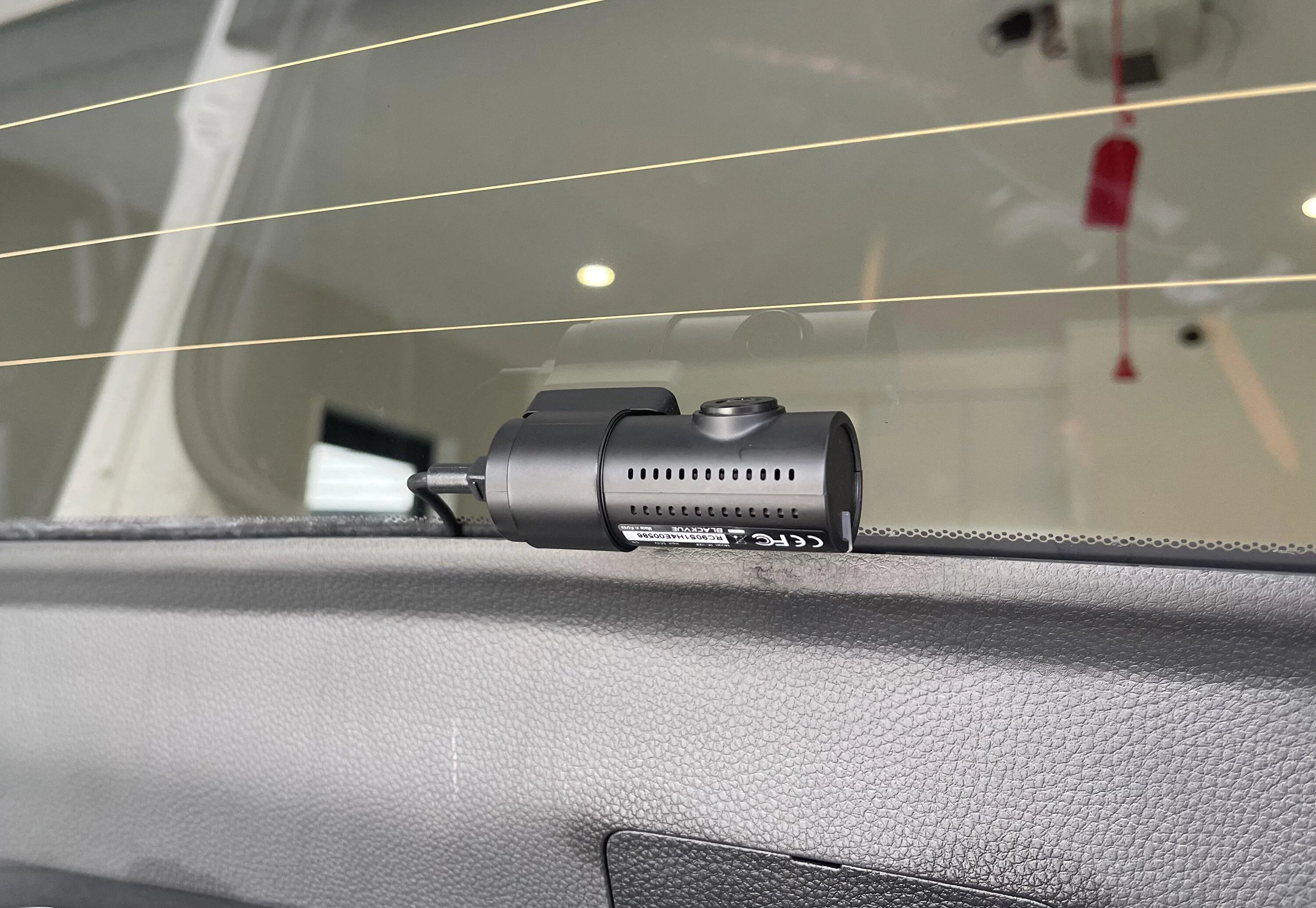

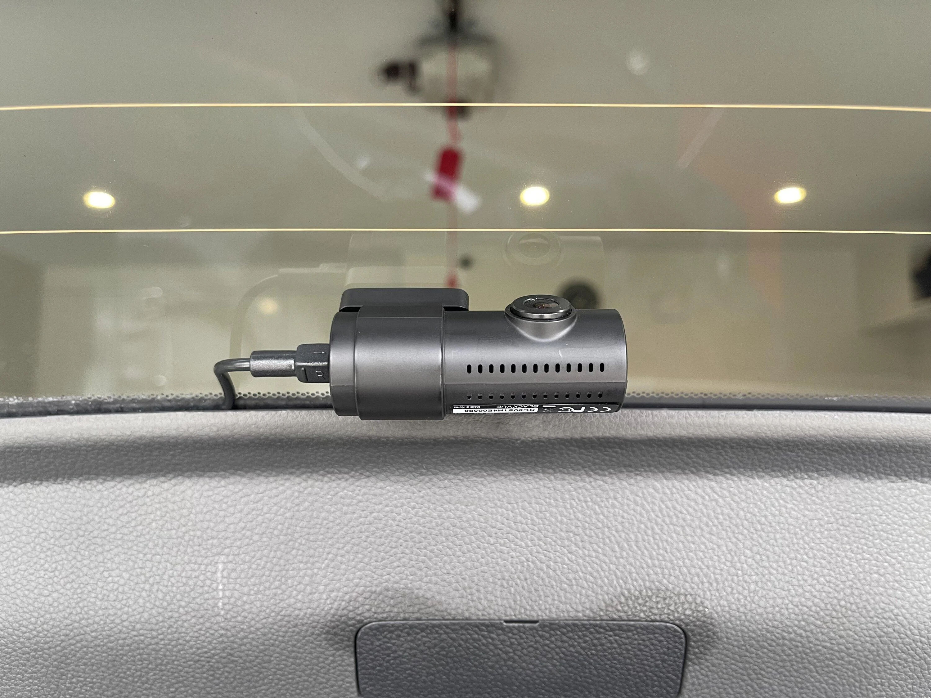

So you were able to route the wire through the wire shroud that connects the cabin to the hatch? And then through to that nozzle cover? Did you use any tools besides the endoscope?
I want to tackle this project and so far, your install is the cleanest.
This is how I tackled mine for the rears:

More pictures of the rear

So I decided to try this and it went somewhat well. I was able to get it installed and working but ran into a few bumps. I wasn't able to hide the wire on the final piece of trim on the hatch. There just didn't seem to be enough space for the wire to fit in. I tried the double prybar method but I got nothing.
I ended up using a couple of the stick on clips to clip on the wire to the window. The other issue I ran into was that I broke off one of the little clips on the hatch panel. Hopefully it doesn't cause any rattling or else I'll have to buy a new trim piece and have the dealership put it on because apparently I cannot.

If there is some left over cabling you can also bundle it up and put it in between the headliner - give that a try and see how you go.

Had the same camera and battery on both the FK8’s and now on the FL5 - was a relatively straight forward install except the fuse labeled “ACC” was still drawing a current even when the car was switched off. Fuse number 42 was the winner in this instance as it didn’t draw any power (even 0.05v) when the car was switched off.
Still trying to see how to position and wire the rear camera since the rear trim doesn’t come off for a tidy install.
