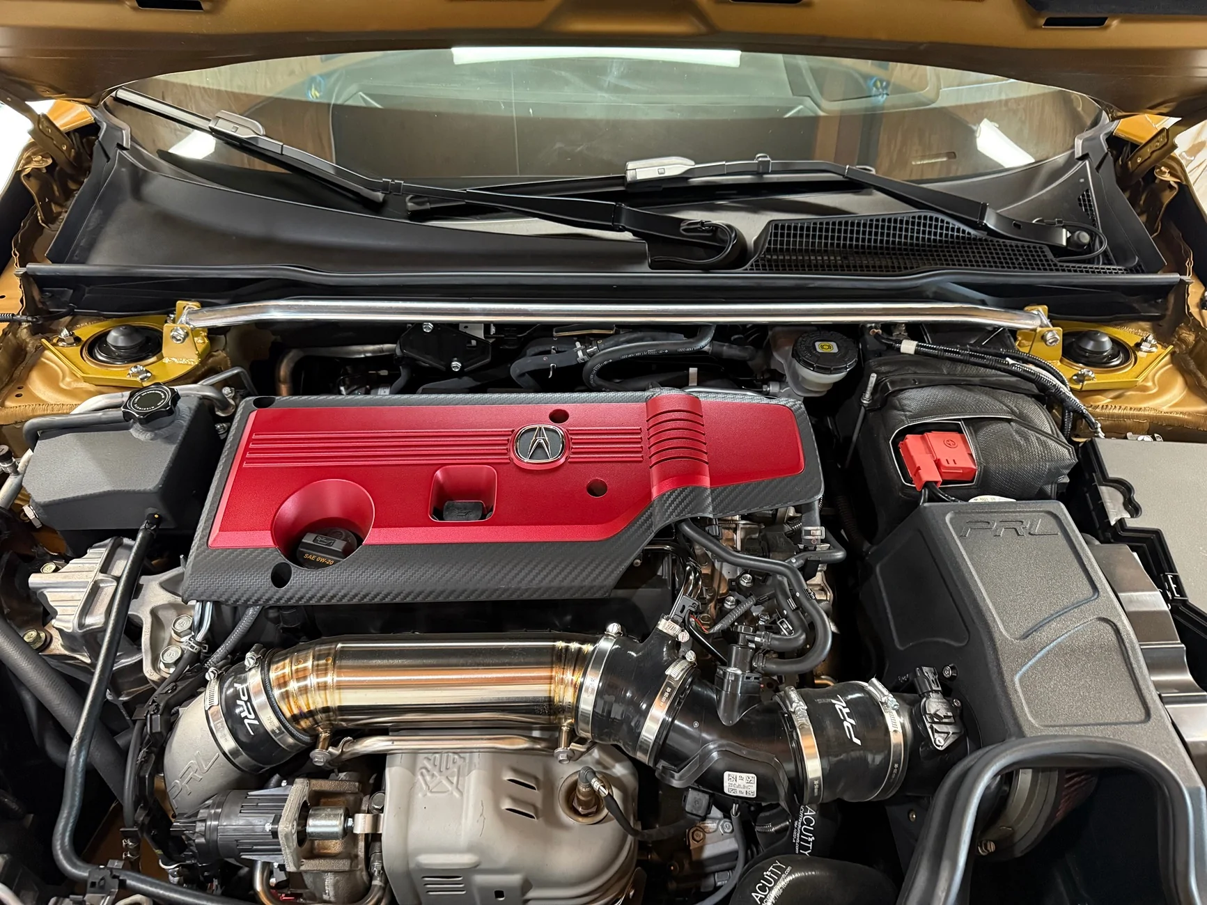

Post a picture of it installed.

I'll install this weekend and share a picture.

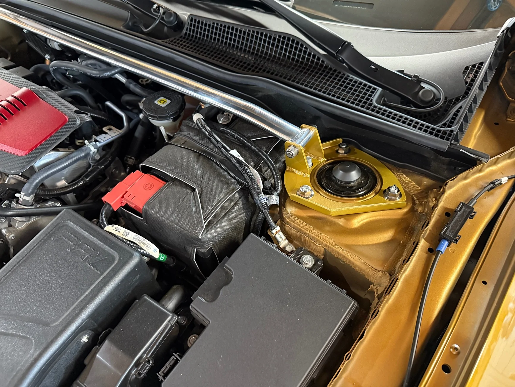

Some photos.
Looks good! Now the real question is, do you feel a difference at all? I see a lot of companies make strut bars and I like them, but for some reason Spoon still does not run one and they are heavily dedicated on the track.
It is a fair question and it was discussed in many forums. I don’t track the car. I have many other mods on the car. I can’t tell how much it adds. Some people said it takes 9 to 9.5.
I like the looks mainly, it’s not very expensive and it does something positive - so, a good mod for me!
I doubt any strut bar will do much on the FL5. You see the strut towers are literally welded to the firewall, which is the strongest structural brace you can have. I can see how a strut bar can help if the strut towers are further away from the firewall. The only benefit that I can see is the mounting bracket providing additional reinforcement to the strut towers themselves to prevent "mushrooming" effect.
The thing I don't like about this J's Racing bar is that it's a hinged design, which means that any vertical motion (if any) in the strut towers will pivot on those hinges, which negate any benefit of having a bar. The 2nd thing I don't like about any strut bar on the FL5 is that you have to remove it every time you need to remove the battery (for replacement or work in that area). But if you like it for the "bling", then I won't blame you for adding one. Some bars are really nice and has tempted me to add one too.
