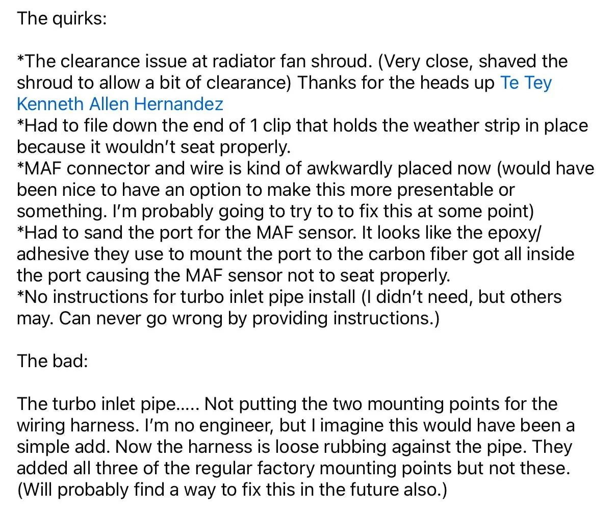

Intake setup looks great but I would be pissed if I spent $$$ while also having to deal with install issues.Infinity Design notes from a FB post today:

This. Paying top dollar for a part with questionable fit and/or finish is a non-starter. And this modifying finished goods, expensive ones at that, stuff is nonsense. Don't you want more for yourself?Intake setup looks great but I would be pissed if I spent $$$ while also having to deal with install issues.
I mean it’s really hard to get carbon fiber perfect. You see it all the time, from hoods, wheel fenders, to wings.Intake setup looks great but I would be pissed if I spent $$$ while also having to deal with install issues.

You pay for the design, engineering, and manufacturing. What makes you decide what you want to pay for is subjective; looks, sound, performance, etc. in this case. I was confident the shop I chose to install would be able to execute successfully, and they were. Someone else who is considering installing themselves and wants to know what they're getting into may think differently. I'm happy with the product. I don't personally think it's "nonsense", so I'm also happy to offer a contrary perspective.This. Paying top dollar for a part with questionable fit and/or finish is a non-starter. And this modifying finished goods, expensive ones at that, stuff is nonsense. Don't you want more for yourself?![]()

That installation part you mention is kinda null and void if you're having a respectable shop do it, no? If the gruppeM has less installation quirks than the infinity, then it would be easier for the shop installing the intake. If not, then the same way around, since it's not like you need to worry about getting it put in. To me personally, if I'm paying top dollar for an intake, I expect the people making it have the most of the quirks ironed out. Its like paying the Apple tax, but to get your phone turned on you need to do a screen repair (ie: premium final product for an inconvenient and more than likely impossible task for some people to get to that).Admittedly what actually got me to remove the Gruppe M from my consideration was the fact I didn't want to be the guinea pig for running into unforeseen installation issues on the DE5, as well as I didn't think the shade of red aligned with the DE5 engine bay... but I don't think it's a fair assessment to keep throwing out this implication that because it's from Japan it's "better" in any real sense. In fact, I'd rather run into issues during installation than have it throwing codes until I got it pro-tuned. But that's just me.

When you pay premium prices for 'design, engineering, and manufacturing,' you should expect a product that reflects that investment - meaning proper fitment and high finish quality straight out of the box.
Your shop's ability to successfully modify the part speaks to their skill, not the product's value proposition. A truly well-engineered premium part should install correctly without requiring that expertise in the first place. We clearly part company on these core tenets and that's totally fine.
