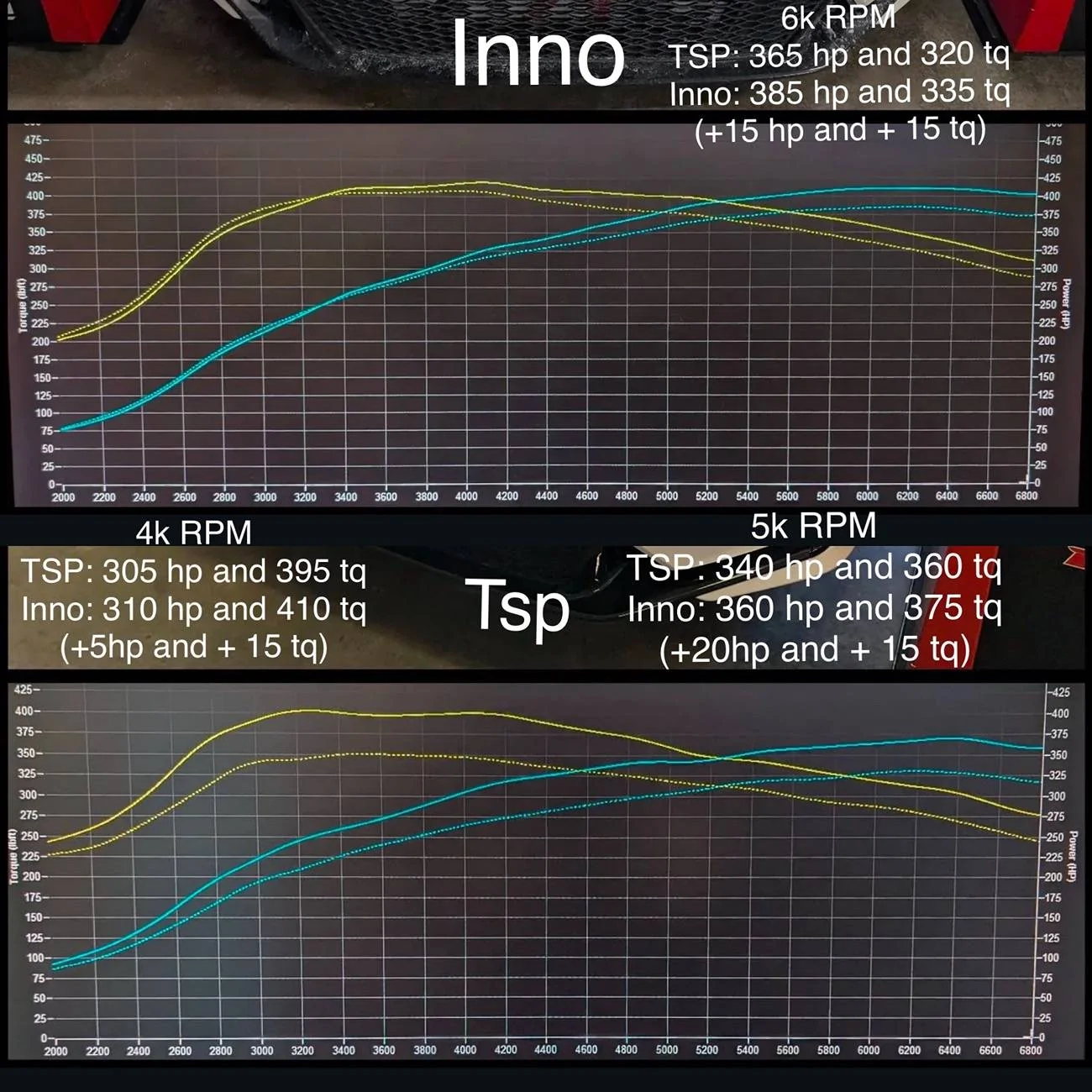

I few people say that downpipe brands don’t matter and “gains are minimal, maybe 3hp from brand to brand.”
Here is a comparison of two FL5s on the same dyno, same tuner and almost identical mods other then one with the Innovatiq catless downpipe and the other with the 400 cell TSP downpipe.
An abundance of dyno graphs have showed otherwise.

Correlation is not causation. :)
I've tuned a bazillion of these things, and I can tell you with a high level of confidence that the difference between most catted vs catless downpipes is so minimal, it's not even funny. The bigger factor on your comparison is how far we were able to go before running into the knock limit of the particular engine and fuel quality.

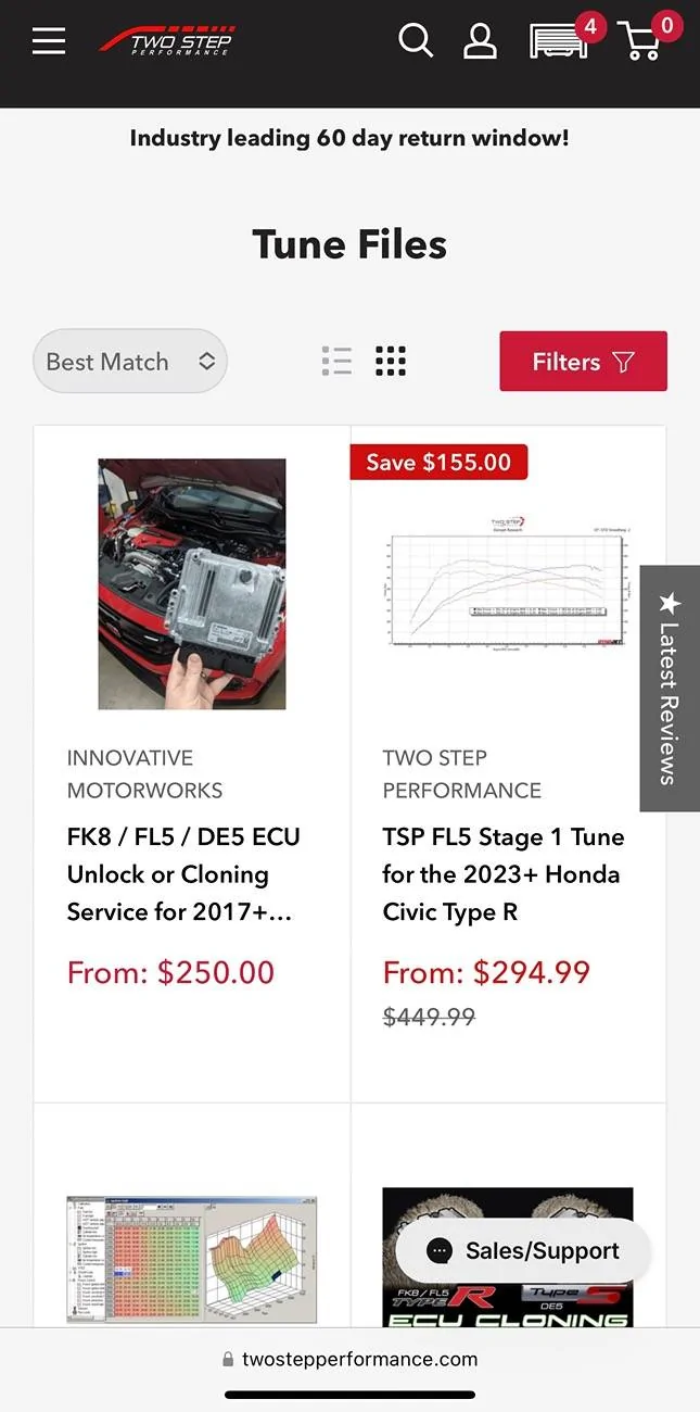

First off, I love and respect you posting your dyno graphs! It’s helping me with my build.
Like Cueyo said, can you quantify some of your data on a graph?
Because I have noticed after looking at roughly 100 of your posts, that some downpipes seem to make a noticeable amount more hp/tq across the whole graph then others almost every time.
I know you work with Two Step Performance which is a great company with a great Downpipe that you support.
I, along with others would love and appreciate some hard data that shows that all downpipes are similar. Because 20hp/tq is a little more then minimal I think most would agree.
IF you don’t mind and have time.

Not to be rude but Derek has essentially already answered by saying the cars are typically limited by fuel quality (and not exhaust flow). There are a TON of variables in play here. Comparing different cars using different fuel ends up being an apples to oranges comparison.
