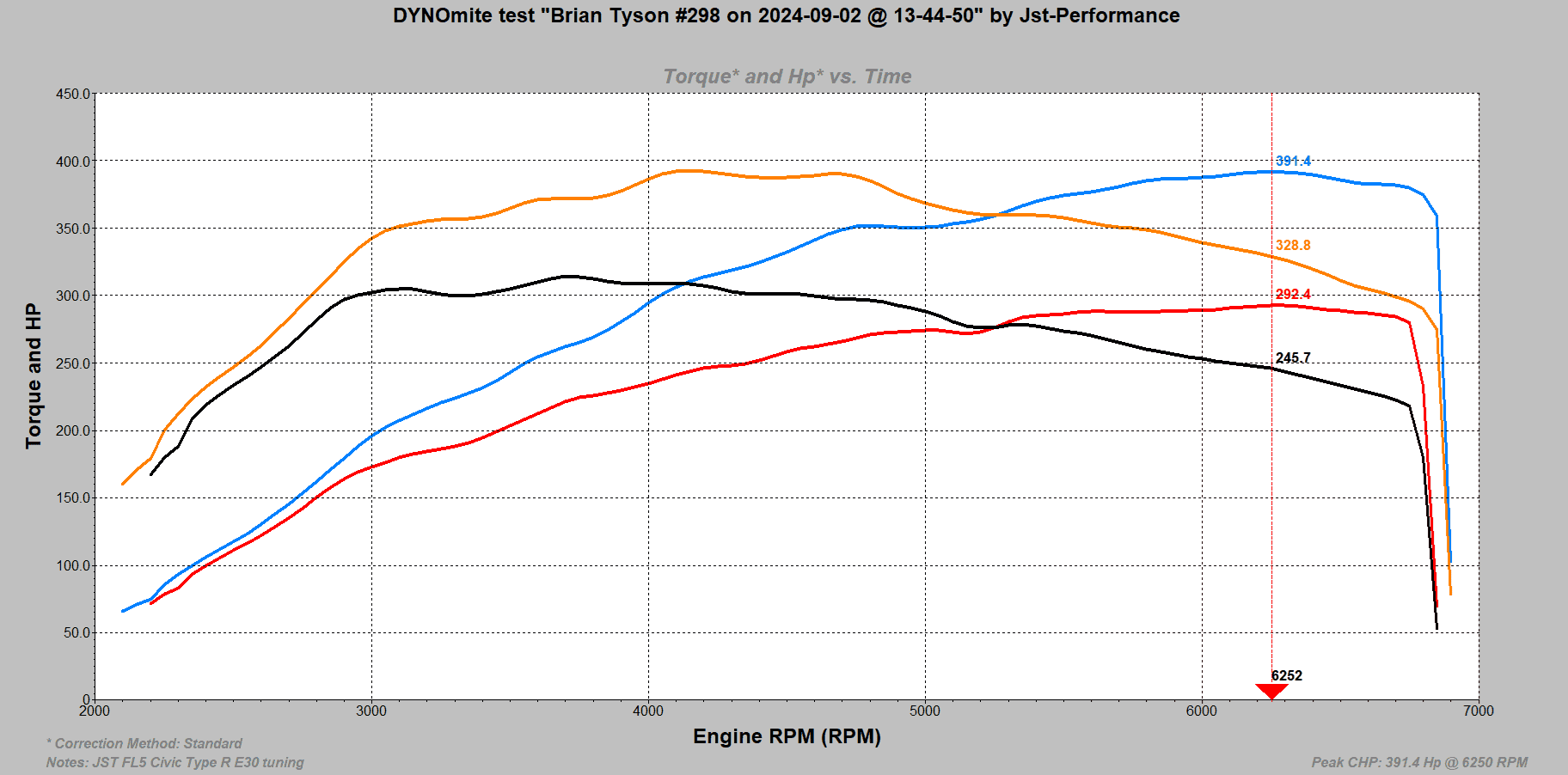

We have been doing extensive testing and tuning on our shop FL5 for the past month using Cobb Software and the Cobb Accessport.
We are currently sitting at pretty much a dead even gain of 100WHP over stock with only a PRL intercooler, E30 fuel, and our custom tuning Via the Cobb AP. ( check dyno chart below).
We will continue to push what we can using this software, but so far i can say im very impressed. Especially for the short amount of time that Cobb support has been released for these cars.
on top of the things that come on the Cobb OTS maps such as Launch Control and Flat Foot Shifting , I have already figured out Ethanol tuning , upgraded fuel system tuning, Boost by gear, power levels/ boost by gear per drive mode, and a few other things.
Look for more posts in the near future, We actually have just signed up to be a Forum vendor a few minutes ago.
