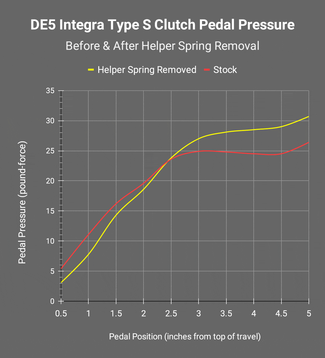

This seems like an awful lot of work to make the car subjectively better.
Wild to me that people will talk about a subjective difference when I went wayyyyy out of the way to provide objective measurements utilizing a load cell and then published the data for free.
Purely math here, Pearson's correlation coefficient or "r".
For the stock setup, r = 0.89
For the modified setup, r = 0.94
0 is completely non-linear, and 1 is completely linear.
So mathematically and factually speaking, the clutch pedal pressure curve is more linear with the helper spring removed than it is stock.
Speaking subjectively, is it your subjective opinion that a clutch pedal feels better the less linear it is? Is that the argument you're going with? In that case, can you argue why installing a heavier helper spring wouldn't make the clutch pedal feel better?

Okay so I just have to repeat myself:

I'm just gonna stop engaging, I never said a heavier spring was better.
I'm asking you to argue a conditional hypothetical in support of your subjective opinion that clutch pedals feel better when they're less linear. I didn't insinuate that you ever said that a heavier helper spring would be better, what I'm saying is that if less linear clutch pedals feel subjectively better to you than more linear ones, then it follows that a heavier helper spring than stock would make the clutch pedal feel subjectively better than stock by decreasing the linearity.... unless you have some argument to the contrary that somehow doesn't contradict your previous statements?

You used the example of one of your other manual vehicles, which is a manual Tacoma. It does not have this clutch pedal helper spring, and it feels natural to you.
After seeing your chart and watching your video (great job, by the way), it does make sense that the DE5/FL5 feel perhaps unnaturally smooth in clutch pedal travel.
[snip]
Out of all of these vehicles that I have owned, the ONLY TWO that I ever felt had "heavy" clutch pedals were the '94 Caravan and the 2005 Forester XT. The "T" stands for "Turbo", and for some reason, that XT had a really heavy clutch.
So I want to be as clear as possible on this point: the pedal feel and the pedal weight are only tangentially related. This purpose of this exercise was not to make the clutch pedal heavier, that was a side effect. The clutch pedal is still among the lightest of the higher-performance cars I've ever driven. It was already light and a 16% increase isn't going to make a light pedal feel heavy. A 16% increase certainly isn't going to make my wallet feel heavy. ?
The clutch helper spring pushes in two different directions on the pedal depending on how far you push it down. This causes the clutch pedal to behave differently at different points along the full range of motion. This is not intuitive behavior, and when you're trying to *rapidly* find the perfect bite point on the clutch for a given situation, it's just a disaster.

The FL5 CTR is definitely the lightest clutch pedal I have ever used, and it must be due to this dual action spring. However, if removing the spring only increases pedal "up force" by around 16%, then this clutch pedal would still somehow be the lightest pedal I've ever used. Mind boggling.
Upon seeing your video, I was thinking, "Too bad the spring is so easy to remove, yet so difficult to reinstall". If the exact opposite was the case, then I would probably want to remove the spring. That way I would know the difficult part was finished. Then, If I ever wanted to return the car to factory, then I could just "pop the spring back into place". As it stands, that is just a fantasy.
The whole requirement to go through the firewall in order to reinstall the spring seems a bit much.
This leaves me with the question...
Is there a way to "wear in" this spring, particularly on the back half of travel, where the pedal is closest to the floor? Can this be done without excessively wearing the spring at the front half of travel, so that the return-to-zero assist remains intact?
The idea is to get that 0.89 ratio closer to, say, 0.91 or 0.92, rather than the full 0.94 "natural" ratio.
It wouldn't be a "spring fully removed" feel, but it would be as close as possible. Perhaps instead of making the clutch feel 16% heavier, "wearing in" the spring could make the clutch pedal feel about 9 to 10% heavier, thus making the entire travel more realistic than the travel with the brand new, stiff, unworn clutch assist spring...?

You'll spend more time thinking about it than it would actually take to reinstall the spring.
The clutch pedal assembly is meant to be worked on/replaced the same way much of this car is engineered.
  • Unplug two sensors.
  • Remove clevis pin to master cylinder arm.
  • Remove three bolts from firewall.
  • Remove clutch pedal assembly.
That's it. It's not hard, it's just hard-er than wedging that spring out of there. You'll need extensions and a universal joint for the top bolt. I considered removing the pedal for the video just to demonstrate the spring more clearly.
And besides, given what you've told me I'm about 92% certain you won't want that spring back in there anyway.
