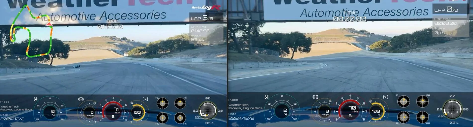

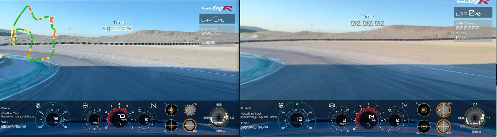

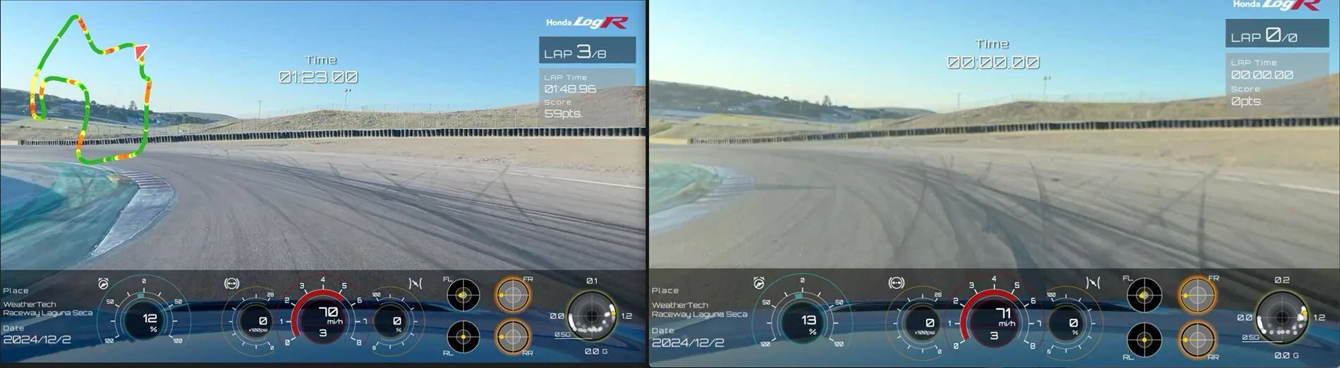

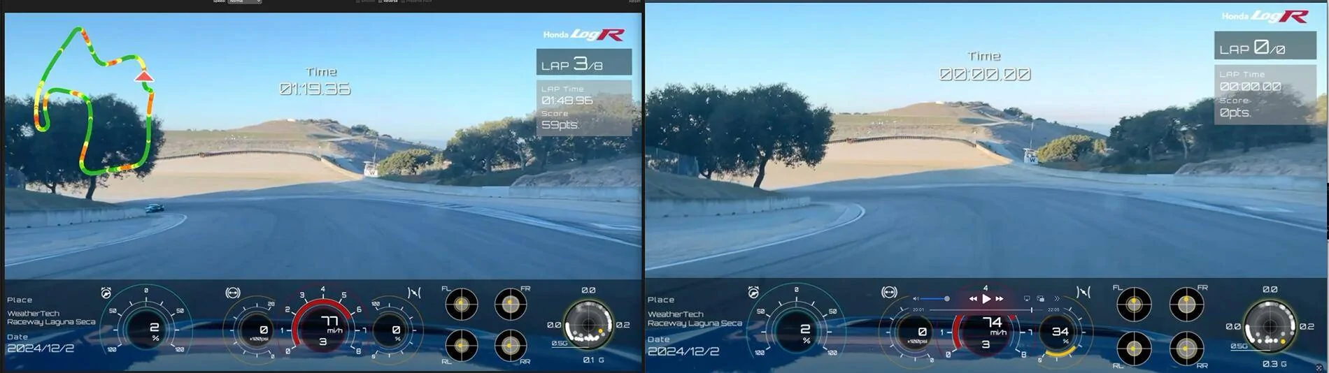

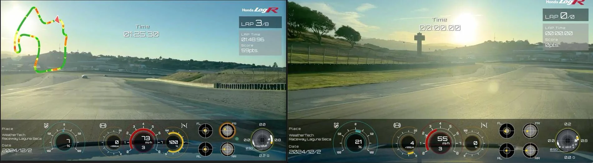

Here is the play by play comparison. Pedal Dance On Left - AHA ( Long Press +R ) on right
I was chasing down the Mclaren driving more aggressively with pedal dance on the left.
It's almost identical, I even have more of an aggressive steering angle with pedal dance vs AHA ( R+ long press )
If I had gassed on AHA ( +R Long Press ) the car would have been fine - It was too aggressive for me as the gas pedal is connected to torque vectoring using brakes. Its braking rear to turn in. That caught me off guard as I was used to the natural dynamics of full pedal dance.
It's almost identical, I even have more of an aggressive steering angle with Long Press vs AHA ( R+ long press )
I have analyzed these slides and have an opinion, but had a few questions.
1. What did it feel like when it happened?
2. Tire and wheel combination?
3. How many laps had you completed before it happened? (what were your lap times?)
johnloov
John
Jul 9, 2024
338
287
happened?
It felt like day and night compared to my previous laps, but the rear just caught. I knew it was aha, that touched my rear brakes. It felt like someone independently touched my brakes in rear without my permission!
I was coasting for 6 seconds no throttle no braking, it felt like the car touched my rear brakes as I turned in and no throttle no braking. My understanding is this is exactly what AHA does it uses the throttle pedal to steer trying to emulate a rear wheel drive car.
stock tires 4s rims - camber pins out. 2mm toe out total. ~38 psi hot front and 35 hot rear nitrogen filled ( helped stability of tire performance )
3. How many laps had you completed before it happened? (what were your lap times?) lap times no traffic ~1.47,1.48, 1.49 ~ 7 laps
Pulled into pits engaged long press / base line was all day pedal dance
then spun it, pitted again - I want to see what the difference was right away while car was hot tires were hot
back to pedal Dance ran it again….
No spin……
I’ll be back at Laguna Seca in 2 days. Will test again and again. I feel more natural with pedal dance, even though I understand a AHA can make you faster. I currently have no problems with understeer in my car so I don’t understand why I need it.
