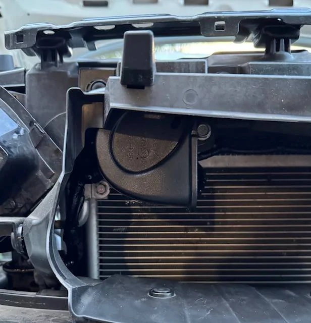

Installed the Euro horns today. I did not use the below brackets after wasting too much time trying to figure out how they were suppose to work without any instructions to reference:
I just connected the Euro horns to the existing stock brackets. Here is the top one:

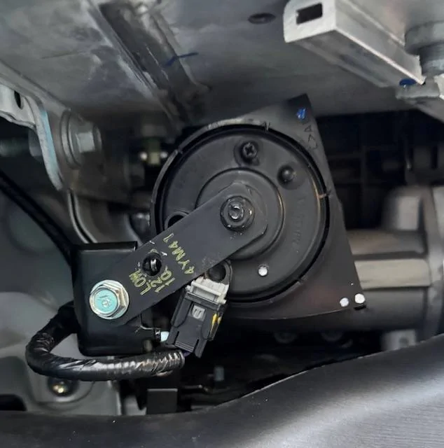

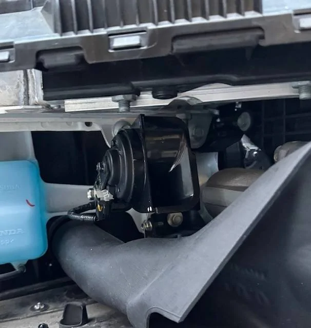

The bottom horn simply needed a minor modification to its bracket by drilling one hole to fit the notch in the stock bracket. Doing this allows for the horn opening to be facing down so as not to collect moisture:
Front view of the bottom horn:
Goodbye to the stock meep meep sound.

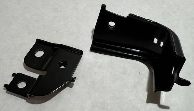

The brackets that come with the kit replace the existing ones that are already on your car.

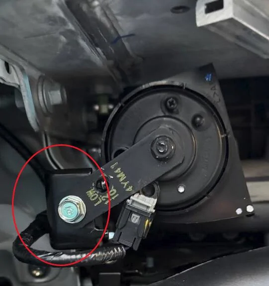

The brackets do not work on the FL5.
You probably buttoned up everything already, but the only thing I'd change is to have the horns face down so water doesn't get into them.
Exits of both horns are oriented toward the ground. Water/condensation buildup is not going to collect on the inner horn area of either one of them.

Weird, its supposed to replace this bracket thats attached to the frame. This lower one was the only one I used since the stock one that came on the car was thinner and I can hear the horn vibrate on a cold start. As long as it works out for you. ?
Thanks...On the FL5, it already has a thicker bracket for the lower horn attachment. The replacement bracket included in the Euro horn kit is shorter and does not extend out far enough without causing interference issues.
