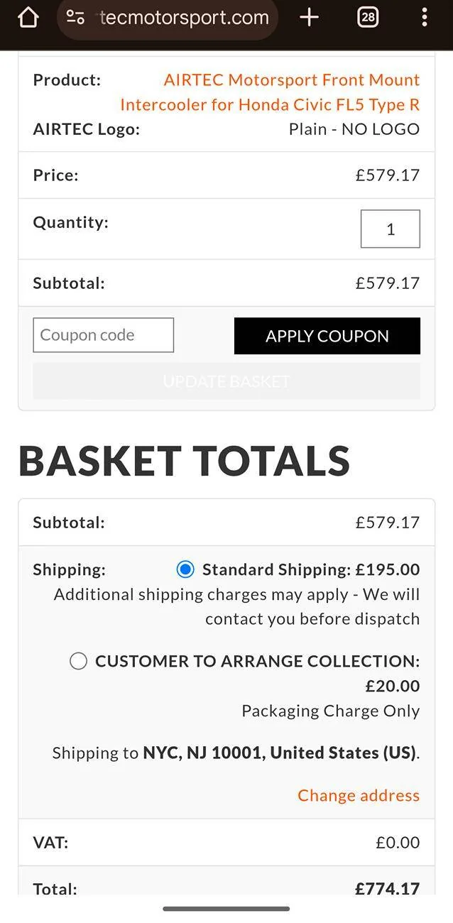

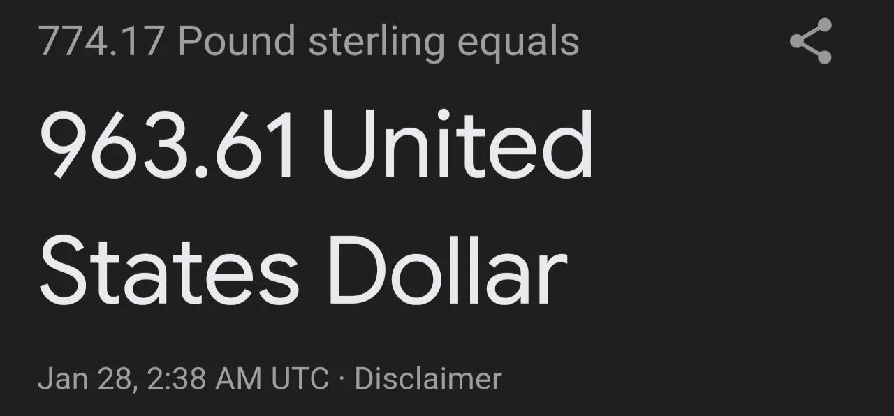

This is inaccurate, I paid $840 for the Airtec shipped to my door, it arrived in under a week. PRL is $860 to $900 depending on whom you buy it from ??‍♂
I just did the math from their website. So how is it incorrect?
11th Gen Honda Civic All the Available Aftermarket FMICs are Bad Screenshot_20250127-214302
11th Gen Honda Civic All the Available Aftermarket FMICs are Bad Screenshot_20250127-213904

Because their website isn’t the best place to buy it sweetie
I was not wrong, but dream surpringsly is cheaper is rare, but shipped is $844 which is still more expensive than the PRL when on discount is about $679
