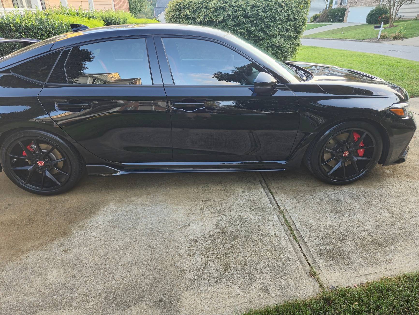

I have 275/35/19 PS4 all seasons on stock rims and stock suspension. I've got about 3000 miles on the tires so far and no issues whatsoever and the tires themselves are excellent. Only thing I don't like is the fact that it lifts the car a little higher. I'm 99% sure 15mm spacers would be no problem with this setup, but you'd need to do some research if you're lowered.
