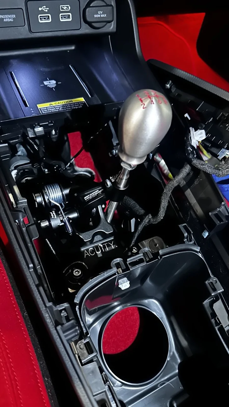

Just got done with the install and initial drive, height adjustment and final drive.
- Install is pretty easy, great instructions, keep an eye on the spring/clip that you have to take off from one of the cables, mine flew into a small hole and went under the carpet. Took a magnet stick and 15m to get it.
- Make sure you disconnect the negative terminal on your battery. The car is very not happy if you don't. Mine wouldn't start until I unplugged the stuff I reconnected, removed the negative, plugged everything back in, and put it back on the terminal.
- I kept the throw settings at stock, and just played with the height. At 4 height it felt a lot like the stock shifter with a slightly longer throw. 1 was too short but felt good (shifts were too tight), 2 didn't feel great for some reason, 3 felt like the stock shifter, and I settled on 1.5 which to me felt very good. (all had a more mechanical feel but the shorter you went, the more mechanical it felt)
The stock spring is good as is, I might adjust the gate a little bit just to see how it feels but it's kind of a PITA to get to once you start to plug everything back in.
Overall, very worth it. I don't think it can 100% compare to the S2000 direct shifter, but for a cable shifter it's very close and for something you touch on every drive it's a great mod for the money.

Do any of the plugs impact the reverse camera? Mine seems to have stopped working since install. Yet to check the fuse to see if anything was tripped.
Mine was still working this morning. My main issue was the wireless key recognition.
After two days of driving with the stock gate positions and the height set at 1.5 I'll say that I'll probably play with the shifter settings a little bit. The shifter feels great when on the limit, but it's really tight, especially 2-3 when just chugging around town.

Had a bit of an after-install event last night.
Car was fine for 2 weeks after the install, but on my drive home last night I did a mildly aggressive shift and felt something come loose, but was still able to shift. 2 blocks from my house, and I could feel the shifter cable had popped off from the shifter base. Couldn't shift. I pulled over with the clutch still depressed. I was locked in 3rd gear, so was able to drive the 2 blocks and pull into my garage.
Pulled everything off again, and re-attached the cable base and ensured it clipped it properly (according to my expert mechanic opinion... :(). Quadruple checked it was secure. Put everything back together. RIP 1x clip from the cupholder.
Drove to work this morning, feels ok. But super paranoid that it's going to slip again. Have my tool bag in my trunk ready for roadside repair if needed...
Definitely play with the settings, raising the hight helps a lot. Also know that it takes a little time for the new bushings to wear in. I’ve had mine in for a couple of months now and it’s silky smooth. I appreciate this mod more every time I drive the car!
