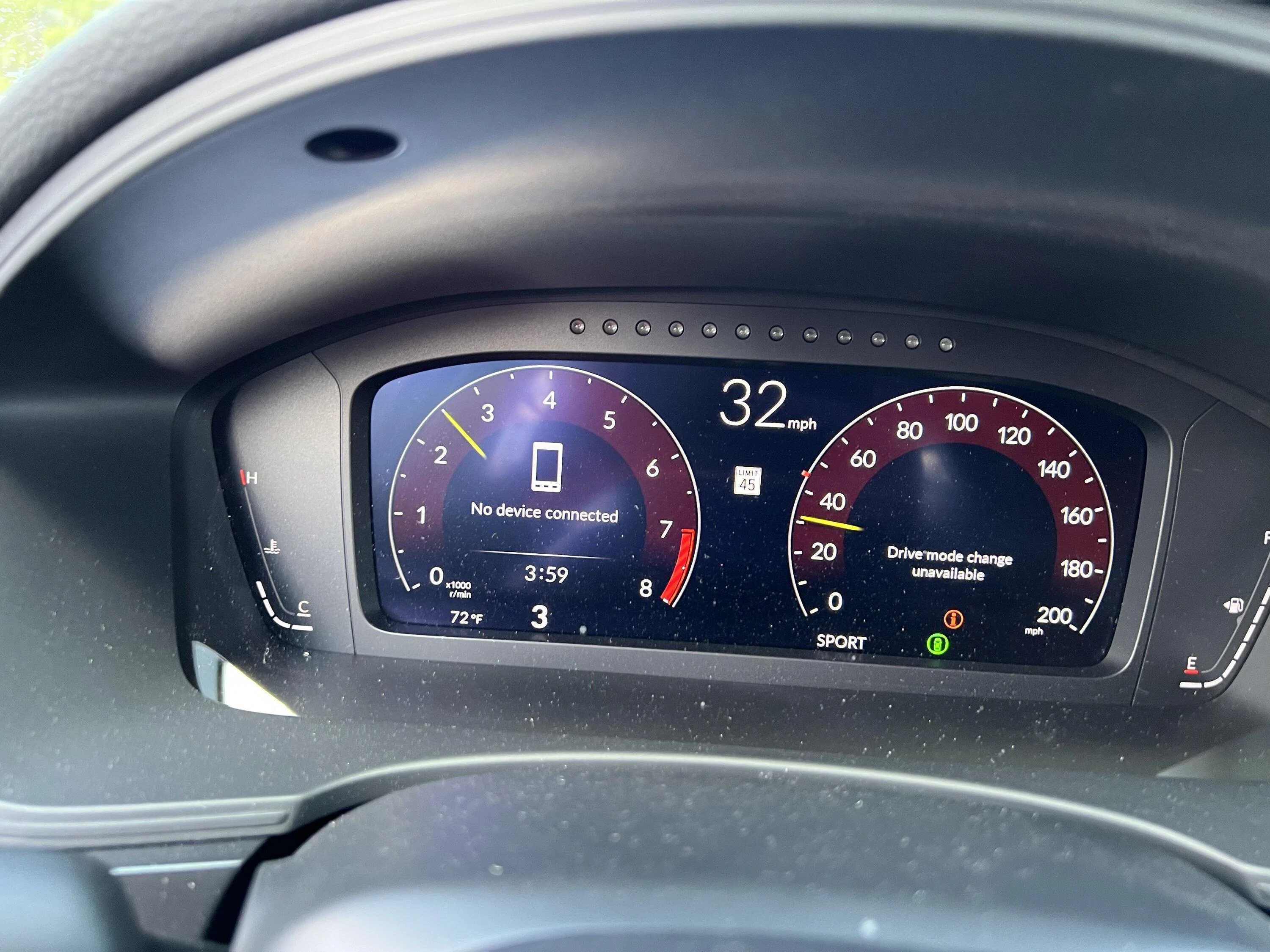

Update: I just tried this and am glad I did. I love the car and don’t mind the ride stiffness at all even in R mode. The issue for me is the way the front end hops/bounces so strongly I can’t see how it passed testing at Honda. Just terrible. (Reducing VSA reduces ~35% IMHO—could be placebo effect.) Unplugging the active dampers solved the problem. Awesome. However, the car felt ‘floaty.’ As someone else said, once it sets in a corner, it just hangs on. In fact, it feels a lot like my 2007 Civic Si sedan (a car whose handling is vastly underrated). That’s the issue though—it feels like a Civic Si. The bounce is gone and it’s still very high performing but it feels like a Civic Si (the new one) rather than a Type R. Obviously, that’s subjective. I dunno. The bounce was gone but so was the car’s ‘edge.’ Further, in my car anyway, once unplugged, all other drive modes were inaccessible. Nothing else was adjustable. See pic. Bottom line, I loved that I’ve now found the problem that causes the ‘bounce’ but I’ve got to find a different way to solve it. I wish it was something Honda could fix with an update somehow. I’d pay $500+ for some kind of ‘EMS’ for the suspension to tune this kind of thing out while retaining stock suspension. But without that, it seems like I’ll need to buy coilovers.

I believe the pedal dance works with individual mode as well. So you can still have the comfort dampers without the nannies kicking in early. It's kind of a hassle to activate each time, but the FL5 makes you come to a complete stop before doing the "long-press TCS off" anyway... Just realize the pedal dance is truly 'full-off,' so drive within your limits on the street.
