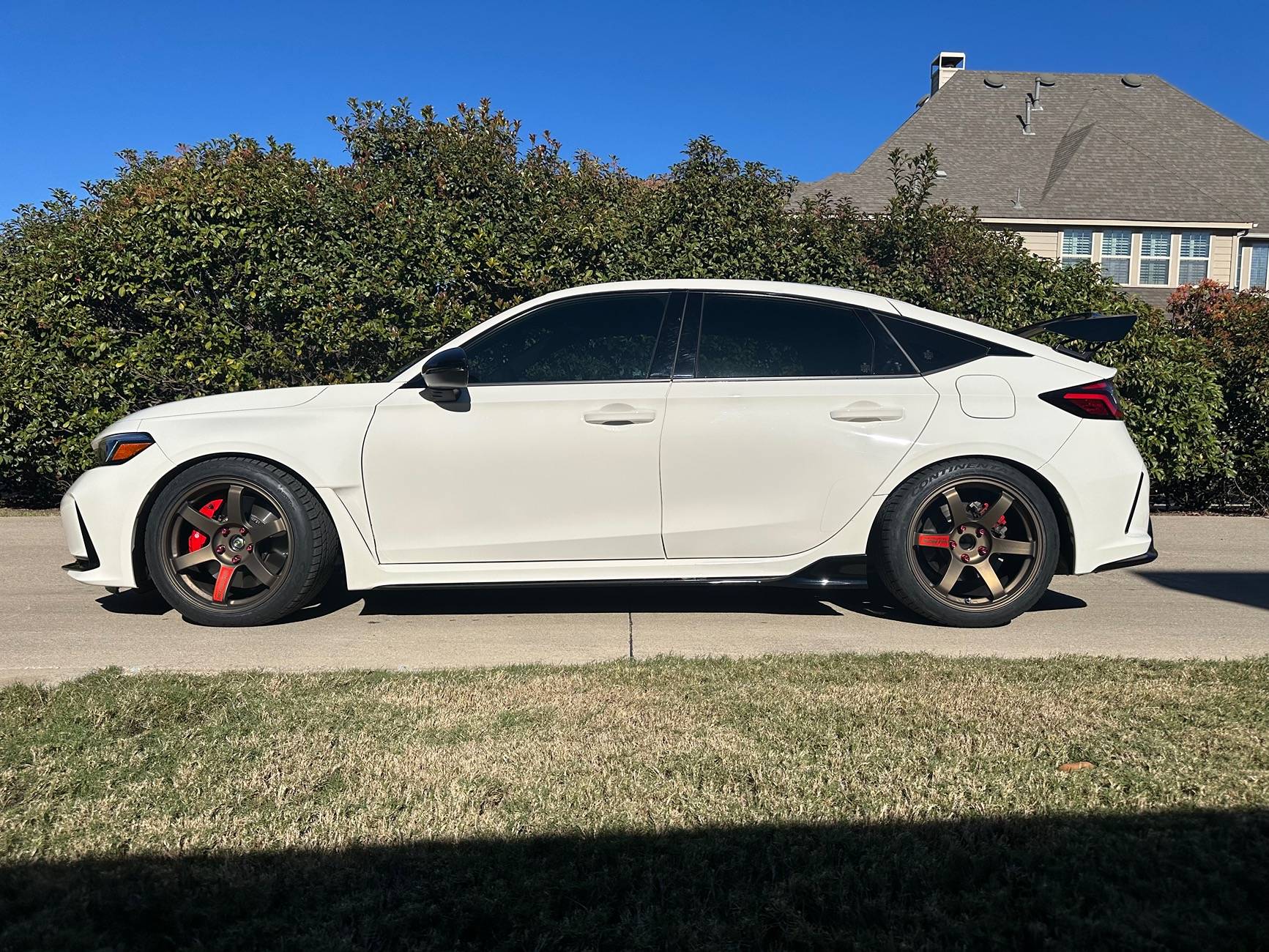

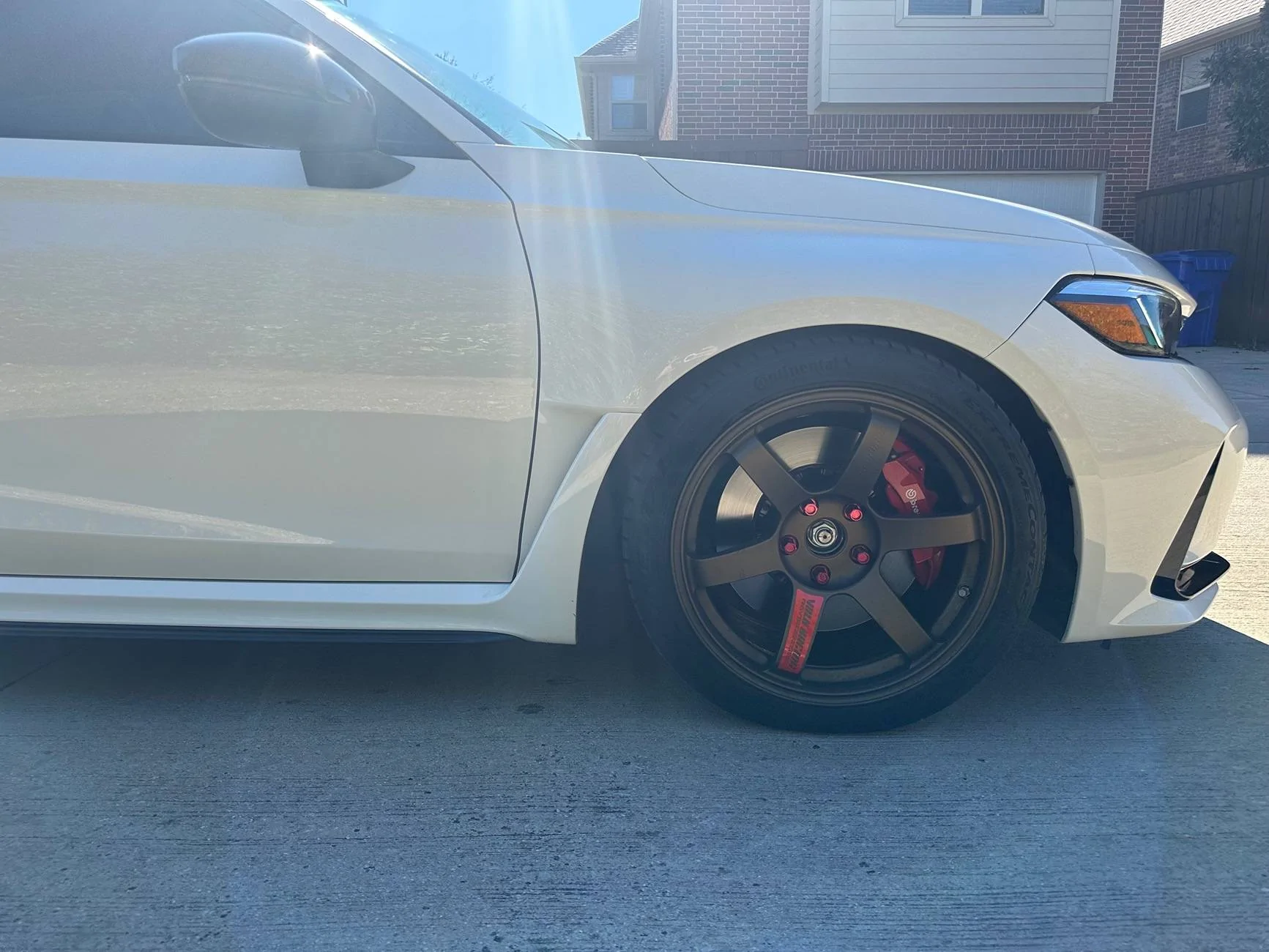

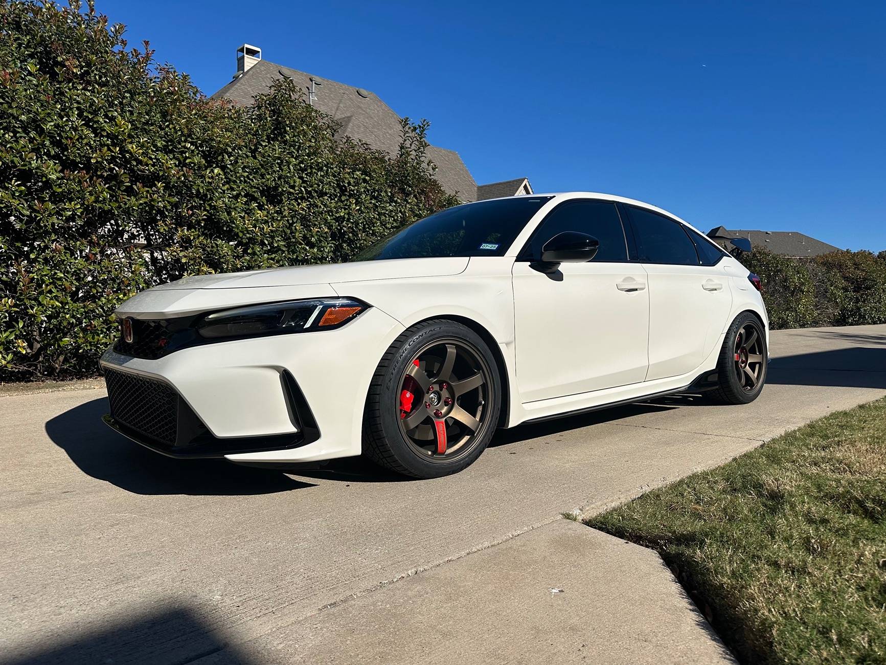

Nattypiso indeed that’s what it was! I connected the wiring harness and got my drive modes back. Also reshaped the brake shroud so no more squealing. Thank you sir!!!
as promised here are the pics!
