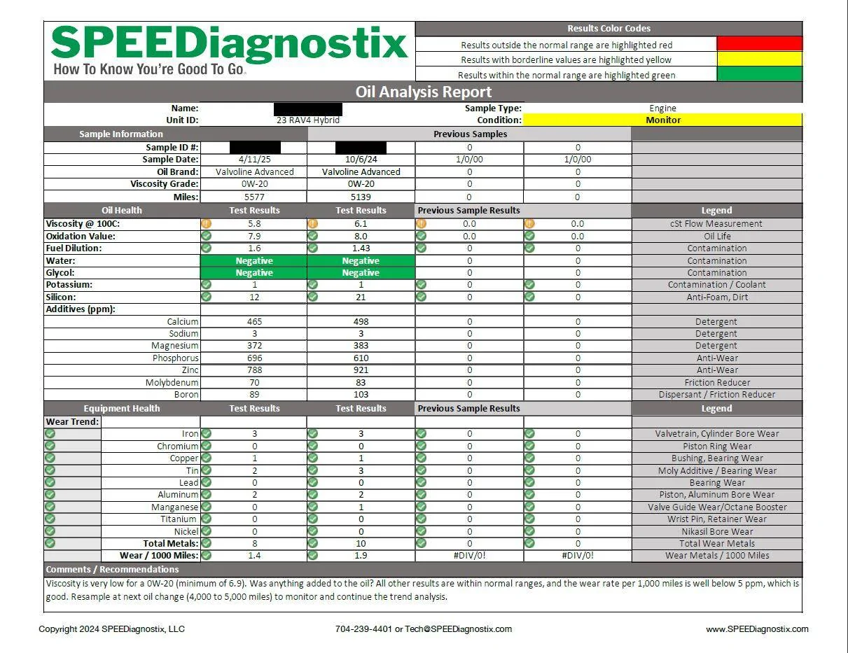

I think Valvoline Advanced is pretty excellent too if you're not planning on doing long OCIs (not saying it can't, but they have others for that purpose) and your engine is still fairly new. I really like the extended protection and max life products, but they're formulated more for long OCIs and older engines that may benefit from seal swelling agents and whatnot.
I've debated running restore and protect as well, just because I'm impressed by their commitment to improving their oils, and that one clearly has some interesting tech.
Not a K20C UOA and I screwed up the input information for the oil twice due to a mixup, but these results are for 0W-16 Valvoline Advanced in a RAV4 Hybrid in my family fleet. The viscosity is still a bit low for 16 grade so I'm now running 0W-20 in them to see how that does, but the wear rate is still excellent. I may have to try some Valvoline in my DE5 just because.
FWIW The Extended protection Valvoline is only $1 more for a 5 qt jug at my local Walmart over Valvoline advanced protection. The single quart bottles are the same cost too. I personally have used Valvoline simply because their HQ is in my hometown, and they sponsor grassroots motorsports activities. It is nice knowing they're actually one of the better choices.

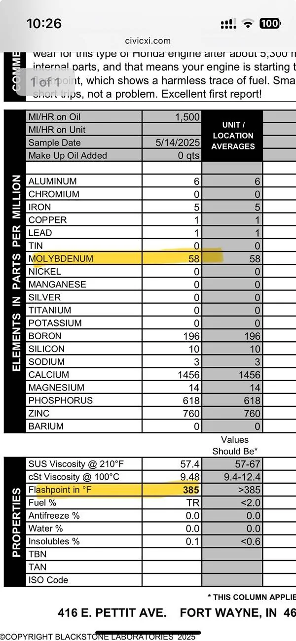

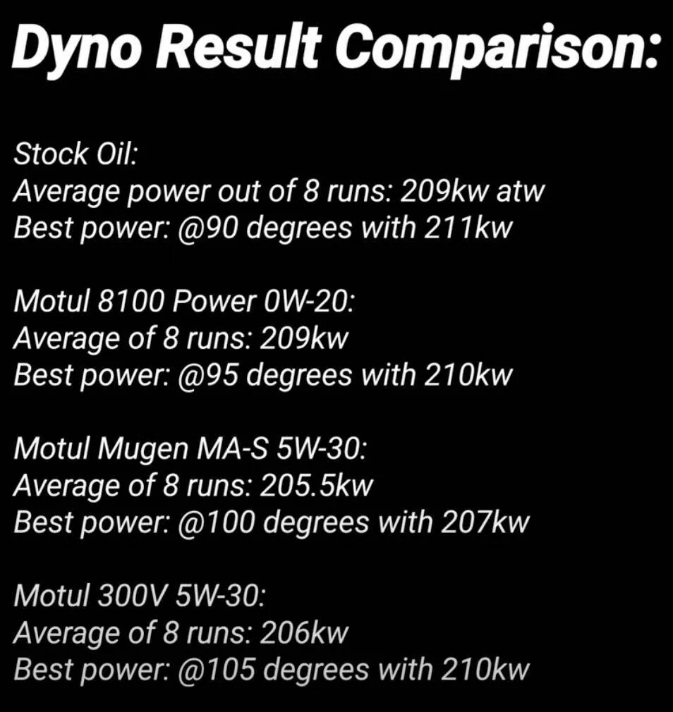

Here is someone else that methodically does engine oil analysis and he went down from a thicker oil and slightly above the manufacturer requirements. OEM spec was a 0W-20 he tried all the way up to a 5w40, but realized he's not improving performance or protection and he tracks and modifies his car. Your engine will run hotter with thicker oil, take longer to get to operating temperature, and you're loosing ~5-6 hp with a 5w30 ( proven by Motul dealer - you're adding friction is my understanding ) and up to ~9-10hp with a 5w-40 on the FL5 Type R -- This gentleman's data pointed him to a perfect balance with a 0w-30 from his lab findings. You want instant protection cold or hot, and you also want to get to optimal operating temperature as fast as possible. He dispels a lot of the conspiracy non scientific theories regarding, just blindly run a thicker oil.
Worth watching the whole thing. From his data looks inline with some other data we've received, and engineering explained -- I'm leaning towards a 0W-30 engine oil maybe also. Engineering explained, that's important not to change the first number 0W but it's safer to go up on the second number due to the same reasons. Get the oil flowing fast, as cold engine starts are where most of the wear can occur.
These new engines have very tight tolerances, and it seems you want to get that oil circulating instantly and you want to get it up to temperature very fast.
The Pennzoil Ultra Platinum 0w-20 are thicker ( 8.8CST at 100c ) than my Honda oil ( 7.99 CST at 100c ) as a base line and the Valvoline Ultra Max life 0W-20 is also thicker at ( 8.7cst at 100c ) based on the virgin oil samples. From that data above that Valvoline seemed to really do extremely well over long extended drain intervals. There are also two people in the community here that have run 2 Motul API SP oils and they seem to do incredibly well with shear resistance.
So far the best we've seen in sheer strength were from the Motul 8100 line. One was Motul Eco Clean and the other was the Power 8100 5w30, and Eric who tracks his car very hard at Laguna Seca with twin oil coolers.
It seems Motul's 8100 line API SP engine oils seem to be the most shear resistant so far from the data I'm seeing.
11th Gen Honda Civic 🔴💊 Engine Oil Red Pill Thread: Only Post If You Have UOA - Official Honda Civic Type R K20C1 Engine Oil Analysis Screenshot 2025-05-31 at 3.36.03 PM
After 5000 miles and many track day's, Eric's oil only sheared down to 10.24 CST at 100c from a 10.8 new !
11th Gen Honda Civic 🔴💊 Engine Oil Red Pill Thread: Only Post If You Have UOA - Official Honda Civic Type R K20C1 Engine Oil Analysis 1748695423352-nz
This also matches the findings of the other gentleman -- he found through his engine oil testing of Motul 8100 Eco-Clean 0W20.
So far the Motul 8100 line seems to have the best ability to stay within its Viscosity index for the longest period of time. My understanding is the Motul Power 8100 is the second highest grade motor oil they make which has an Ester Blend. Motul 300V is their highest grade oil, which is a double ester blend, but it seems to shear down fast from some oil samples we saw, as it's designed for single track day use.
Seems like Both Pennzoil Ultra Platinum and Valvoline - are safe off the shelf excellent low cost oils, and seem better initially from the data than the Honda Oil, as you are starting at a thicker viscosity, but at the same time, we were able to prove racing on track on the OEM oil with frequent changes was safe for 3 track days and ~2500 miles. Blackstone said, I could even go 4000 miles, but I would not push that after loosing ~1.5cst.
Ultimately we are on the quest to find the best engine oil for our car with data to back it up ( least wear metals over 2000 miles and lowest oil shearing )

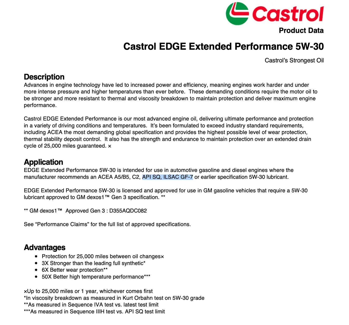

10W-30 — that’s really interesting. I didn’t realize it’s actually listed in the Honda manual for Australia. I assume ambient temps are much hotter there, and once again it seems Honda is drawing the line at 30-weight oil as the upper limit they'd like to see. That also lines up with what Spoon runs in their 25-hour endurance race cars — Ravenol REP Racing oil PAO 5W-30 12.2 CST at 100c upper range.
@Rhorn also makes a great point — it really depends on the oil’s range. With brands like Mobil 1 and Castrol, their 40-weights tend to sit on the thinner side and can shear down to a 30 pretty easily. On the other hand, oils like Motul and Red Line are usually blended toward the thicker end of the 40-weight spectrum — close to the max — and hold their viscosity much better under stress.
I'm especially curious now about the new 2025 API SQ standard that just got released.
I think I might try the new Castrol EDGE Extended Performance 5W-30 with the API SQ rating, just to gather fresh data — unless someone already has some. We’ve already got good data on Pennzoil Ultra Platinum, Motul 300V, the 8100 series, and Valvoline.
From what I understand, API SQ has tightened the standards — especially around staying in-grade for longer durations. This Castrol formulation meets all of Honda’s requirements, supports direct injection, and sits on the thinner side for a 5W-30.

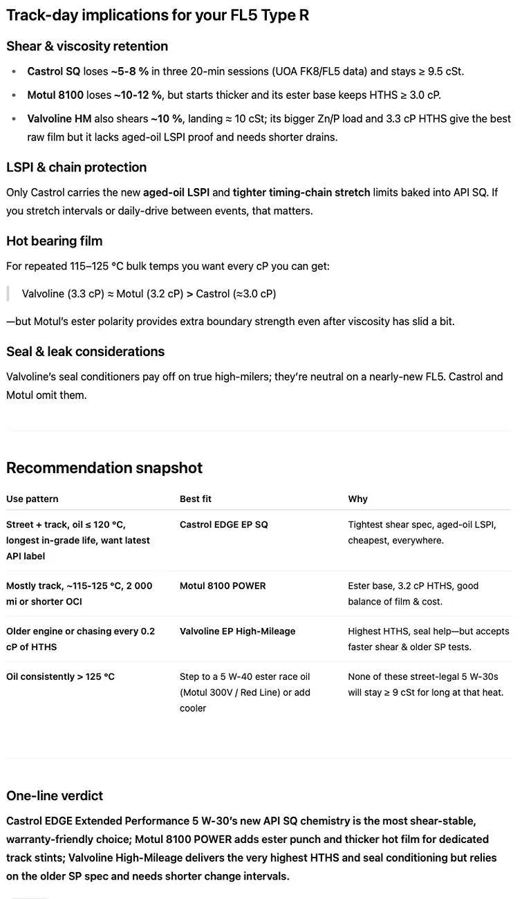

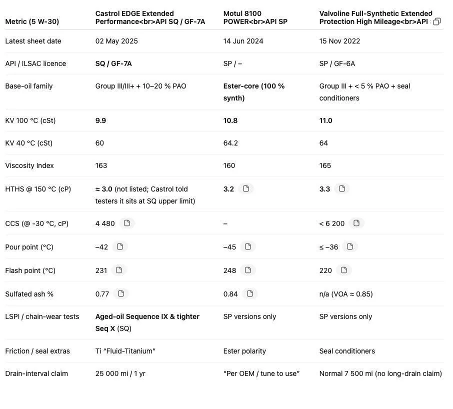

Here’s what I want to test:
  1. Engine noise levels (dB) — comparing 0W-20 vs 5W-30. Does it run quieter, and if so, by how much?
  2. Oil pressure — both at idle and at redline in neutral.
  3. Max engine temps on track — do we see any increase in coolant temps?
  4. Used oil analysis.
We’re about to nerd out on this — fair warning. This definitely won’t be for everyone. Most folks will be totally fine just changing their oil regularly.
Threw the data sheets into AI and this was the comparison - (ai errors possible )
Damn didn't even know SQ oils were out already
