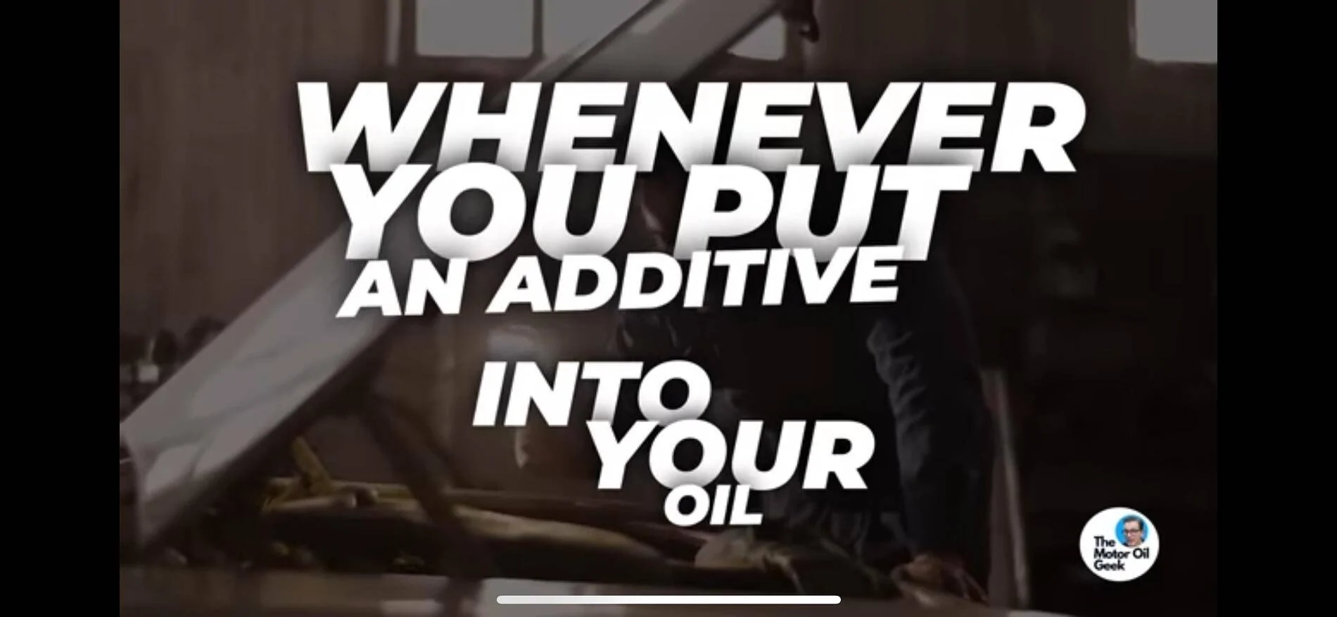

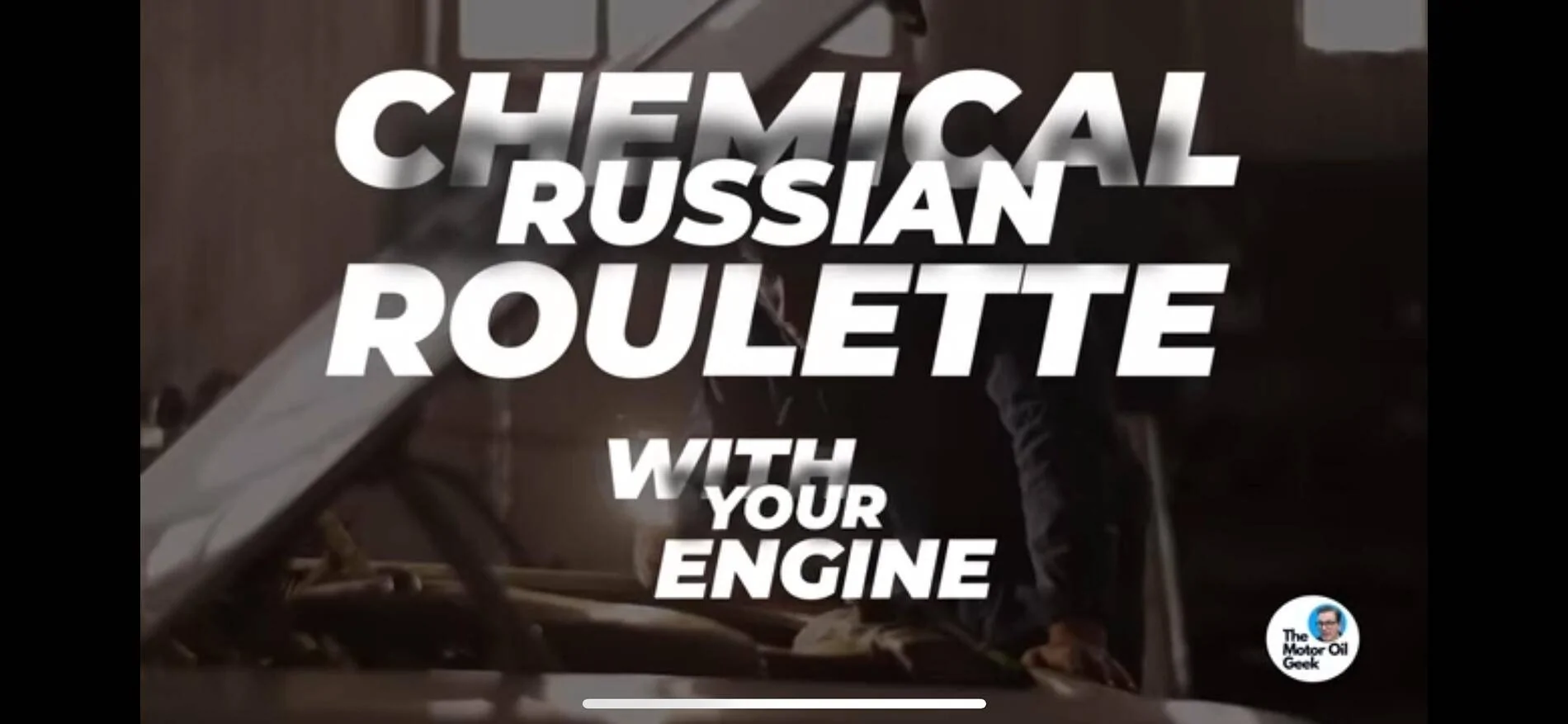

Here is a good video on scientific data driven lab results on additives mixed with PAO base oil. It can go very good or very bad ;) the results above with motul eco clean and that additive look amazing

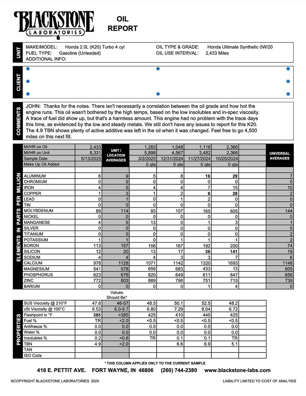

I think I've found the maximum threshold I'm comfortable with for using Honda Ultimate 0W-20 Full Synthetic. It lost approximately 1.4 cSt at 100°C.
This was the longest interval I've run it—about 2,500 miles and three very hard track days. COTA definitely felt harsher on the car, and it was noticeably hotter than my sessions at Laguna Seca in California.
My goal is to reduce aluminum and iron levels, but based on the current analysis, this still looks like an excellent result. Please let me know if you interpret the wear metal values differently.
11th Gen Honda Civic 🔴💊 Engine Oil Red Pill Thread: Only Post If You Have UOA - Official Honda Civic Type R K20C1 Engine Oil Analysis Screenshot 2025-05-27 at 11.00.15 PM
Now that I have a baseline, I’ll most likely try another API SP-certified oil—possibly Pennzoil Ultra Platinum. Motul 300V tends to shift viscosity grades rather quickly, which might not be ideal for my use case. I prefer to change the oil every 2,000 miles or after 2–3 track days.
A friend of mine ran Motul Power 5W-30 API SP under extremely aggressive conditions—daily driving plus track use—and still got excellent results with a 5,000-mile change interval. That’s another oil I’m considering testing.
Red Line 0W-20 and 0W-30 could also be interesting experiments. From what I’ve seen, these appear to be formulated to meet or exceed API SP standards. However, Red Line's current 5W-30 formula is not API SP certified. It has a lot higher calcium values, which could potentially get close to LSPI. I spoke to Red Line, and they mentioned they might update the 5W-30 formulation in the near future.
Red Line could be a strong alternative to Motul 300V—especially if it doesn’t require draining after every race day.

i wouldn't even be considering 0w20 for the track. you should try a 5w-30 or 10w-30. i know this is not scientific, but my engine normally sounds very smooth but after 5-6 hours of driving and doing a pull...it sounds pretty rough. i imagine the oil gets pretty hot and has thinned out. going to switch from 0w-20 to 5w-30 next time and see how the car likes it.

I will try it out and measure results. Do you have any used oil analysis from your 5w30 or 10w30?

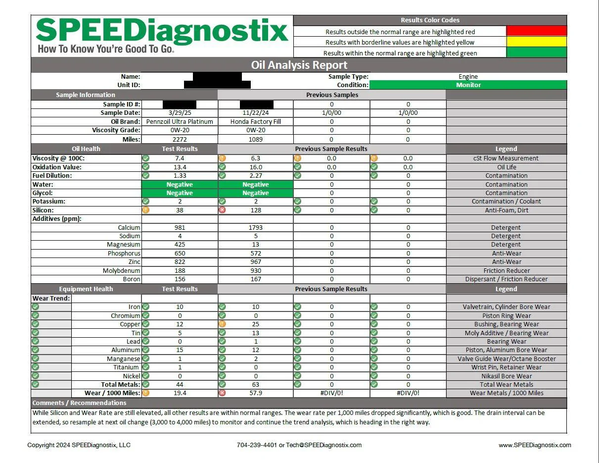

I received my second UOA and I'm happier with the viscosity over a longer interval, so I personally wouldn't use factory fill over PUP 0W-20. It's hard to say much else conclusively since I didn't perform a double flush, the intervals are short, and the engine was still brand new. It is interesting that the fuel dilution is quite a bit lower despite the same usage, though maybe that was just from very early mileage when the ring seal was poor. Running PUP 5W-30 now.
Also, if we're talking about wear metal concentrations, I think we should really be normalizing values to the mileage on the oil change. 5ppm aluminum in 1,283 miles (@johnloov) is more wear than (@UCF120) 9ppm aluminum over 3,000 miles. Obviously, there could be good reasons why one sample is higher than another, like your car seeing a few track days versus street driving or something, but just comparing the raw numbers without context is kinda pointless. Let's do wear metals per 1,000 miles since the math is simple. I would argue in general that you should just add up your wear metals and divide them by the number of miles. 16ppm/3k miles = 5.33ppm per 1000 miles. From there, I think it's helpful to look at how different oils may provide better wear protection for something like the block, but perhaps not for the valvetrain, as that can often be a trade-off.
Since we likely have a lot of folks who will browse threads like this throughout time, some experienced and some not, it's more useful to do it that way instead of simply comparing the magnitude.

Excellent data, I was also looking at this exact oil. For sure track driving is much more abuse and Pennzoil ultra platinum 0w-20 is one of the few engine oils at the highest thickness api sp at 8.8cst for a 0w20 in the virgin oil sample. Looks like it lost 1.4cst over 2200 miles. Thank you for providing this data- it’s excellent.
