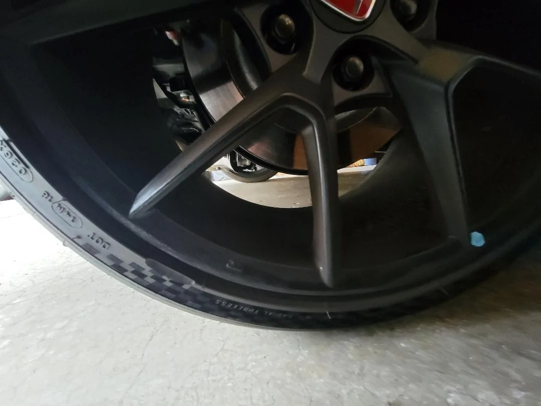

i had tried it once on a different car and found it hard to use normal sandpaper without scuffing up the surrounding area. where did you find fk8 touch up paint?
I did it too -- actually zapped the tire edge as well :oops:
but, i went to a repair guy who was recommended to me and he wasn't that helpful -- said he couldn't do it better than i would be able to -- that i should be able to easily do it myself. He warned that it would take a long time to get through the metal.
So, when i did the sandpaper thing, on the larger gouge, i ended up doing exactly what you did -- i scuffed a much larger area *ugh!* What i found was that these wheels are really soft aluminum -- i had posted about this earlier that i ended up going much deeper as well, since i had given it more muscle than needed. And, i had to use normal or fine sandpaper with either a careful fold or wrap it onto a small rod and work it carefully. That worked much better on the smaller gouge.
As to color... i was told by 2 different people to just use black -- but to make sure it was ZINC-based so it would adhere to the metal better... so that's what i did. I got one of the canister applicators at a auto shop that had a brush applicator. it did work out.
Once i realized how soft the wheel metal was, it didn't take that long... maybe 10-15 min of being REALLY careful not to trash the area around it.
However, If i ever do it again, tho... i'm thinking i may just try the sharpie thing before going through all that :p
Here's what it looks like -- this is the part i did properly... the other part isn't as pretty...
