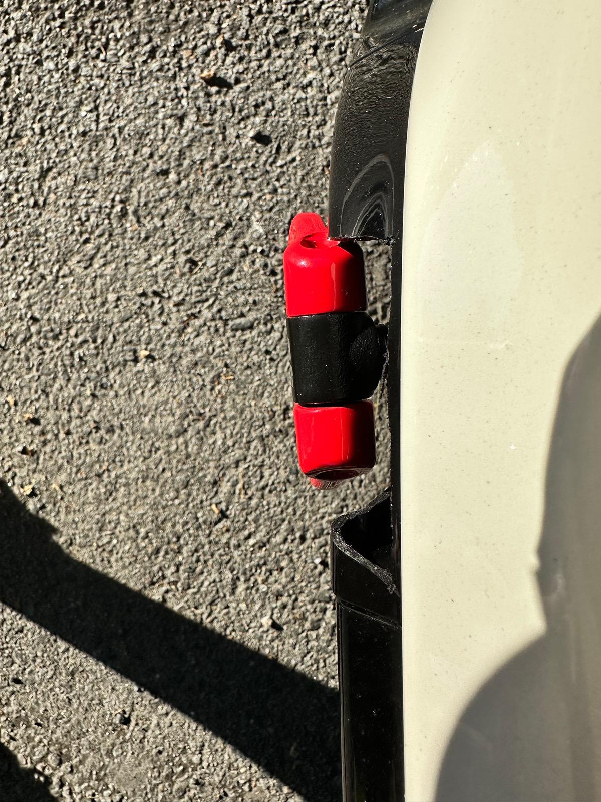

I used one that looks like a Y do it came off rather easily.
I attempted to make cuts on a new cover but when I went to the one I did yesterday to see where I can make smaller cuts I just don’t see much other than the top where I could have not cut as high to show the white panel. Otherwise, there’s not much to “cut less”. I actually need to cut a little more on the left.
The lower portion is where the wrench would go to tighten and the top needs clearance so the tow hook can rotate the thread into the stem.
hmmm, so the hook does not fully stay outside the plastic piece? I was hoping to drill a perfect circle and then have the shaft of the hook go in but I guess the hook sits way too in for that.
Could you take a pic from top down? pleaseee :D
Looks good ! ??

so the hoo
It’s not long enough. The tow hook comes in two pieces. There is the stem that is male on one end and female on the other with a locking hex washer. It threads into the tow hole but it’s not long enough to make it past the bumper cover. The tow hook has a male end with a movable hex washer. It threads into the first piece and even if you don’t thread it all the way it barely makes it past the bumper cover. You can see it in the picture. I wanted to thread as much as possible.
11th Gen Honda Civic What did you do to your FL5 today? IMG_1932
I’m sure someone on the forum did a much better job than me cutting. And might correct me.
MooMoo
Apr 6, 2024
1,244
1,237
yeah from the top can really see how much it sticks in. Makes it much hard to get this to look clean because have to take a big chunk out of it.
TW00Si
Before I tried installing it, I drilled a big enough hole for it. But once I tried to put the second piece on, it couldn’t even reach. That’s when I realized, I needed to cut. And I made multiple cuts because I didn’t want to cut too much.
Maybe tomorrow I’ll email Evasive and give them the feedback to make the stem longer.
What I can also try out next time is to see if my EVS tow hook on my S2000 threads into the FL5. Visually it seems longer and might allow me to just drill a big round hole.
MooMoo
Apr 6, 2024
1,244
1,237
for sure, a little longer would be nice. Maybe a good business for someone to sell a longer hook with a cover that has a hole perfectly but into it.
