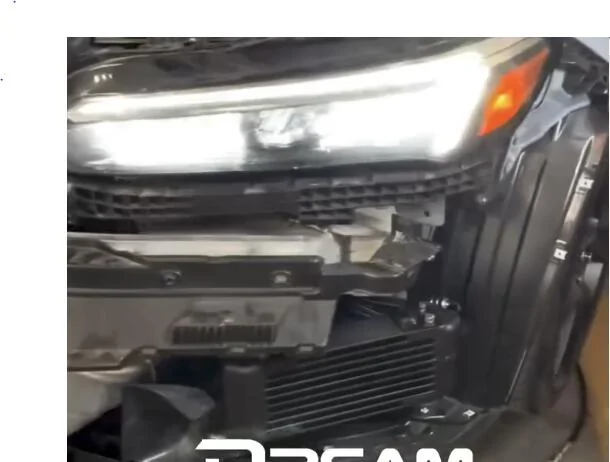

CSF Dual oil Cooler kit coming out. you do cut the bumper though. doesn't looks terrible at least in the video.
The dual drops oil pressure. I'm waiting to see what Wunderland racing does.

the VWs stock have oil coolers in these locations (L/R). would like to see how it works out
Looks very functional. Position is good and gets proper ducting. Looks very ugly though ?
