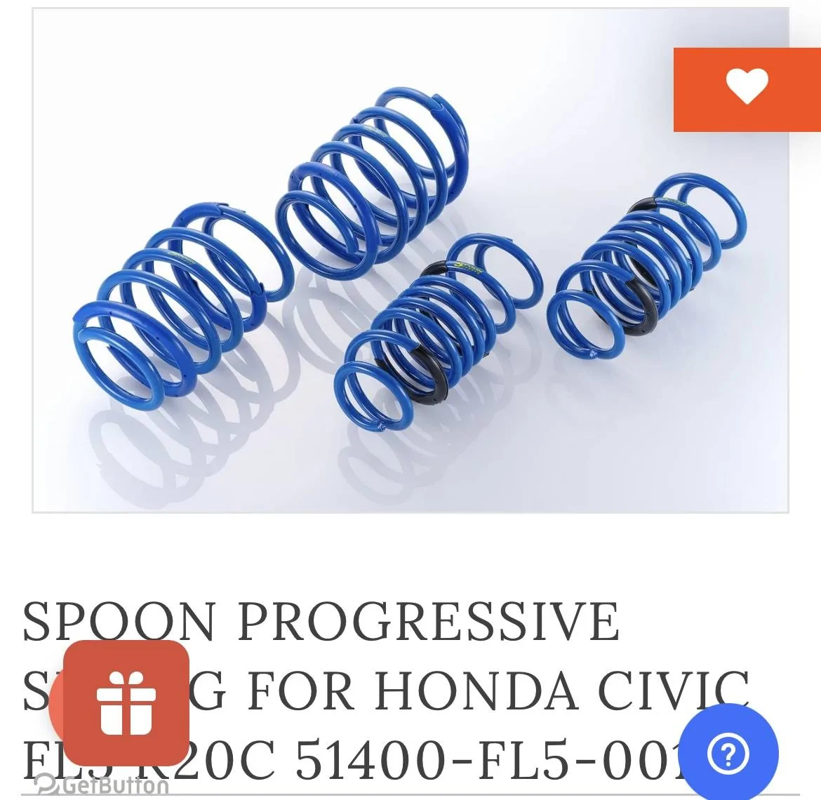

Hello! These still look slightly lower in the back (I know it’s the fender height and not the springs themselves). Or is that just me? Are the new springs the ones I have attached a photo of below?
11th Gen Honda Civic Spoon Sports Springs Installed on FL5 w/ 25mm R + 20mm F Spacers IMG_0979
This is a general picture, and since those have blue insulators, they would be old. Stock pictures frequently do not get updated. The concrete up to the fender dimensions I have listed above in an earlier post.

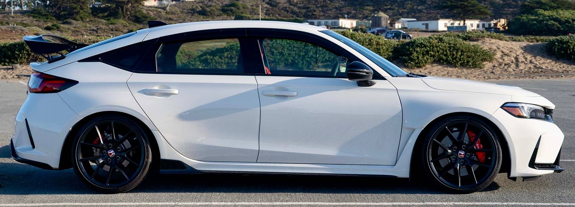

Stock:
11th Gen Honda Civic Spoon Sports Springs Installed on FL5 w/ 25mm R + 20mm F Spacers 1731390236290-0

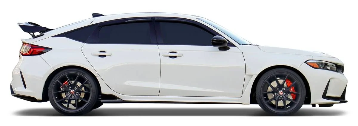

Pro-Kit:
11th Gen Honda Civic Spoon Sports Springs Installed on FL5 w/ 25mm R + 20mm F Spacers 1731390299958-0

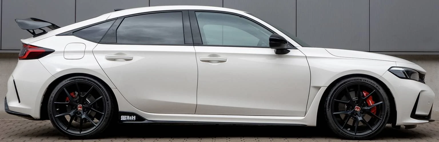

H&R (mirrored image to make compare easier):
11th Gen Honda Civic Spoon Sports Springs Installed on FL5 w/ 25mm R + 20mm F Spacers 1731390372180-ua

Yeah looking at the above comparison I am def leaning towards the H&R's as the drop (.75) coupled with a 1/2 " taller 35 profile will give me 1.25" drop in the front and 1.1 " in the rear without sacrificing ride quality. Heard the H&R's are slightly better than stock while keeping the same stock driving dynamics. The Swifts and Eibach's are not for me as it appears to low and would most likely kill the driving experience. Besides blowing out the stock shocks early, I could def see these causing major butt clenching over uneven pavement. I know some like the slammed look but I just don't think it does anything to improve the cars performance (although it does "look" good). Also the Swifts look tucked and I heard they are quite stiff. Unless you are running an 18x9.5 /18x10 w/38-40 offset wheel it loses the wide body look which to me defeats the purpose of lowering it in the first place. Either way for my specific application I want to maintain as much of the stock ride quality but with a little less wheel gap so I can aesthetically gain the most from the wide body design. I am going with 20/25 H&R spacers because I love the stock wheels and cant justify dropping 4k on wheels just yet. Don't get me wrong, there are some great looking builds out there that I lust over but the majority of those cars would be a nightmare to drive on normal roads. I want to drive this car the way it was supposed to be driven and not lose the actual Honda engineering that went into in the first place. Kudo's to the builders of some amazing FL5's but going overboard and losing out on all that engineering is just not for me. Def appreciate everyone's input and FB on these threads. Cheers- Guy
