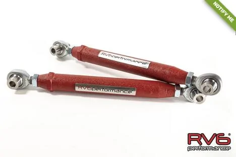

I ended up getting the RV6 camber arm and call it a day, much easier to install and configure too.
azev
Feb 18, 2024
42
Oregon
CW FL5 CTR
Is that the whole lower arm?
RV6 called the part Lower A Control Arm, it replaces the Arm in front of the spring perch and you can adjust camber by extending or retracting the arm.
BigBird
May 29, 2023
1,073
828
is that the straight one? but you would still have to get the bolt out, which no matter the arm would be an issue if it was the wrong size.

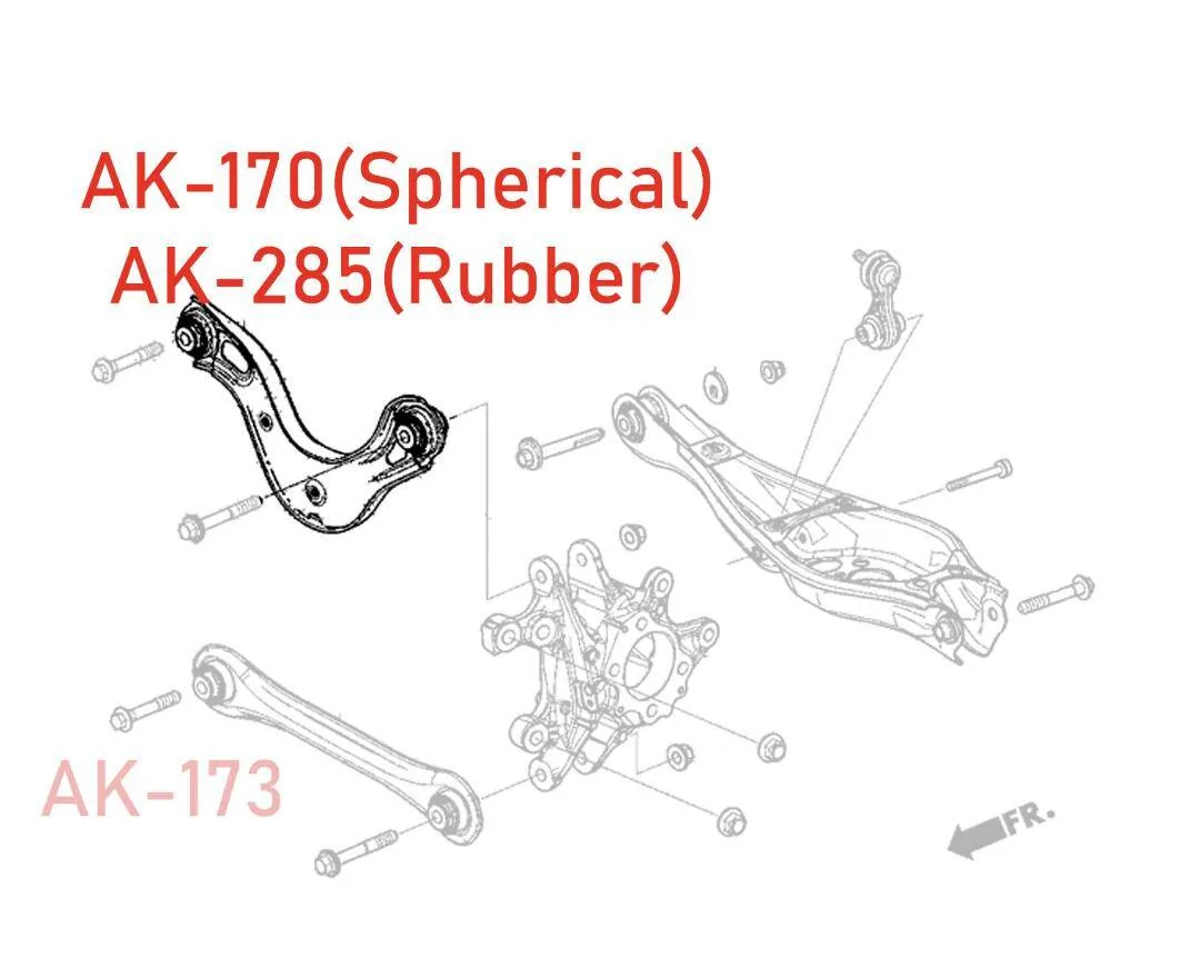

This is a completely different component than the SPC, this one is the lower A arm, it is located right below the arm that SPC replaces. See this pics below, the spc is the AK-170 or AK-285 parts and the RV6 is the AK-173. It is all below the subframe and knucle, with full access to all the bolts, very easy to swap, and does the same thing (adjust camber).
very good to know. HPD uses the SPC one rather than the RV6, even though it uses RV6 for the other components, so I said if they use it over RV6, should be a reason.
I'm a masochist, so I may still give the SPC a try in the future, but this is good to know as another option.
Thanks!

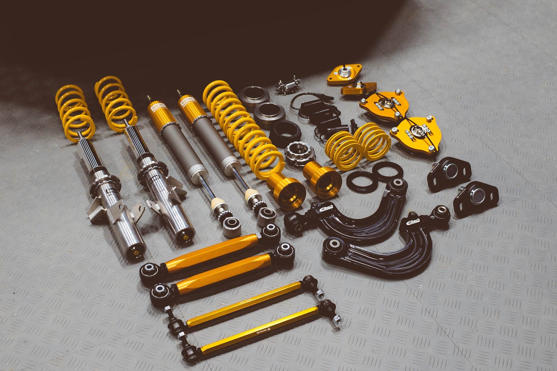

I'm debating going this route instead of the SPC/Eibach upper camber arm, but I hear these arms are really for Toe adjustment vs camber , did you have any issues getting it aligned and asking the person for more negative camber in the rear ? Did you also do the lower RV6 arm?
Thanks
The upper SPC/Eibach arm is for camber, and the lower arm (not control arm bucket - the one to the left of the eibach arms in this pic) is for toe. But in reality, everything is connected - you adjust camber or toe and one follows suit. Although yes technically you can adjust camber here too, but again, will affect toe values, so its mainly for toe depending on how much you need/want to adjust.
