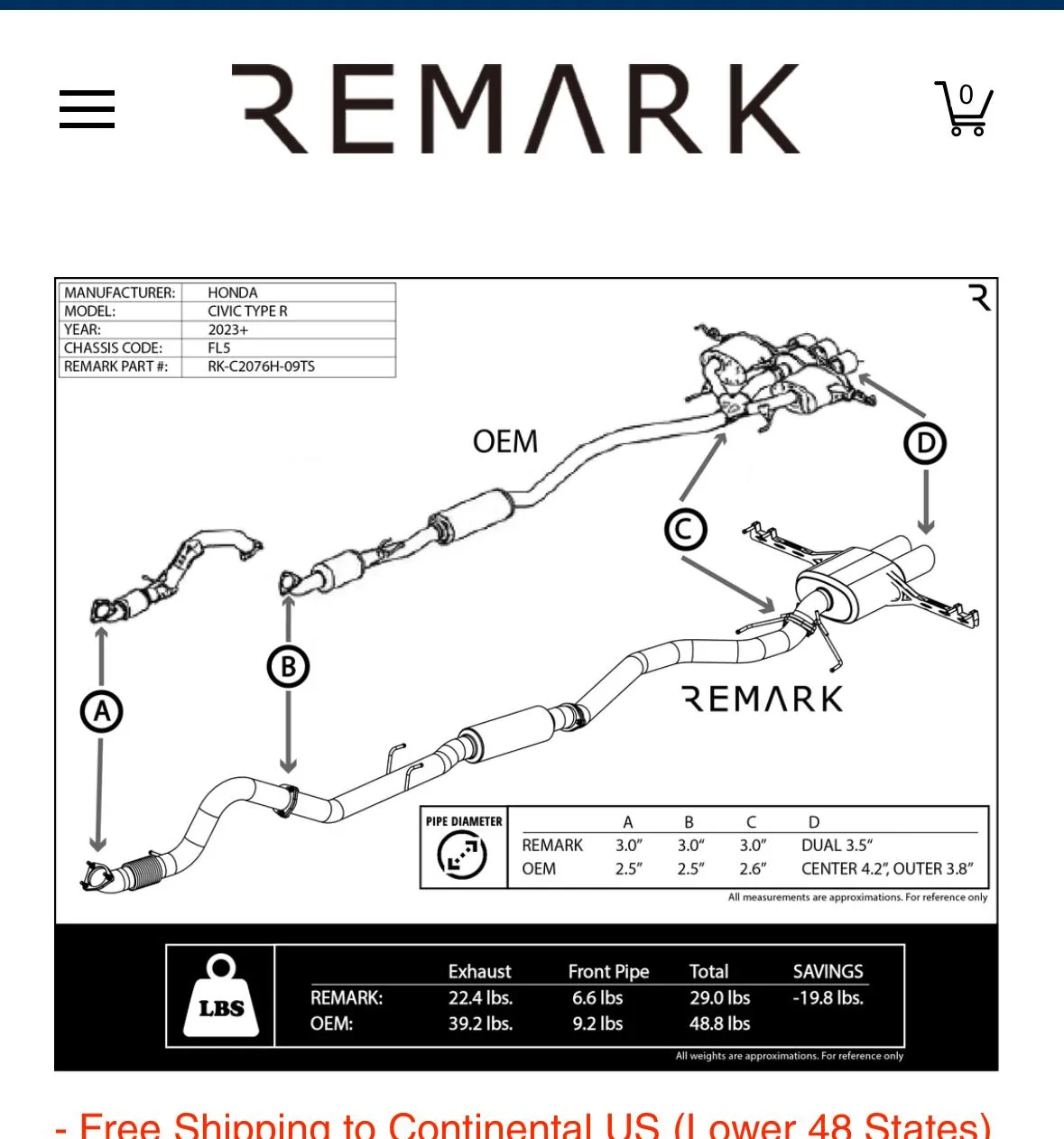

It's actually just under 20 lbs. and even less with the stainless front pipe Remark is using due to the Ti front pipe failures. In reality it's likely ~16 lbs. in weight savings all told.
TylerTypeR
Tyler
Jun 6, 2019
44
Canton, Michigan
2019 Civic Type R
And according to Remark the stainless is already 6 pounds lighter than stock. So the weight loss is a tough sell for $1300 more than the stainless. It does look cool though.
julianobl
Aug 6, 2022
70
86
?? Puerto Rico
2023 FL5 - Sonic Grey
It is 19.8 lbs lighter with the SS front pipe
It was 23-24lbs lighter with the Ti front pipe.
