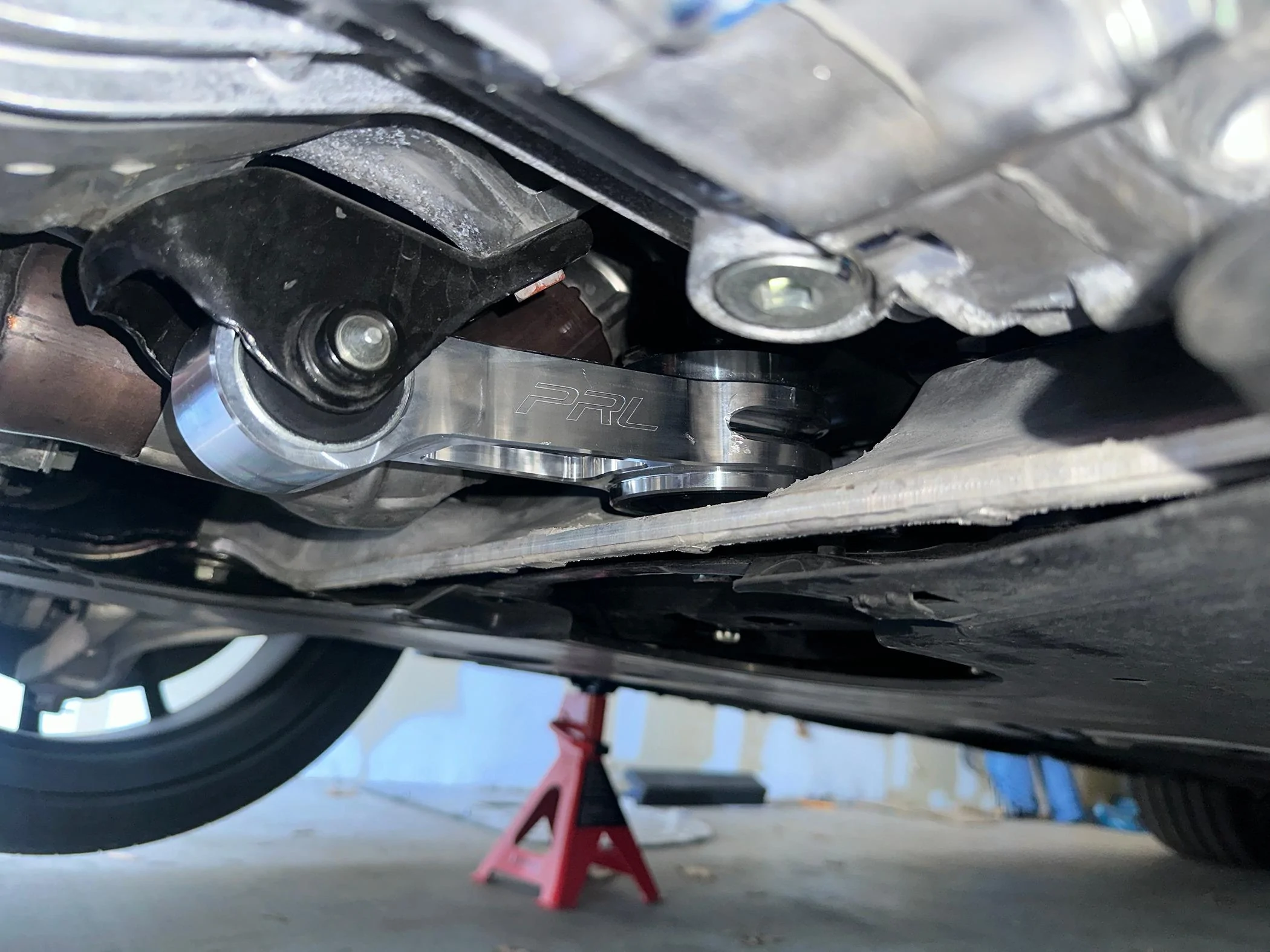

Currently trying to install the PRL rmm, running into an issue ? I got the horizontal bolt in but the vertical bolt doesn't seem to line up with the hole in the rmm. I'm pretty sure I got the right part prl-hc11-rmm. Does the orientation of the rmm matter for the PRL rmm? Maybe I put it in upside down?
Looks to be upside down. This is how mine sits.

I got it out and tried again w the mount right side up.....still not aligned. Jacked up the engine a bit and still had trouble. Might end up sitting on it for a while

I'd recommend trying a drift through the hole to help align it. Something shifted for sure.
I can align it with a screwdriver but the motor shifts back every time, it may be because the car isn't level, I may see what I can do to get it the car level or get a tapered drift pin to get the vertical bolt in
Pry bar between the diff and subframe to push the engine forward enough to get the threads started?

Yeah that might be the way, one of the installation videos I saw they did something similar. Currently don't have the PRL rmm in because it's a huge pain to remove so debating if I want to try with it again

That's what I've been trying to part of last night, it definitely seems like the motor has shifted back a bit misaligning the vertical bolt holes. It's also actually a bit harder for some reason to just get the horizontal bolt in for the OEM vs the PRL

you are trying to install it upside down.
put the chassis side vertical bolt in 1st. didn't even have to jack up engine doing it that way.
if it's still not lining up get a jack with a wooden block and lift on the oil pan. just be gentle.

Yeah I accidentally tried to install it upside down the first time. I tried doing it right-side up last night and was running into the same issue. Might be able to try again with prying from the diff or transmission to shift the engine forward enough but it's pretty hard so far with only the front raised, might need to find a way to get the rear up safely

i also had the transmission in reverse so the car wouldn't roll back. not sure if that helped line it up or not. you already have the front on jackstands. you can just jack up on the rear jack point under the rear bumper.

Actually just have it on ramps, turns out my neighbor has the same ramps I do so I should be able to get it fully level
