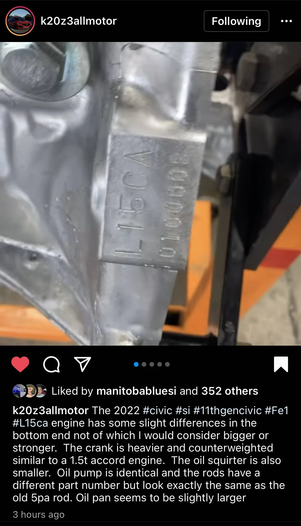

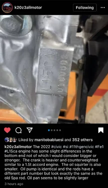

@D-RobIMW any guess on honda changing lower internals and fuel system to something more juicy

So is the Si Turbo different or is it the same as the non Si 1.5T?
Curious what is different on the engine.
