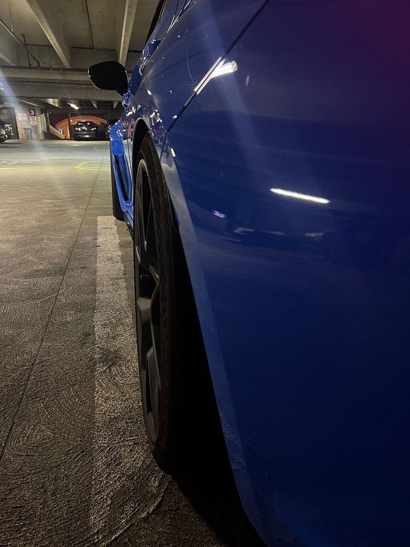

I added 20mm Bonoss spacer. I been running for about 3 months with 6k. I do put antiseize on the hub. I was contemplating +15mm but worried about stud length and not being flush enough. Decent mod for the money if you into a more flush look.

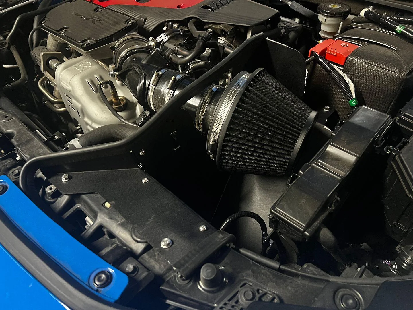

I put in ramair intake and my main objective was to get noise coming from the engine. It did bring noise but more of suction noise and not reminiscent of induction na motor I guess I was expecting to much. I applied some DEI heat shield to help minimize heat soak and was probably useless. If you ask if I would buy it again yes and no due to prl finally release and the material less prone to getting heat. It definitely remind me of older style intake instead of those newer intake with molded plastic.

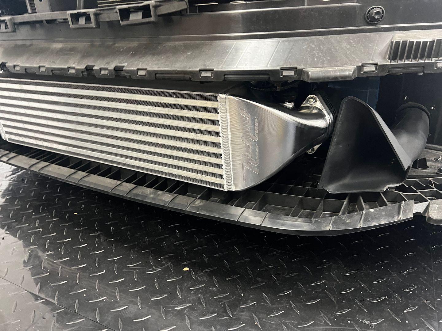

Added the prl intercooler just because. I didn’t find any bogging with the car on a hot days but I got anyways. Building it similar to my 10th gen si. The quality of the part look great and didn’t really have any complaints except for the price. The mod felt more like a piece of mind type of thing not really hp gainer for my case.

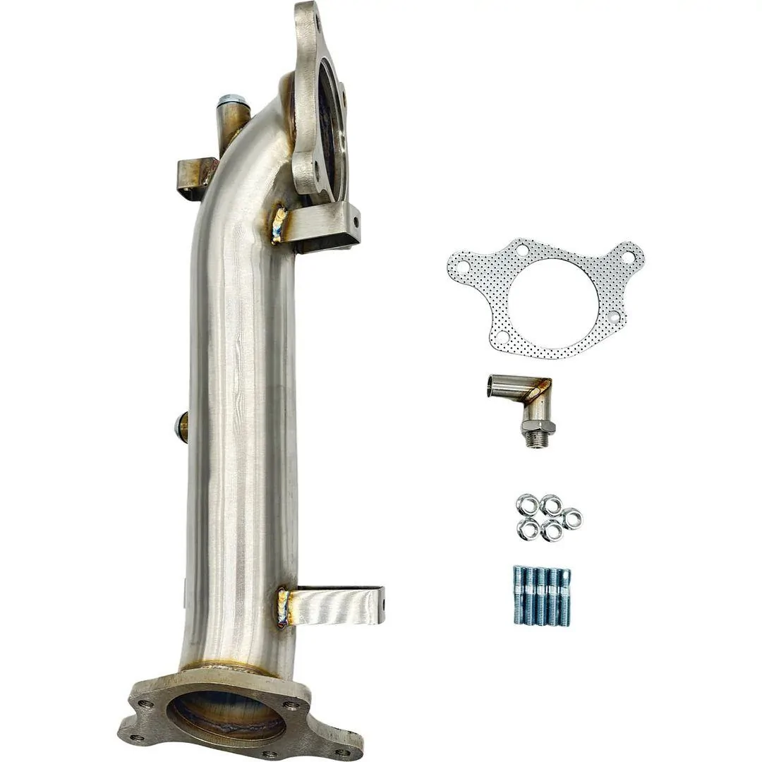

I got my ballad downpipe. I didn’t want to pay a crazy price considering it basically a pipe with two bends. I am really happy I bought this considering it price to performance. I felt better top end power and the rise of the rpm was faster but loss a little bit of the low rpm. Also was able to put heat shield on. I had a shop do it since I was scared of the bolt breaking. I drove on for about 5k miles and do notice my exhaust has got a lot of brown tarnish but I don’t clean the exhaust. My car itself seem pretty clear.

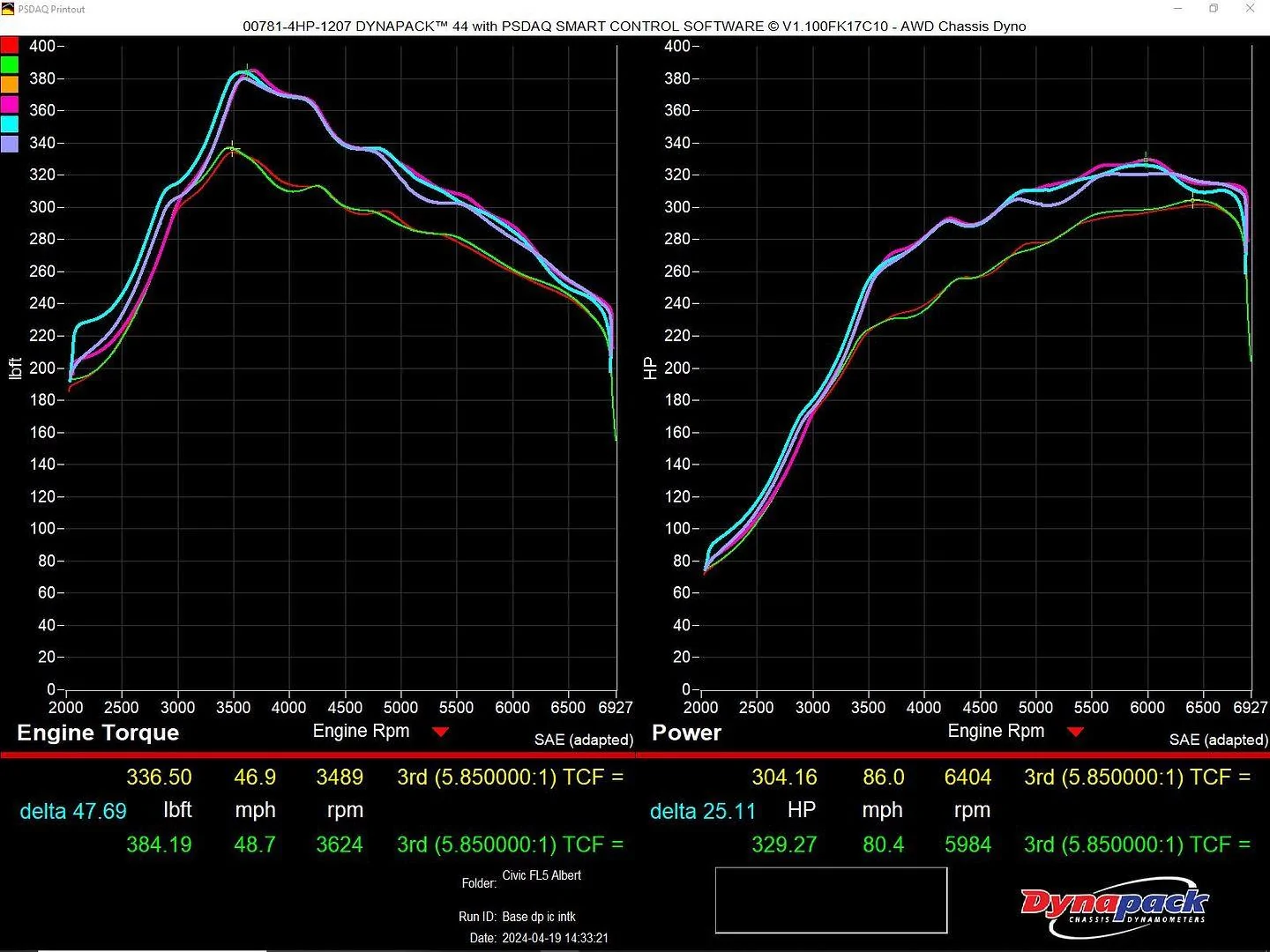

I got my car dyno again with my modifications and was hoping for a little bit more. I am still running hondata basemap with the intake, intercooler, and downpipe map. It made about 300whp and with the current mods it make about 330whp. I might consider getting a custom tune but I am kind of done with the power modifications.
Dyno
Definitely get a custom tune! You’ll probably gain another 30-40hp which would be significant. For how much money you’ve already thrown in, if you want or need the power, it seems like a no brainer considering it only cost $300.
I am debating about tune but I want to run the car how I want without worrying about it. With custom tune if I get bad gas it might not go so well for me.
Dyno
you gained about 30WHP across the entire powerband after 3.5krpms and in some places even 40whp. Looks solid to me.
I was hoping around 350whp but not realstic due to mod just don’t pile on the gains. I am happy enough how my car feel. I will probably be changing tires to help put more power down and chase those certain times.
