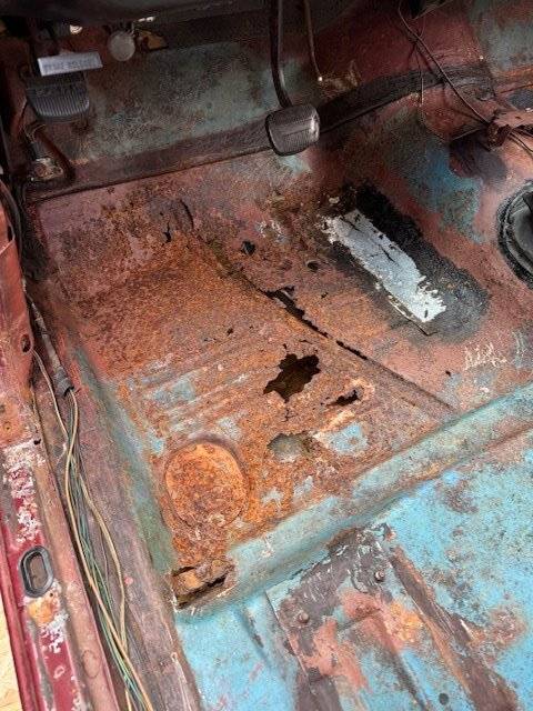

Undercoating is minimally used today as compared to the blanket spraying of the entire undercarriage as used in the past. Undercoating is a headache as you mentioned regarding cracking, moisture retention, and rust damage particularly in older cars.
Case in point is my 1964 Impala SS that has 17k on the odometer and sat outside for decades allowing moisture to rot out the floor pans because of moisture trapped in the undercoating. Interior PIC is a gem considering the age:
11th Gen Honda Civic Paint and sealer peeled off. Bare metal exposed? 1746417673598-rv

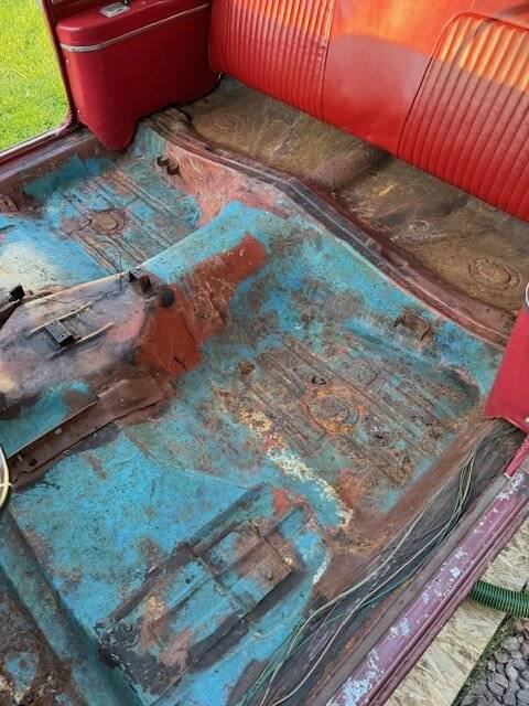

Rip out the interior and the same gem looks a bit different:
11th Gen Honda Civic Paint and sealer peeled off. Bare metal exposed? 1746418013791-z3
11th Gen Honda Civic Paint and sealer peeled off. Bare metal exposed? 1746418067411-44
Project for that car and this year is to replace the entire floor and trunk pans.
Modern undercarriage coatings tend to use a high build epoxy primer followed by urethane instead of simply relying on a rubberized undercoating.
